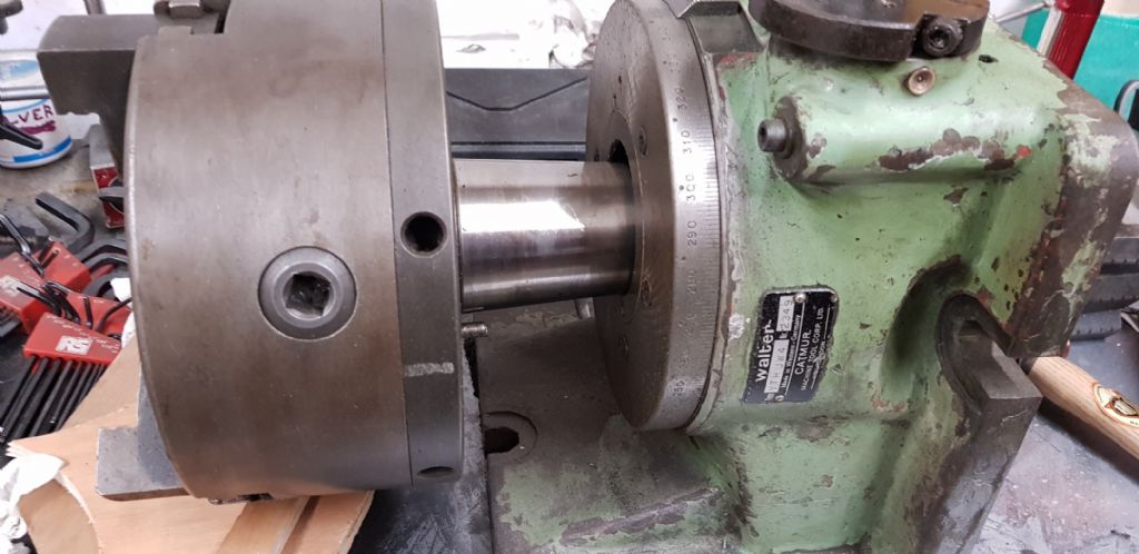

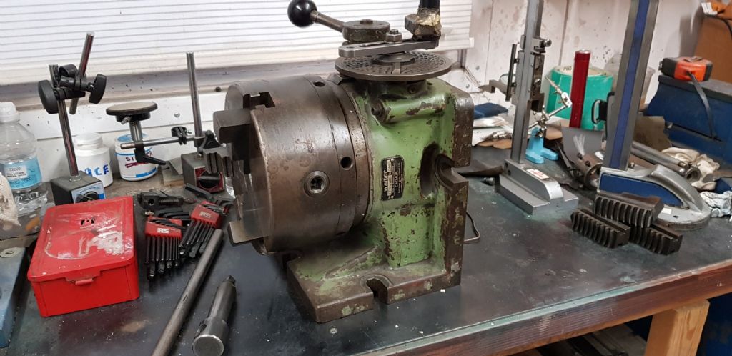

                                I wouldn't care i bought a superb Walter unit with chuck & dividing plate (1 only). The problem was it was way too big for my machine at 8". I could not even carry it on my own. It was bought at a liquidation sale unseen hence too big.
                                Hence the reason for looking at a 6" version.

                                        Posted by not done it yet on 26/12/2020 17:30:17:
                                        I’m surprised that an 8” is far too big – after all once set up, the only usual mill table traverse would be arranged to be in the x axis, and in a circle with the rotary table? Heavy is better, for lots of milling operations.
                                        Old mart is correct. The one i have is very large. Extremely heavy & of a very good make. Shame really but never mind.
                                        Steve.

                                        #515627
                                        Dave Halford
                                          @davehalford22513
                                          That monster would kill your Z drive.
                                          #515681
                                          old mart
                                            @oldmart
                                            Dead right, Dave, Steve's Z drive would go down, but there could be smoke going up. I would estimate that the HV6 type are 1/3 of the weight of the big one. Selling it on ebay should recoupe most of the cost of a 6" one.

                                              #515696
                                              old mart
                                                @oldmart
                                                The only way I could lift that would be with a long bar through the chuck, and a sling at each end, I can't see any threads for a lifting eye.
