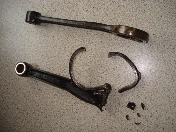

                        I think a final scheme is emerging. Moving up to a 40mm od crank pin and using a stock needle roller bearing get you up to 45mm od. If you then add in a hardened ring in the conrod eye you are looking at boring the conrod something like 0.15″ over the iriginal dimension. At ths size the conrod is looking rather delicate and as this all started with a fork rod failure,,,,,
                        New conrods with a bigger “big end” would be required.
                        Plan B then is to go to a 35mm crank pin allowing me to use 42mm od needle roller bearings which can be accommodated by opening out the existing big end sleeve by only .030 on diameter. I am pretty sure the sleeve is hardened right through so this should be achievable. The od of the sleeve doesn’t change so the original pattern conrods will do. If I stick with the bronze bush in the blade rod then it should be straighforward.

                          Another attempt at the photo….
