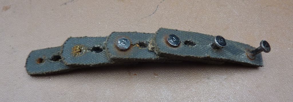

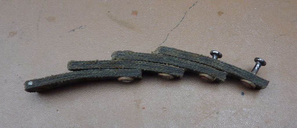

        I've been working on installing a bigger pulley on my Faircut countershaft.
        Now I need to deal with the drive belt. It is a linked Vee belt and I have a spare one that I can take links from.
        So far I have managed to split the spare belt and get 4 links separated but it has been quite a fight.
        I've tried googling but just come up with info on more modern linked belts.
        Does anyone else have this kind of vee belt (pics below) and if so is there a 'knack' to joining and unjoining the links?
        So far the best I have managed is to put the belt in the vice, bend it sideward and upwards (backwards if you like) and then attack it with various sized screwdrivers and scribers to lever the rivets out of the slots.
        It looks like it should work using the bigger hole in the middle fo the slot but the rivets pass through 3 links so it isn't obvious how to get the rivet into this part fo the slot.
        I'm hoping there is an easier way!

                  If you bend them with the outer face on the inside of the bend the rivet is pushed towards the wide part of the slot. Then using your third hand and a screwdriver push the link off the rivet.

                    back when I was at work we had a tool for the job . a sort of bent over circlip pliers , put it in the slot ,close the handle and open up the slot making it easy to slip the pins out

                        Thanks all. I have completed the current bout with the belt and the lathe is up and running again.
                        I'd say that joining the belt is marginally easier than separating the links… only marginally though.
                        Turns out my guess of 4 links was correct… which would have been great if I hadn't changed my mind and put an extra one in.

                                The more modern linked belt have rectangular heads to the rivets. The just need turning 90 deg so that the head lies along the slot and then they part very easily.

                                    There are several different makes of these belts, the type with the tee shaped end of the links is the easiest one to work on, you just turn the tee in line with the belt to remove and reconnect and turn the tee so it faces across the belt to run. It is called "nut-link"
