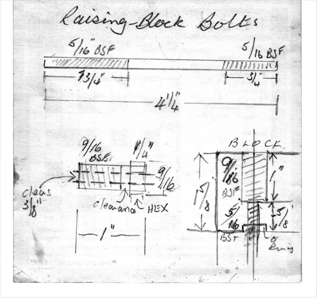

                  There is already a hole, but too small for the adjusters. Need to drill half depth of the block and tap to suit the adjusters. I'll go and check the thread, forgot all about it this morning when I did my "Early prowl"
                  I did have a sketch but can't find it in my albums.

                    Adjuster thread is 9/16" x 16 tpi BSF.
                    Found my crude sketch of bolt and block. Obviously I did this in a hurry for a visitor who was anxious to leave. I have that effect on people.
                    When I got my S7 I knew there was twist in the bed so fitted adjusters as the easy way to get rid of it, as the previous owner had them so I knew how much turn from zero I would need to get a parallel turn. (He was the second owner).    I don't claim they are the easiest or best way, just suited me.
                    Since then I have altered plain blocks for other people – mainly because I was the one with the 9/16 BSF tap!
