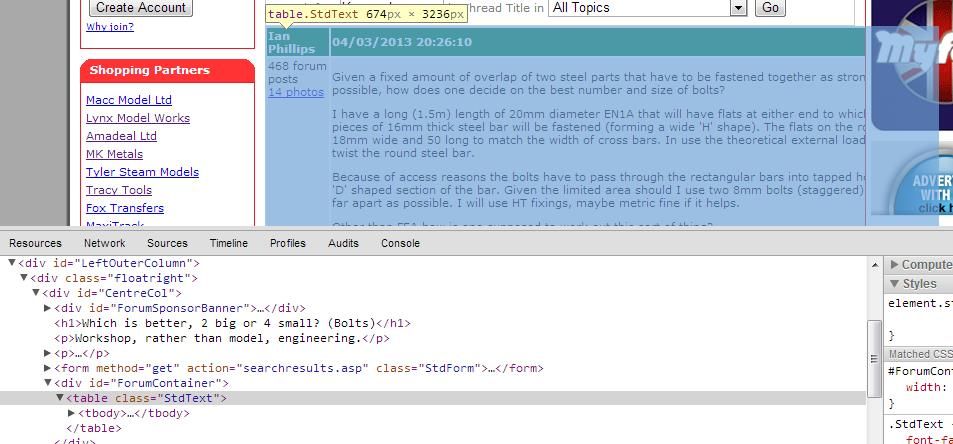

      Hope you don't think I am trying to be 'clever' but I have been having problems with the right column, showing the partners adverts, overwriting the posts, so I thought I would have a quick look at this? (I do this for a living) I have seen a few other comments about this so I am not the only one having problems from the looks of it?
      I have attached a screenshot that I think might show the problem – looks like the StdText class is too wide for the container?
      I have the problem with Chrome, doesn't appear to be a problem with FireFox but the developer toolbar (in FireFox) warns about invalid box sizing code in the CSS that is being ignored (and the problem does not appear)

            To be fair to Chris, he's the first person to specifically identify the cause and offer to help sort a solution, instead of just moan.
            Personally if I was MHS I'd bite his hand off or cross it with silver – when the adverts annoy the regular users* then its bad news.
