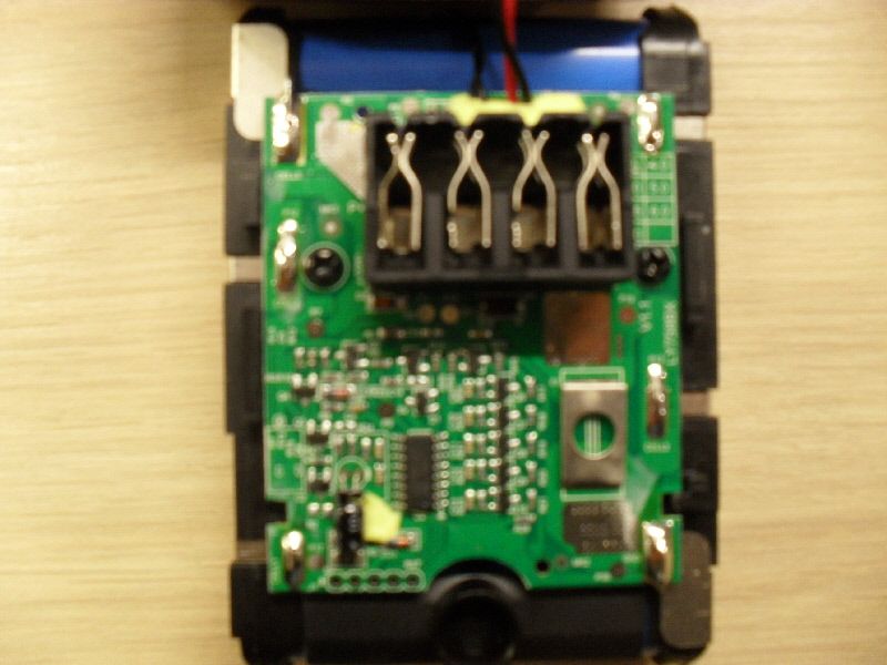

      I was in Lidl last week and spotted a pile of 20v Li ion batteries at half price but there were no chargers. Being Scottish I couldn't resist as I've been thinking for a while about getting a new battery for a small circular saw which has a defunct Ni cad battery. I have several 20v chargers for Li iion batteries but they have different terminal configurations (using the + terminal plus another between the +ve and -ve terminals. This one has both +ve and -ve at the outside plus 2 other charging terminals in between. I've attached a photo of the battery with the cover off to show the terminals and the charging circuit. I assume that I just connect 20v DC across the 2 inner terminals to charge and use the outer ones to connect to the saw. Can someone with more knowledge of these things please confirm (or tell me I'm being stupid!) thanks.

                            If this is the current 20V X-Team range then the charger only uses 3 of the 4 pins. The outer two are pos & neg (which are used for both charge and discharge), and the one next to the pos is labelled ID, which I speculate allows the charger to IDentify what sort of battery is connected and how it should be charged (?)
                            LiPos are trickier than NiCad/NiMh etc, they can catch fire if over charged and die if over discharged so you'd be better off waiting until you can get hold of a proper charger – they are not expensive even at full price.

                                It looks like a fairly standard 6 cell unit complete with the charge controller built in. This will include circuits to balance the charge across the cells to eliminate over charging/discharging any of the cells. Many of this type of board include temperature monitors to prevent charging/discharging the batteries if their temperature is excessive plus some form of current limiting, Dyson use a similar arrangement on their cordless vacuum cleaners and as you say the unit is fed from a standard DC PSU.
                                That said I would take on board all the warnings and advice given already as when these things go wrong it can be spectacular or devastating depending when and where they fail. Even the experts get it wrong as was demonstrated a relatively short time ago when several laptops burst into flames. Not a design problem admittedly but a flaw in the battery production. When fully charged they contain a significant amount of energy and can release this explosively. While these small domestic units are not in the same league we used to use large lithium batteries in remote locations and if these showed any signs of distress they were covered with dry powder fire retardant material and removed to a specified dry safe place well away from people and buildings etc.

                                      That is not a simple charger, it's clearly a proper balance charger that will be dividing the charge voltage across the cells so that if one of them is low or high none of them are overcharged, and no doubt it will not charge them at all if it sees they are faulty.

                                        A couple of people have mentioned LiPo cells, This pack is unlikely to be LiPo, looks like stadard cylindrical Li-ion cells.
                                        The voltage difference, 20V rather than 18V for LI-ion is marketing, 20V is the end of charge voltage for 5 cells (4V each) while 18 V is the nominal voltage (3.6V each). I thought that using the EOC voltage was banned or at least discuraged on in the UK under misleading avertising laws. An example of this is that identical Dewalt tools and batteries are marketed (and marked) 18V in the UK but 20V in North America.

                                          It occured to me after posting yesterday that the ID pin might be to allow the battery to identify the charger rather than the other way around. It would make more sense from a safety point of view to put the smart bit in the battery, i.e. will not take charge unless charger ID matches list but this is pure speculation.
                                          I know you can power things from the battery but just connecting pos + neg, I've done this, but only using a battery charged with the correct charger and being careful not to go anywhere near the point that I could be over discharging it. The matching tools cut out at a low point, again, would make more sense and seems likely that this is a battery function but I have not verified it.
                                          Final edit – the battery knows it's state of charge as it has red/orange/green LEDs on it. The charger knows, or is told the state of charge as it has red/green LEDs and signals when done, so more speculation, possible some signal is exchanged between them.
