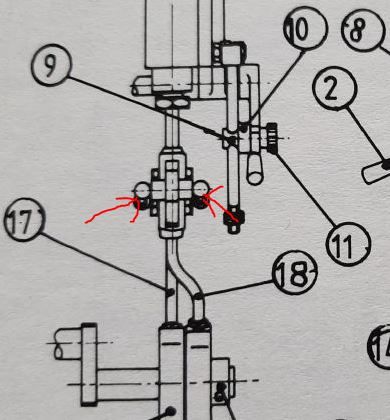

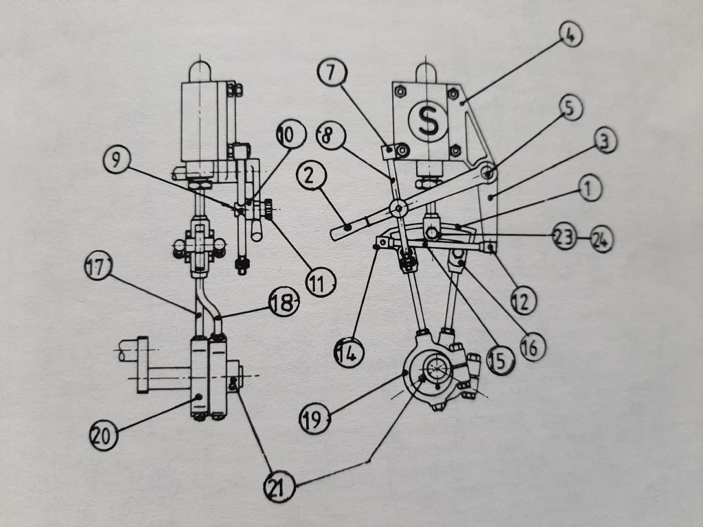

      I found this diagram on the internet. I'm NOT 100% sure but I think the reversing gear below is for a stuart 10v.20190818_132532.jpg
      OK, the pivot pin 5 passes through a hole in the bracket 4.
      On one end of the pin is attached the lever 2 and the other end the linkage 1.
      By releasing the knurled lock nut 11 you can raise or lower the lever to move sideways "the "part with slot in" 1, to select either forward or reverse rotation of the engine.
      As I see it for this mechanism to work 1 and 2 must be rigidly fixed to the pivot pin while the pin is free to pivot in the bracket hole 4?
      Assuming I'm correct how are 1 and 2 secured on the pivot pin?
      Geoff

          I believe 1 and 2 are pinned onto the piovot which is free to rotate in bracket item 4.
          If ypu check out Kieth Appleton on you tube he has a video on ST reversing gear.

              1 is not fixed to the pivot.
              Lever 2 and the arm 3 form a rigid bellcrank pivoting around pin 5 so as the lever goes up and down the expansion link 1 moves sideways.
              On the Double 10 the pivot 5 takes the form of a rod along the length of the engine so one lever 2 will move two arms, one at either end of the engine
              Edited By JasonB on 18/08/2019 15:47:43

                The lifting link between the bellcrank and the expansion link seems to be omitted from the LH diagram.
                #424885
                  Lifting links are there, one on each side. They are round ended.
                  Edited By JasonB on 18/08/2019 16:28:02

                      I was mistaken, as you say, it's 2 and 3 which are rigid and form the bell crank.
                      With such small parts, I believe the pivot pin is 3/16" diameter, is there a taper pin and taper reamer small enough to pin the parts together? If not I imagine you would use small carpenters moulding pins?
                      Geoff
                      #424896
                        At 3/16" the small end of a 1/16" taper pin will do fine.  As it's such a small engine you could just drill a plain hole say 1.2 or 1.4mm and turn a parallel pin that can be stuck in with a small drop of Loctite. These taper pinsare 1/16" pins through an 5/32" rod.
