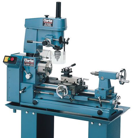

      Ron,
      If you look at the picture of the lathe you will see the feed screw for the saddle is permanently engaged and the manual handle is far right of the bed, at the other end the lower lever in the headstock engages the feed with the chuck so when I'm thread cutting I have to keep it all engaged otherwise I will loose position.
      Martin P

                    mechman48
                      @mechman48
                      Posted by martin perman on 24/12/2018 08:13:40:
                      Ron,
                      Martin P
                      I had one of theses CL500 as my first machine, IIRC the lever at the bottom left on the headstock, at the end of the leadscrew is a dog clutch & can engage / disengage the lead screw. As shown the leadscrew is engaged, you simply flip the lever over to the left to disengage. It is the arrangement of the gearing on the leadscrew that gives you your threading set up. The handle shown under the saddle is the saddle lock.
                      George.

                              MichaelG,
                              Again thank you, I shall enjoy reading the whole magazine. Mechman48 the lever under the saddle is only for clamping the saddle, if you attempt to engage the feed when clamped it will break the shear pin, the feed shaft can also be set to cut thread via the gear solection at the back of the headstock, I dont have a thread dial so have to stay engaged regardless of what thread I'm cutting.
                              Martin P
