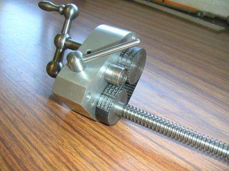

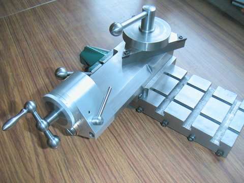

        I described with drawings a retractable ML7 topslide which could retract for external/internal  screwcutting in the MEW mag. It used a  toothed belt which gave  a  smooth accurate retract of 0.125″ with zero backlash.
        New Myford Topslide 2
        Toothed belt retract 1
        Alan
