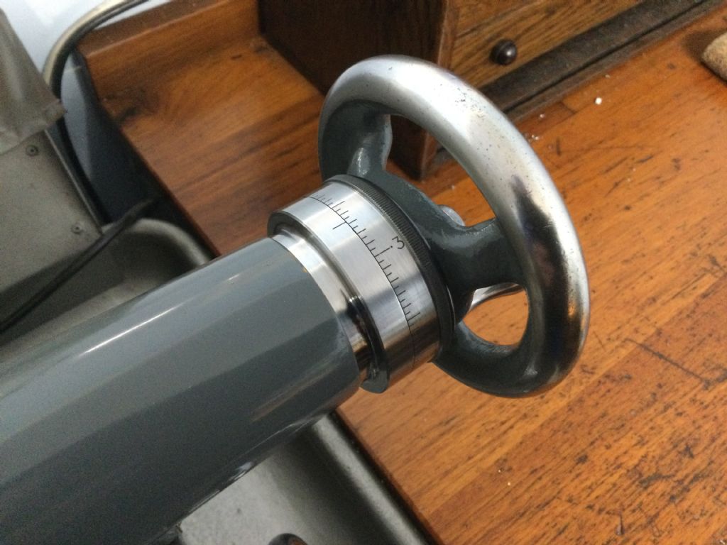

        #569969
        Mick B1
          @mickb1
          Similar instrument, similar issue:-
          …though on mine, the filling looks more faded than removed.

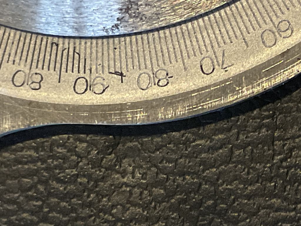

            There are 3 techniques that I've used:
            Firstly, you can fill the engraving with paint such as Humbrol, then wipe off the excess before the paint has fully dried. Trick is to use a piece of newspaper lightly soaked in white spirit as the wipe.. Done carefully, this will clean the surface and leave the filling intact.
            Another method is to use engraving wax. Usual method for clock dials. Heat the surface until the wax will melt onto the surface, then when it's set hard you can scrape/sand the excess off. Warm up again to restore the gloss finish on the wax.
            Last method is to immerse the item in blacking solution. After blacking, the surface can be polished up with very fine emery or wet&dry paper, leaving the scale blacked.
            Example of a scale that I blacked using the last method:
            Mike

                    I think it's Mike's Humbrol method for me. The newspaper technique looks practical – last time I tried it I used a rag with white spirit and that washed out the paint from the engraving as well as the surface.
                    I've never come across engraving wax, I can't source LacquerStik for a sensible price, and gun blue ain't never gonna work on stainless.
