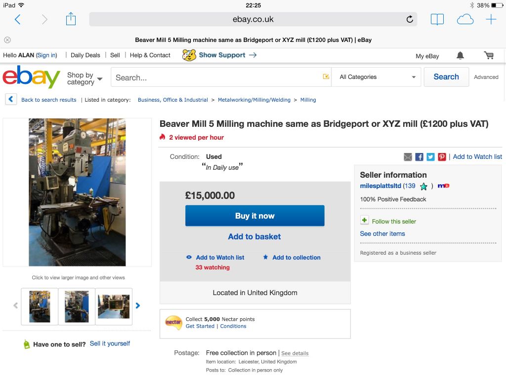

          Did you buy it Rob ?, still being advertised, but with a slight price increase surprise

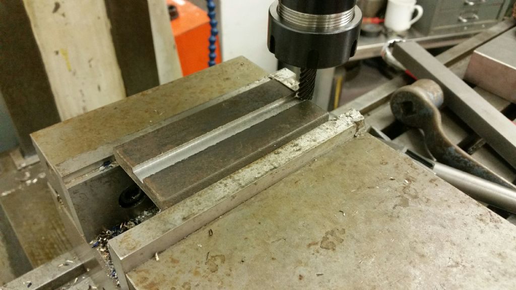

                                                Had some time in the workshop over the last few days, wired the head up to a new VFD inverter, put the table feed gearbox back together and fitted the motor to it (these items all came loose in a box with the mill), wired the feed motor to my RPC for the time being, eventual plan is to buy a smaller inverter to run the feed motor. Filled the head and gearbox with oil…………
                                                All seems to work as it should, so bolted on a machine vice and took a test cut…….yay it works 20161230_182452_resized.jpg

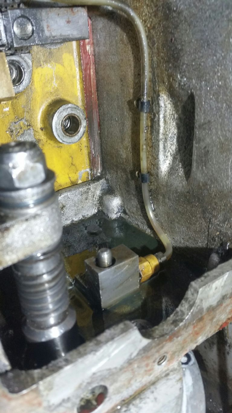

                                                One thing i can't figure out is the machine is piped for way lubrication, I found a pump in the bottom of the table feed gearbox, which runs from a cam on the bottom gear shaft. What i can't get my head round, is how the oil would be topped up…….or does it use the oil from the gearbox and pump that out on a total loss basis, presumably you would then keep topping up the gearbox ? If so then it would need really thin oil in the gearbox like hydraulic fluid ?
                                                #274710
                                                Mark Rand
                                                  @markrand96270
                                                  That pump is for the table feed gearbox itself. On the Mk1, 2 and 3 gearboxes, lubrication to the gear train relies on oil being carried upwards on the gear teeth of lower gears to feed higher gears and bearings. It worked, sort-of, on the earlier ones…
                                                  My Mk1 had suffered the indignity of at least the previous owner using grease on the ways. At the end of the re-scraping/rebuilding process, I blanked off and redrilled the existing oil ports and added a few more when fitting a one-shot system. It has 68ISO oil for the horizontal ways and 220ISO oil for the column ways:-
                                                  Oil manifods in sabble
                                                  oil manifold on side of knee. Same on other side.
                                                  oil pumps
                                                  Edited By Mark Rand on 31/12/2016 17:39:51
                                                  #274714
                                                  Alan Waddington 2
                                                    @alanwaddington2
                                                    Thanks Mark
                                                    That makes more sense now, thought it was strange.
                                                    Where was the original oil reservoir sited on your mill ? I have a pipe coming out of the side of the main column high up, it goes into an aluminium block that has a grease nipple threaded in to it ( although the pipe looks to contain thin oil) I can only assume the previous owner used a grease type gun to force oil through the lines.
                                                    lovely job on your mill btw, a lot of hours must have gone into that rebuild. Would like to see more images,Is it back together now ?
                                                    Alan
                                                    #274739
                                                    Mark Rand
                                                      @markrand96270
                                                      It didn't have an oil reservoir, just a number of oil nipples. Which is probably why previous idiots had used a grease gun on them. The original had 6 oil nipples, which gave limited lubrication of the table, little to the vertical knee ways (oil port exited into a gap that let the oil out) and none to the horizontal knee ways. After spending a lot of time re-scraping all the ways and making new gibs, I didn't want to have to do the job again, so nearly every separate surface has its own oil feed (26 in all).
                                                      The mill is back together now, but I've got a job on the back-burner to make two new poly-V pulleys for the motor/quill. This is because the existing ones have got chunks missing from the flanges. I'll try to fit some words and pictures together in another thread, but it might take some time, because I'm illiterate.
                                                      Edited By Mark Rand on 31/12/2016 21:40:02
