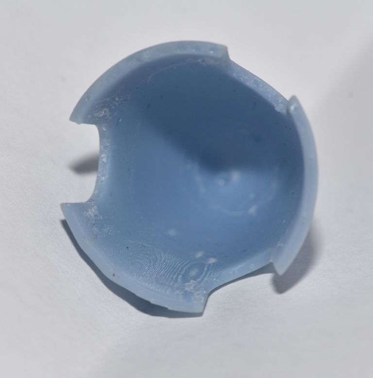

      Evening all,

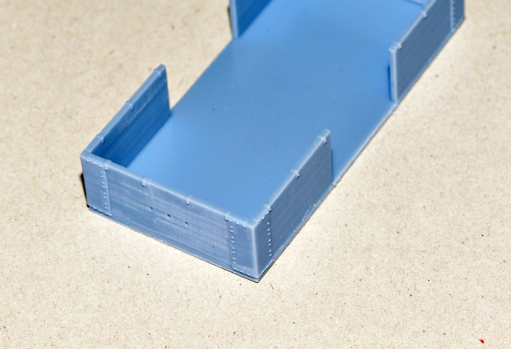

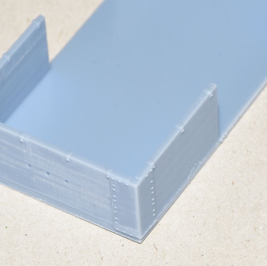

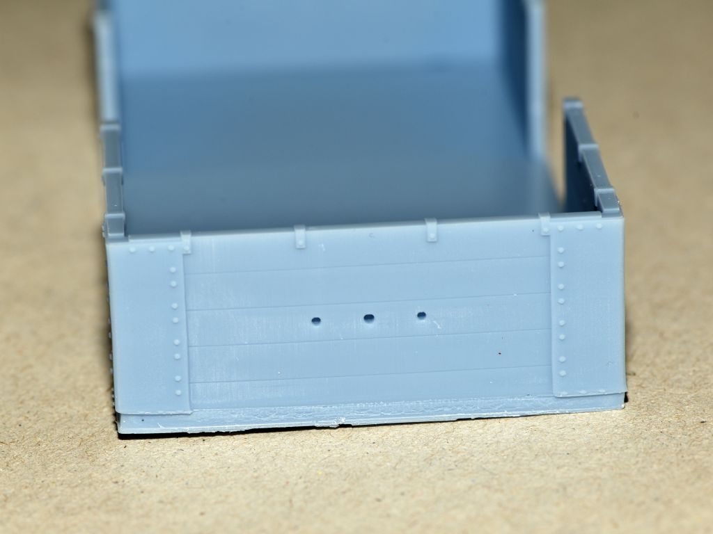

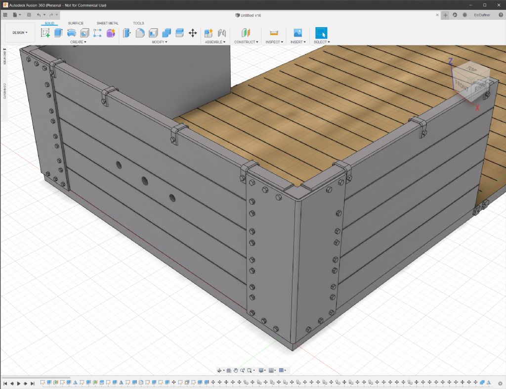

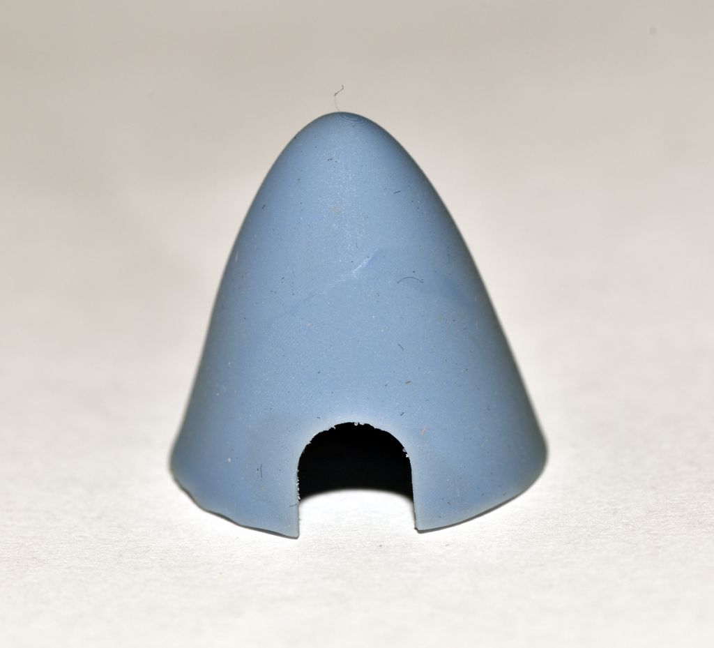

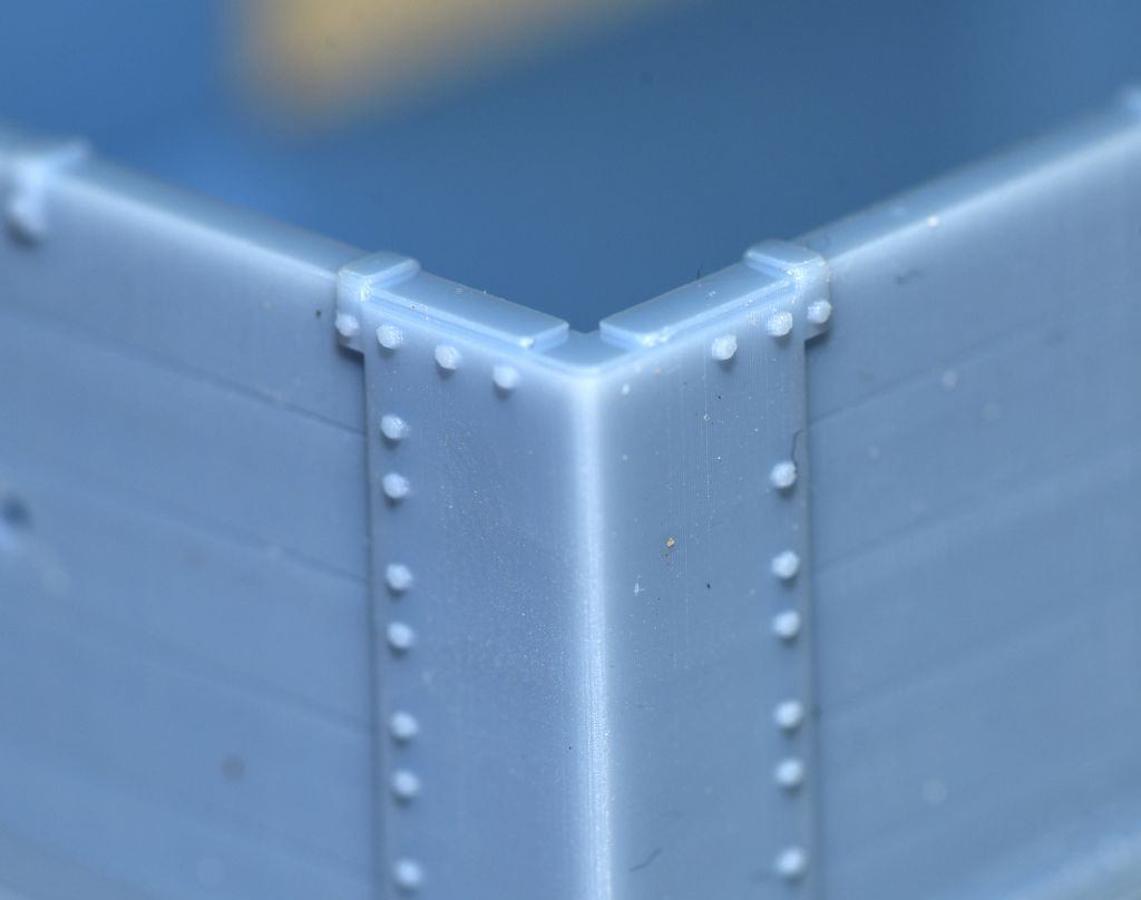

      As per Fizzy's earlier request, here are a few photos of a couple of test prints on an Elegoo Mars resin 3D printer.
      The two items shown are a Great Western 5-plank wagon body in O-Gauge and a spinner for a Hawker Hurricane in 1/24th scale. Both drawn up in Fusion 360 and exported as STL meshes.
      There are a few things I need to address; understanding "supports" and possibly adding in extra solid areas of resin to be later removed.
      Both parts took about 2 hours each to print. I have another wagon in the printer as I write this with finer layer build-up and supports. There were no supports in this first attempt and it appears to have gotten sticky around the edge of the wagon bed.
      The spinner might have benefited from some kind of skirt to support the wide edge. It has a wavy line where it should obviously be flat.
      Regards,
      Ed.
      The planks are 1.6mm thick.
      Holes appear to print quite well.
      I also modelled the plate that the spinner would mate to but only the supports for it came out. The plate somehow got disconnected and floated around in the resin.
      You can see the layers on the inside of the spinner which are accentuated by the camera flash. To the naked eye the layers are barely noticeable.

          #459242
          Bazyle
            @bazyle
            Impressive detail in those rivets. What size are they, about 10thou?
            #459244
            Ed Duffner
              @edduffner79357
              Actually, they're meant to be bolts Bazyle. laugh Some of them came out ok.
              They are 0.55mm AF.
              Ed.
              #459281
                Very nice although there seems to be a little warping.
                I understand resin parts may be a little flexible until the resin fully cures in ambient UV light?
                What was the layer height you use and how long did they take to print?
                I do sense the need for an MEW article once normality returns!

                    Ed Duffner
                      @edduffner79357
                      Neil,
                      Yes the warping is apparently a known issue with the printer's Z axis. On my printer there is some shift in the Y axis (~0.5mm), even though it doesn't have a Y axis and the inital layer heights are inconsistent …the first layers resemble puff-pastry.
                      There is an upgrade available to swap the rod type linear rail for a double rail and truck, Hi-Win kind of setup. But I'll see if I can engineer that out first.
                      This printer uses a UV light underneath an LCD screen to partly cure a layer of liquid resin. Each 'sliced' layer is masked from the UV light by switching on/off pixels on the LCD screen for 8 seconds (controllable in software). The very first layers are exposed for about 50 seconds to make sure they stick to the build plate.
                      When the model is taken out of the printer it needs further curing via either sunlight or a dedicated UV light source of 405nM, which is what I'm using.
                      The layer height for this print was 50 microns, 0.05mm and took about 2 hours to print.
                      Michael, very small ! laugh
                      Ed.

                          Roger Clark
                            @rogerclark
                            Posted by Ed Duffner on 24/03/2020 14:57:33:
                            Neil,
                            This is called elephants foot due to the extended time required on the initial layers, lifting the item up by 5mm and using supports, preferably with the Prusa slicer (and then export with supports into Chitubox) should cure that. Might need a bit of experimentation. Plenty on YouTube about it.
                            Roger
                            #459385
                            Ed Duffner
                              @edduffner79357
                              Thank you Roger,
                              I started another print a short while ago and have elevated the model about 10mm on heavy supports, with more in each corner. The second print I did last night failed because the model started to pull away from the build plate.
                              I noticed the detail in the rest of the model was better due to the printer's minimum layer height of 25 microns.
                              Ed.
                              #459413
                              Roger Clark
                                @rogerclark
                                Try tilting it slightly, 5mm from the plate one end to 10 or 15 mm the other end, should reduce the suction from the fep on the lift. Temperature also plays a part, resin temp of 27c or warmer is best. and then play with the layer times if that doesn't work but only one change at a time. wink
                                Roger

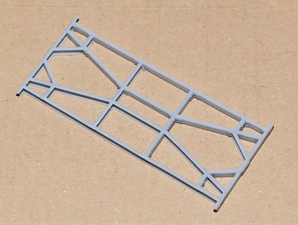

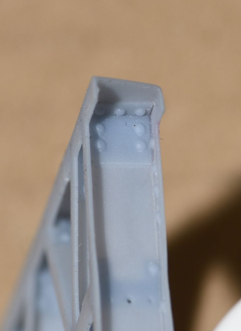

                                  Good day, hope you're all doing ok.

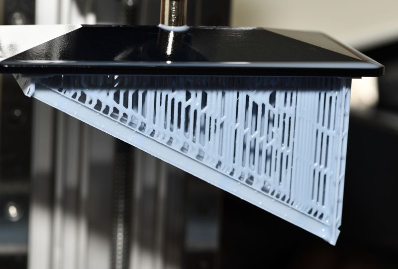

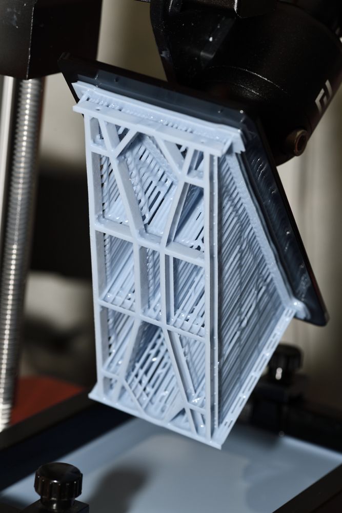

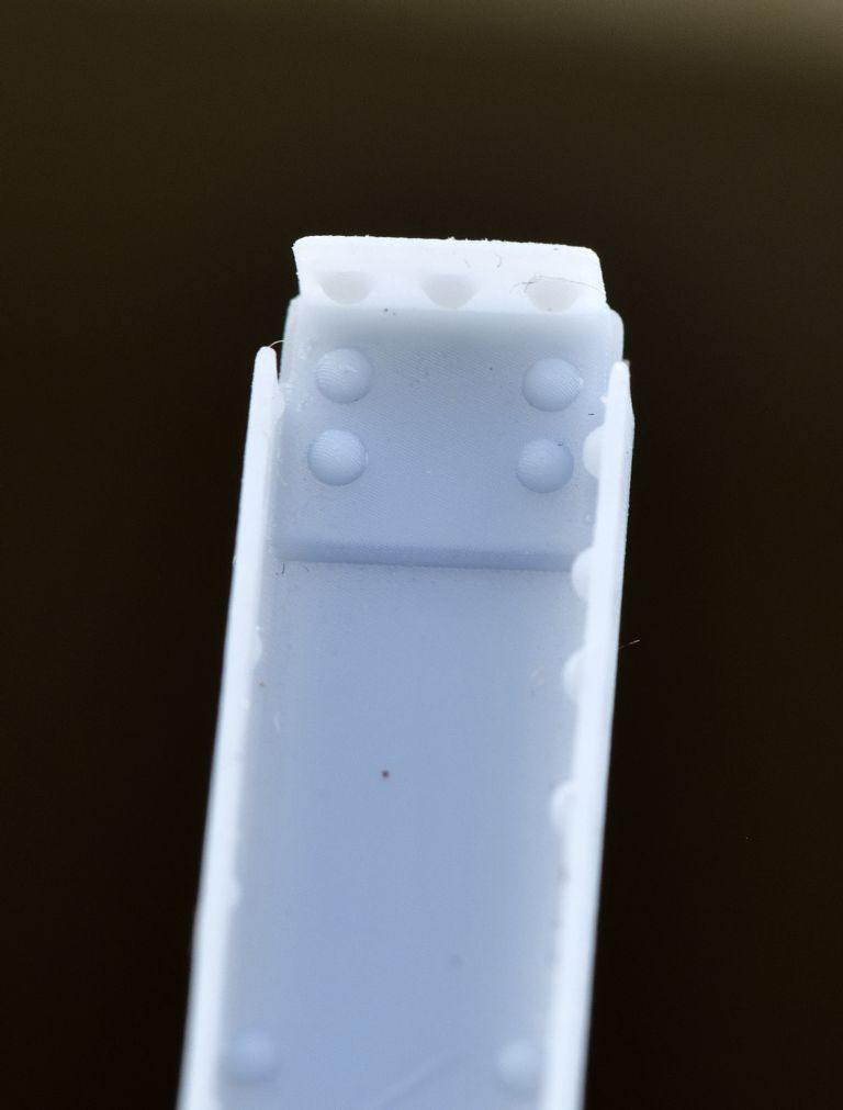

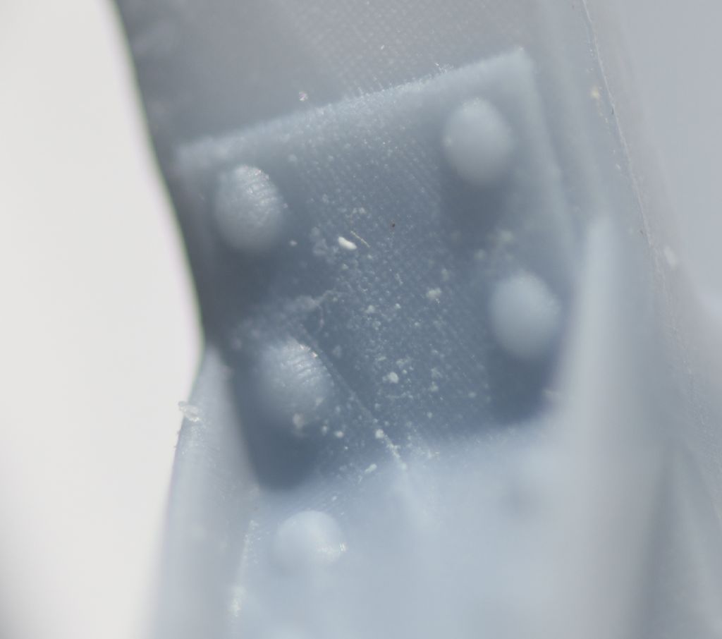

                                  After finding some original wagon drawings online I abandoned my previous 3D model and set about drawing a full scale accurate under-frame with all the brackets, screw and rivet holes. I assembled it in fusion 360 and scaled down to 1/43.5 (Scale Seven). it's taken quite a few hours.
                                  I continued on and made a couple of test prints of a sole-plate, complete with end bracket and rivets (it's the long beam that runs the length of a wagon), It's shown in the first photo below. The result was quite promising so I set up a print of the whole under-frame and loaded it into the printer.
                                  Some 13.5 hours later no less, the print was ready. It was removed from the build plate, washed in IPA and removed from its supports. Due to careless impatience I managed to damage a couple of small areas but these can easily be repaired.
                                  Ed.

                                  #463704
                                  Bazyle
                                    @bazyle
                                    That is amazing detail and precision. I imagine you could even make and allowance for the thickness of paint.

                                      #463726
                                      Ed Duffner
                                        @edduffner79357
                                        Thank you Bazyle and Roger,
                                        Yeah I was thinking the same, it's a very wasteful process. If the build area were bigger I could flatten the print more and save a lot of resin. This is only a one-off build though, just for fun and to get my feet wet with 3D printing.
