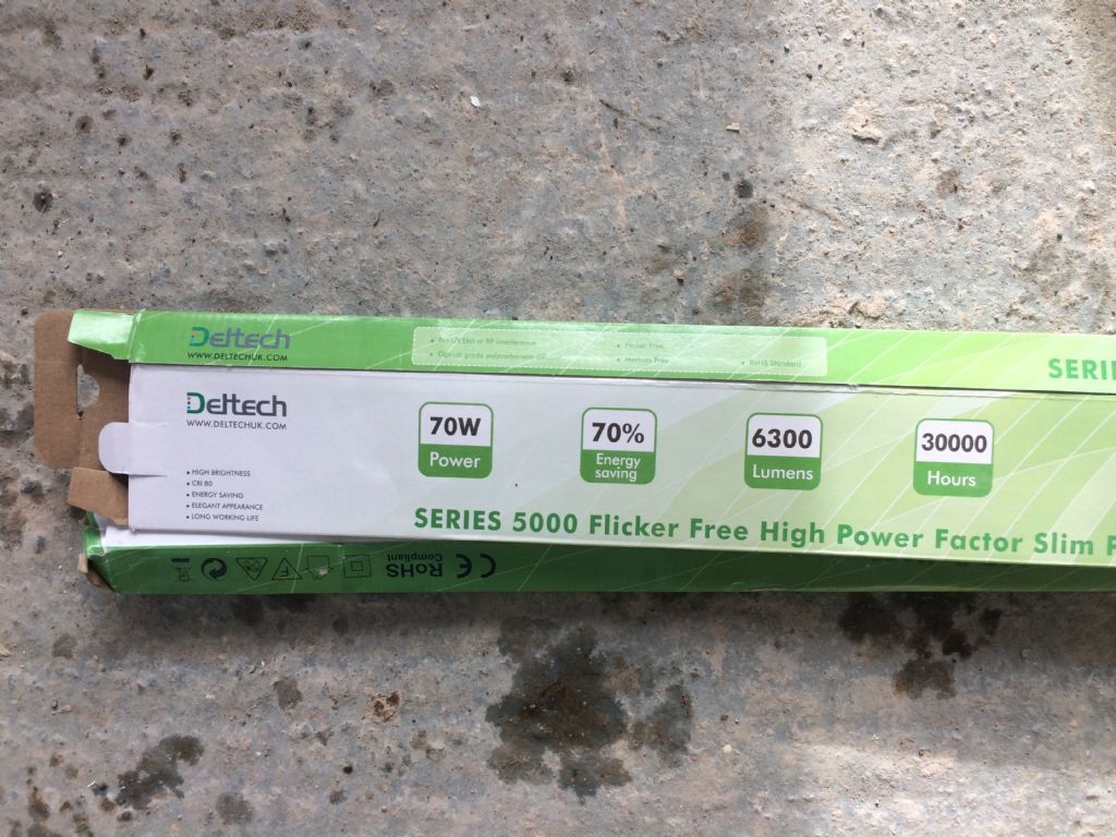

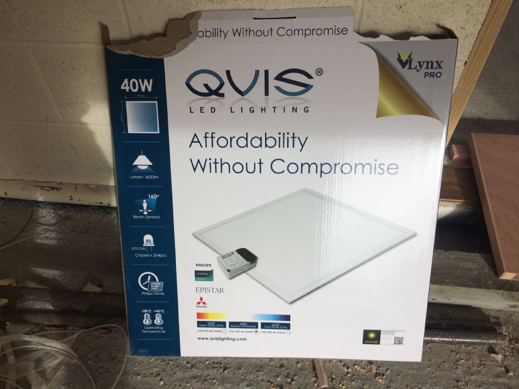

        Hi all here are a couple of photos showing the LED lights we fitted to our new establishment
