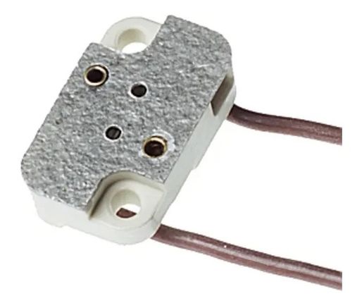

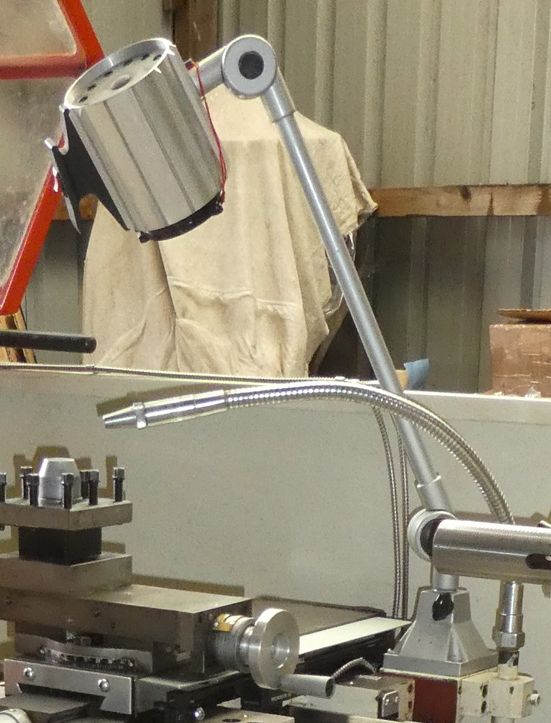

      My lathe has a lamp:
      The lamp used to work, then it made a fizzing noise and stopped working. I took the lid off, removed the bulb (a G6.35 halogen), and ascertained that it appeared to be intact. Noticing the legs were covered in what can only be described as grime, I wondered if some sort of deposit was blocking the healthy flow of electrons. A rinse in vinegar and an overnight dry, I popped it back in, and, success! A working light.
      For a few days. Then once again a fizzing sound followed almost immediately by darkness.
      This time I thought I had better take it to bits and check it properly, which I did, and found some very old and tired looking wiring. And I found a lampholder, looking like one of these:
      The one I have is somewhat elderly, and along with the wiring I think it should be pensioned off. Which leads me to the problem: what to replace it with? I am stuck (well, do not want to replace) with 24V AC. As far as I can see that pretty much rules out LED solutions as there doesn't seem to be anything commercially available that would be a drop-in replacement. The lampholder itself doesn't seem to be available any more (at least in quantities less than 100), and the reflector is 65mm, not the 50mm standard used in household bulbs.
      The ideal would be I guess a GU4 type bulb and holder, or something like it. I can reuse the reflector of course, but I'm not sure if there's anything it would attach to out there. I could make a holder out of Delrin but I'm not sure Delrin and a 150W halogen bulb are a great mix.

                Yes, the lamps themselves are easy – it's the holder I'm looking for, or if the holder can't be found a replacement for the whole assembly.

                    peak4
                      @peak4
                      Posted by Calum Galleitch on 18/06/2022 19:48:00:
                      Lorries/campervan electrics are DC and seem to have all gone over to LED already – I did think that was the obvious place to look but I couldn't see anything obviously useful.
                      These don't look a mile out
                      https://www.amazon.co.uk/GY6-35-Holders-Ceramic-Halogen-Connection/dp/B00CERLCJA

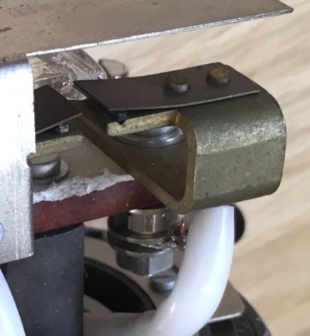

                                  I think the underlying problem that you have is the inadequate quality of contact in that type of holder.
                                  The lamp pins oxidise because of the heat generated by contact resistance
                                  A much better arrangement [commonly used in microscope illuminators] is to clamp the pins down on a vee groove; but, of course, you may not have space to do this.
                                  P.S. __ digressing somewhat: This article may be of general interest

                                  #602316
                                    Too late to edit, but this is the style of pin clamping/connecting used on my big LOMO microscope:

                                      Yes, I think you're right – both the lamp itself and also the wires connecting to the switch are both in pretty dubious state. Nowadays when you buy these lampholders they tend to come with wire pre-attached, but mine just had a push-fit, one of which has failed entirely.
                                      Peak4's link above looks spot-on, so I have ordered one and hopefully that will last another twenty years!
