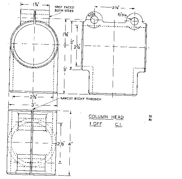

                              Could I suggest that as AdrianR has noticed that the Mk2 version has a stronger casting and Kettrinboy has had to reinforce his when repairing it after his cracked, that any repair you contemplate such as welding or metal stitching that will leave the part as good as new or nearly so may not be adequate as the are indications to me that a design fault was recognised and corrected in the Mk 2 design?
                              Certainly adhesives, as good as these are today would probably not be a good choice in my opinion.
                              I think the only way to make the machine usable in such a way that it stays usable would be to remake the part, or have it remade as John Baron has already suggested.
                              A block of steel would perhaps be ideal and an improvement on the original, although cast iron is also available.
                              If it is of any help here is the drawing from the original Westbury article, but you would need to see if this part changed when the design was produced commercially as the Dore-Westbury. At a casual glance it appears not to have been, but please check.

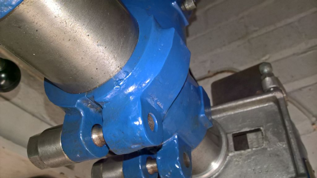

                                  Metal stitching was originally employed in repairing castings, where plugs are inserted into the casting to be an interference fit, putting the local cast metal into tension.
                                  In this cased the problem is excessive tension, so would be unsure that such a repair would be effective, if not actually making the problem worse.
                                  My vote is for replace, if possible, either by one piece, or as suggested, by clamping together two half pieces.
                                  Possibly two fairly thick steel (say 3/8" ) half collars could be made, to fit over the casting, located by longer bolts passing through the existing holes, so that the clamping forces are actually applied by the steel compressing the cast iron.

                                      Looking at the drawings above, that looks like it could be fabricated out of 3" OD, 1/4" wall steel tube. m-machine-metals can sell you 76.2mm OD x 6.35mm wall for £17.83 + P&P

                                        Also looking at the drawing of the offending item it bears a strong resemblance to a pipe "T". You'd have to check sizes but a "black" (not galvanised) malleable pipe T might make a good starting point as possibly would a suitable sized KeeKlamp (or similar)T. If you have plumbers merchants or scaffolding contactors nearby it could be worth having a word to see what they can offer as a starting point.
                                        The other thing I'd be looking at would be to get rid of the split casting clamping arrangement and to change to a proper split cotter system, much less chance of breaking things.

                                          Adrian, thank you. In fact, I have such a tube – ex Shoprite(?? radial arm saw – the source of the patch shown in photo 2.
                                          Keith, thank you also and your suggested source is noted – sounds possible. I don't have enough engineering knowledge to visualise the 'proper split cotter system' – could you expand a bit, please?
