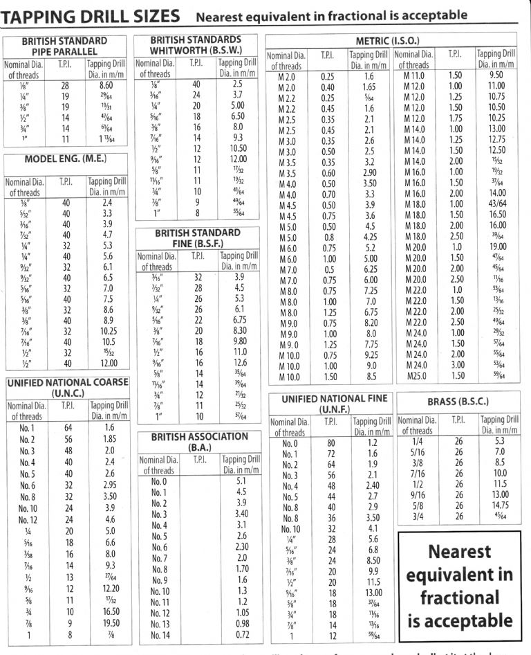

      Hi !
      I live in France (so please pardon my English).
      I've had through some family members an old steam machine. Though some pieces are missing or broken, I did manage to run it a few years ago.
      But I want to give its orignial beauty and completion, so then I can start trying to make my own live steam engine
      My problem : most of my measuring tools are in metric, but bolts etc seem to be in inches.
      Here are my measures :
      1/ Tubes thread : 3.4mm diameter, 40 – 0.635 for the thread (I got a thread reader in inches !)
      2/ Bolts for cylinder fixation : 2.78mm, 48 – 0.529
      3/ Support for water level : 5.96mm, 30 – 0.846
      4/ Water Tube thread : 7.84mm, 30 – 0.846
      So from this table ( http://www.allcap.co.uk/Conversi.htm ) I guess 4/ is something between 4BA and 2BA – 30, 3/ is 5BA – 30, 1/ is around 10BA – 40 and 2/ around 12BA – 48 ?
      Or are those unusual and could be in metric/other system ? (doesn't makes much sense considering the values)

          /5 diameter of 7.84mm is .310 inches. So just under 5/16". Most threads are made a few thousandths of an inch smaller than the nominal size. Try looking at other thread systems for something that is 5/16" by whatever the threads per inch is. (30?).
          Depending on where the engine was made, threads could be other than BA, such as British BSP (pipe thread), BSF (fine), ME (Model Engineers), BSB (brass) and so on. Or American NPT (pipe), UNF, UNC etc.

            PS, this chart might be easier to use than the one you posted link to.

              The measures I gathered are for the "male" parts (for wich I need a die). Female parts are a fraction different in diameter (for the tap). Does this chart work for both ? As inside and outside diameter aren't the same +/-3% of the diameter around the thread.
              Edited By Thomas DION on 07/04/2018 10:06:17
              #349153
              Hopper
                @hopper
                Taps are usually made to the nominal diameter or a few thousandths of an inch less. So a 5/16" tap will usually measure 5/16" diameter, or within a couple of thousandths. Yes, the chart works for both. The hole in the middle of the die will be approximately the same as the listed tapping drill used to drill a hole before tapping the thread in it.

                              I'll try keeping updates around here, but from other sources, I've found most threads aren't conventional, and I'll try making my own taps and dies
