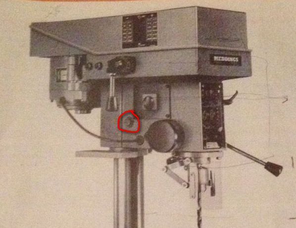

      I need to pick up a meddings MF4 and am pretty sure I will have to remove the head and table to transport it. Or rather to lift it as I gather they are not light and I am going to have to do it without a crane etc.
      Can anyone advise how the head is fastened to the column on these? It would be nice to be prepared and be sure I have the right tools with me
      btw. it is the later, square head style if it makes any difference.
      Any advice gratefully received!

                The bolt behind the feed levers releases the head clamp. I transported one of these singlehanded and broke it into bite sized pieces. i would take the motor off the head first but make a note of the connections. these drills are very top heavy so be careful. i think it may be worth letting the table and head slide to the bottom and pull the column out while laid on its side, some wood blocks would be useful. As nigel said the column is much more cooperative when cleaned. I have a parts leaflet with an exploded diagam as a PDF if you would like a copy send me an email address by personal message and I will send it to you (it is 10Mb).
                the head clamp bolt is M12 so 19mm AF, the base clamp is M16 so 24mm AF
                The overall weight is 144kg or 315lb
                Lifting the head off the top will need at least 2 people and preferably 3 which is why I would let gravity be my friend and drop the head down the column

                    btw, I have been looking at pictures online, is the head bolt the one circled in red in this picture?
                    #275997
                    Mike Poole
                      @mikepoole82104
                      Yes that is the head clamp bolt.

                                  I got hold of an MF4 last year. When I went to collect it the seller, a very nice guy indeed, helped out.
                                  In case it is useful, this is how I did the move.
                                  We took the motor off to reduce weight and prevent damage.
                                  We took the pulley cover off to reduce weight and prevent damage. There is a clear plastic screen on the side of the pulley cover that is easily damaged.
                                  There is a chuck key plate just below the head, that is also secured around the column. For safety, there is a sticker on the head, that states, 'Do not release this collar until the above head HAS BEEN LOCKED OR SUPPORTED'.
                                  I stood on a Workmate bench next to the MF4.
                                  The pinch bolt (cotter pin), as indicated in the photograph, was undone, and I lifted the head a little way up the column.
                                  I moved the head up the column a little way, and then the other guy clamped the collar/plate under it to stop it falling down. I moved the head up the column a little more, and the plate was clamped under it again.
                                  When the head was at the top of the column, still standing on the Workmate, I lifted the head off the column. The other guy then moved the base+column out of the way. I then lowered the head onto the Workmate.
                                  We then removed the table from the column.
                                  I transported the base+column, table, motor, pulley cover, and head, in a hatchback.
                                  As Mike says, the column is substantial, and you have to be an animal to bend it.
                                  At the other end I was on my own.
                                  In the workshop, I laid the head on the floor on some blocks of wood.
                                  I then laid the base and column horizontally on some blocks of wood, so that the column lined up with the hole in the head.
                                  I then slipped the table, followed by the plate, onto the column.
                                  I then slipped the head onto the column.
                                  I moved all the pieces to the bottom of the column. I then lifted the whole assembly up so it was vertical. With all the bits at the bottom of the column, the center of gravity is on your side.
                                  I then gradually moved the head up the column, by lifting it a bit, and clamping it, and clamping the chuck key plate, etc.
                                  The guy I bought it off showed me a trick to move the head on the column … firmly lock the table below the head. Then bring the quill down so it touches the table, and keep winding, so the head is raised. Lock the head, move the table up, and repeat ad infinitum. I kind of think that this is not too good for the gears?
                                  When the head is at the top of the column, it does get very top heavy, and awkward to move about.
