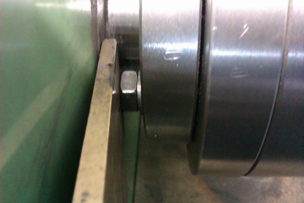

        Posted by Neil Wyatt on 27/10/2017 14:01:51:
        Colin won't have enough space behind the studs to fit long nuts.
        Get a bar of aluminium or brass that fits between end of stud and headstock.
        Lever each stud gently forwards a touch, in turn while supporting the chuck with your other hand. It only has to move about 1mm to come free.
        Don't be tempted to ease anything, the chuck may be what's tight rather than the register. A tight fit is good for accuracy, but it will ease slightly in time so a gentle tap with the base of your hand will probably be enough.
        Actually I don't need to use long nuts. I have some scrap solid hardwood (from a previous project). I just need to make a thick shim that just fits behind the stud. Then unscrewing the nuts on the studs will give me about 5mm of "push" which is about the same length of the mandrel shoulder.

          I have shown the jacking off method before as it is the method I use, there are pics in my album but for those who don't want to trawl through 1000 pics here they are again.
          Bit of 1/4" flat brass to protect headstock
          Just wind th enut off so it jacks the chuck away from the flange, you can then either carry on with the spanner of use the flat bar as a lever
          As the spigot on a lot of teh far eastern machines is about 10mm long but you really only need a short length to keep things concentric why not also machine a slight taper into the backplate so most of the parallel hole no longer makes a tight press fit on the spindle
          Just use one chuck to hold the other by having them both grip a thick bit of bar and clock them true

              A Mini lathe register is only about 2.5mm deep.
