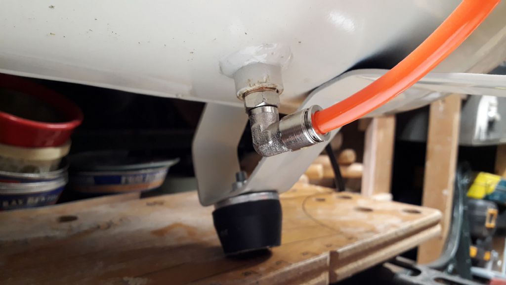

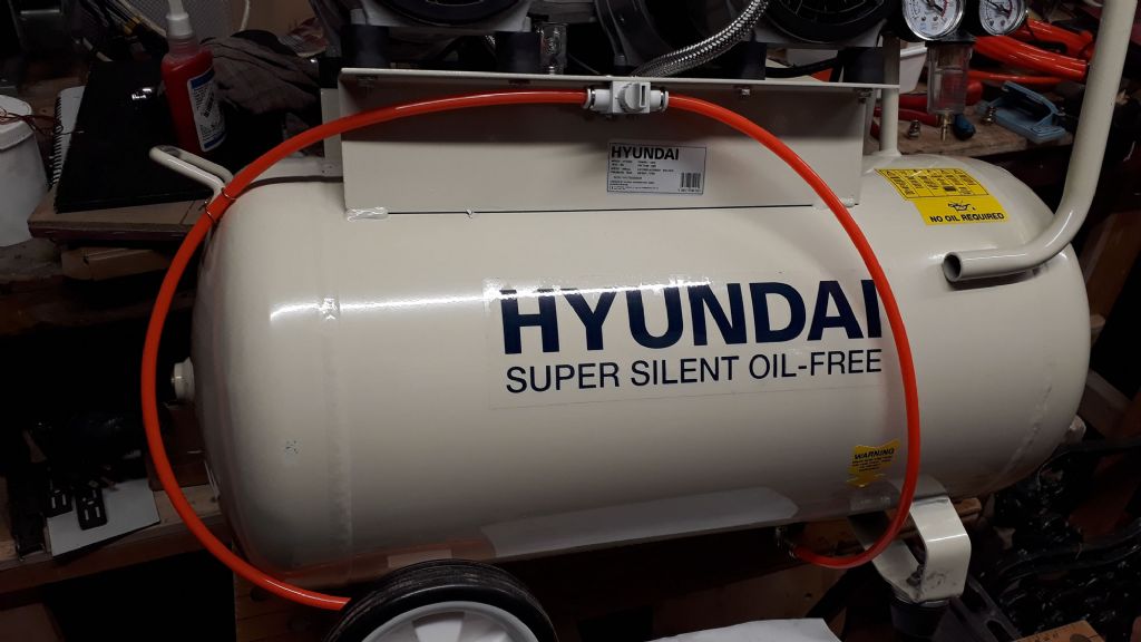

      I have replaced my small noisy compressor with a larger quieter on and decided to fit a remote tap for the draining of the air receiver. The inaccessible valve on the old one always irritated but never got round to fixing it but the solution was extremely simple in the end. One swivel 1/4" BSPT elbow with 8mm push fit outlet, one 8mm push fit valve and a meter of 8mm plastic tube all from a helpful seller on ebay (cpmpneumatics) fitted in 15 minutes, should have done it years ago.
      compressor drain tap 01.jpegcompressor drain tap 02.jpegcompressor drain tap 03.jpeg

          That is very good.
          Just be aware though , that over time , water will get to contain more and more rust and perhaps block the ' overhead' route.
          A direct blowdown now and then , just to check, is fine.

            It would be pretty obvious if it became blocked but I expect blowing air through it at 100psi on a regular basis will keep it clear.

                              That is exactly what I did when the new compressor was installed at the museum. The compressor is outsise the workshop building in its own little locked up house. The hose is led inside to a ball valve and back out again to vent. The valve is at a convenient height, easy to reach and the receiver is drained every time we go home. The main three phase switch is also inside the main building. We check the oil level once a month, it never seems to use any.
                              If the job is easy, it will get done, if somebody had to struggle to drain the water every time, I doubt if it would.

                                  I thought the point of the drain cock being on the bottom of the receiver was that is where the water collects. The tubing should run downhill all the way from the drain point, taking the tube up above the receiver is like a trap on a sink or toilet it will never drain completely. Tom.

                                    While I agree that there will be some residual water in the line, it is most certainly not like the trap on a sink or toilet! Have you ever flushed the loo at 100mph? I would suggest that if the rise is substantially shorter than the initial horizontal section and the pipe is mm in diameter, not cm, all would be well.

                                            If the drain pipework runs upwards from the drain point on the reservoir, moisture will remain in the bottom of the pipework, and possibly in the reservoir, which defeats the purpose!
                                            So the condensate drain should always run down, away from the reservoir.
