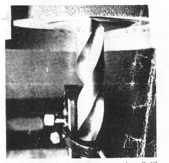

                      Further to the drill projection when using the Reliance jig here is one of the pictures from the photographic instructions showing the drill position before grinding.
                      Drill position
                      Makes the “push the drill forward until the centre of the first indent is aligned with the front of the trough” a bit clearer. The faint white line shows the position of the front of the trough. Not as clear as you’d ideally like. Probably a not too good scan of a second generation photocopy.
                      As ever nice and clear with a bigger drill in places but probably less clear with a small one up.

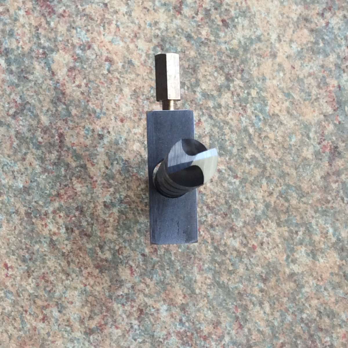

                        on my sharpening jig which is a version of the one by roland gyllander in 1995 the drills are fairly fixed to a cross drilled bar so they must be 180 apart ,this is guaranteed.IMG_0405
