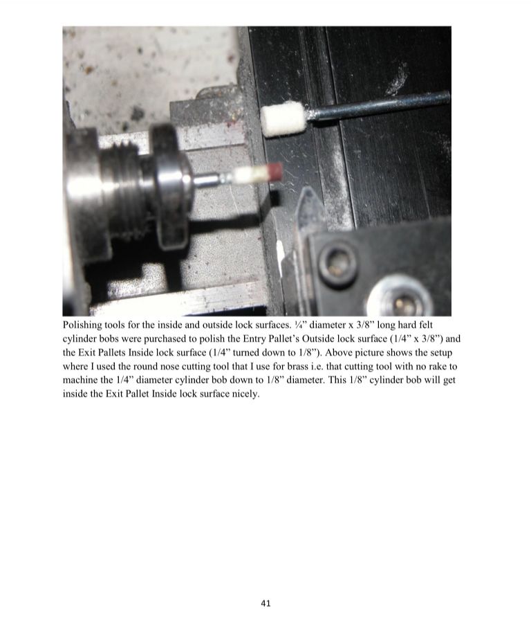

        Hi Guys,
        One of the ways of finishing pallets on escapements suggested the use of hard felt cylinder bobs.
        Can these be reduced on the lathe to get a reduced felt diameter?
        I would be aiming for 3/32 Dia. Even if i can get that diameter I would still be interested if using a lathe the diameter can be reduced.
        Regards
        Chris

              Posted by Michael Gilligan on 26/10/2020 10:55:07:
              Posted by Chris TickTock on 26/10/2020 10:48:09:
              Hi Guys,
              dont know
              Seems very likely to round various edges, and generally ruin the geometry.
              … There’s a difference between ‘shiny’ and ‘accurate’
              The reason that I ask is that I found online an article a clockmaker who does it using the same zero top rake round nose cutter he uses for brass. Felt being softer than metal the zero rake makes sense but as I have no hard felt cylinder bobs yet I have no idea. if it cuts evenly fine and of course the quality of the bob may prove to be all important.
              Chris

                                    From p42 :
                                    Hard Felt Cylinder Bobs:
                                    To polish, the hard felt cylinder bobs illustrated above are used for the two final polishing steps
                                    (1 st brown tripoli and 2nd red rouge). They worked great. […]
                                    The turning tool is illustrated on p41, and I admit that I am surprised.
                                    Unfortunately, however, I can find no specification for his ‘hard felt’ so feel unable to comment any further.
                                    Ref: for the convenience of others
                                    http://oldetymesclockandpocketwatch.com/assets/LEVERS_with_bent_strip_recoil_Website_Version.pdf
                                    Edit: These Questions and Answers may be of interest:
                                    https://www.feltbobs.com/catalog/index.php?main_page=page&id=11
                                    … especially Q2

                                        Thank you Michael,
                                        As you can see adding the site link did not help answering my question as to the cutting the bobs on a lathe, which is why i saw no point adding it. I am told by Jerry Kieffer that David was one of his students a few years ago and is very bright with good ideas, from what i see i agree.
                                        Chris

                                          #503588
                                            Posted by Chris TickTock on 26/10/2020 16:34:02:
                                            Thank you Michael,
                                            As you can see adding the site link did not help answering my question as to the cutting the bobs on a lathe, which is why i saw no point adding it. […]
                                            But it did at least let me see that:
                                            1. He is discussing bent-strip pallets
                                            2. He only uses the bobs for the two final stages of polishing
                                            3. The lathe tool, although zero rake, is not round-nosed
                                            So I am a little more relaxed about the idea now !
                                            Edit: If only we had a McMaster-Carr outlet in the UK …
                                            https://www.mcmaster.com/felt-bobs/
                                            Edited By Michael Gilligan on 26/10/2020 16:47:42
                                              Your not reading the same pages as me Michael, look at page 41 there is a picture with words below;
                                              'Above picture shows the setup where I used the round nose cutting tool that I use for brass i.e. that cutting tool with no rake to machine the 1/4” diameter cylinder bob down to 1/8” diameter. This 1/8” cylinder bob will get inside the Exit Pallet Inside lock surface nicely.'
                                              He is also clearly discussing a deadbeat of anchor design in relation to the cylinder boss.
                                              Shall we just leave it as a don't know and say no more about it?
                                              Chris

                                                  Well I just tried it on a Dremel one and cut no problem with my usual brass tool. Your biggest problem will be finding one on a small enough shank if you want 3/32" dia and to still have some felt left.
                                                  Edited By JasonB on 26/10/2020 17:38:09

                                                      Posted by Chris TickTock on 26/10/2020 16:58:03:
                                                      Sorry, Chris : I can’t do that ^^^
                                                      If the tool is round-nosed … This must be a very bad picture:
