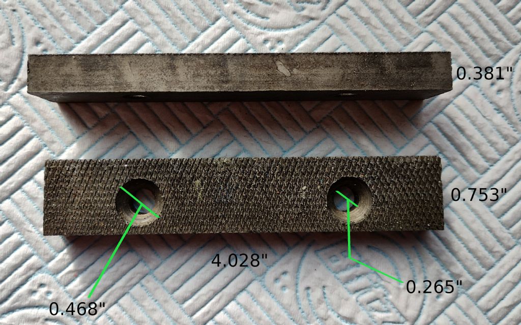

              This is a set from My record No. 3, current jaws are aluminium.
              Best as I can measure. Hole centres are approx 2.110" or 2 7/64" (definitely less than 2 1/8" ) which seems a very odd measurement and the holes are 5/16" up from the bottom of the jaw. Perhaps they were 'fitted' individually!

                Further to my last and to expand on John's above I've managed to get the screws out and the holes in my jaws measure .270 dia., the screws are 1/4 -20 ( BSW I assume, although a 1/4" -20 UNC seem to fit ) are spaced .325 up from the bottom of the jaw and are spaced 2.130 by measuring across the outside of the holes and subtracting the .270 hole diameter. The .270 was measured with an internal mike and the other measurements with vernier calipers
