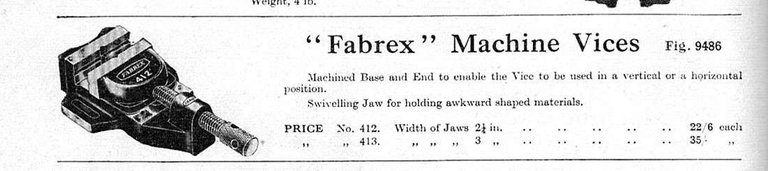

      I am curious why the front is machined? My only thought is that it is to allow it to be aligned with say an angle plate bolted to the table?

        It’s so you can stand it on a shelf upright and it doesn’t take up so much room.

          Hi, these vices are machined on the end so they can be used in the vertical position.
          Fabrex Machine Vice
          Regards Nick.

            Thanks Nick. I assume that you would need to use an angle plate to bolt it in position, presumably more for milling use than use on a pillar drill. I thought I got mine cheap until I saw those prices. Having used it a bit now I do like it, but had to get used to pulling the moving jaw back, a slight disadvantage. It does seem well made, and although second hand was sold as unused, certainly looks like that could be true. certainly a big improvement on the cheap one I previously used.

              Hi File Handle, yes you would have to attach your vice to an angle plate to use it in the vertical position, although you could probably use a tilting table that will swing to 90 degrees to the milling table.
              The prices shown in the scan, are from 1964, and the 413 was about a quarter of my father’s basic take home pay each week back then.
