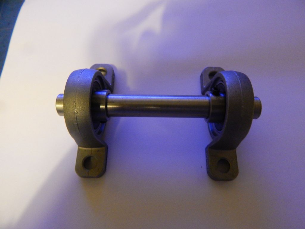

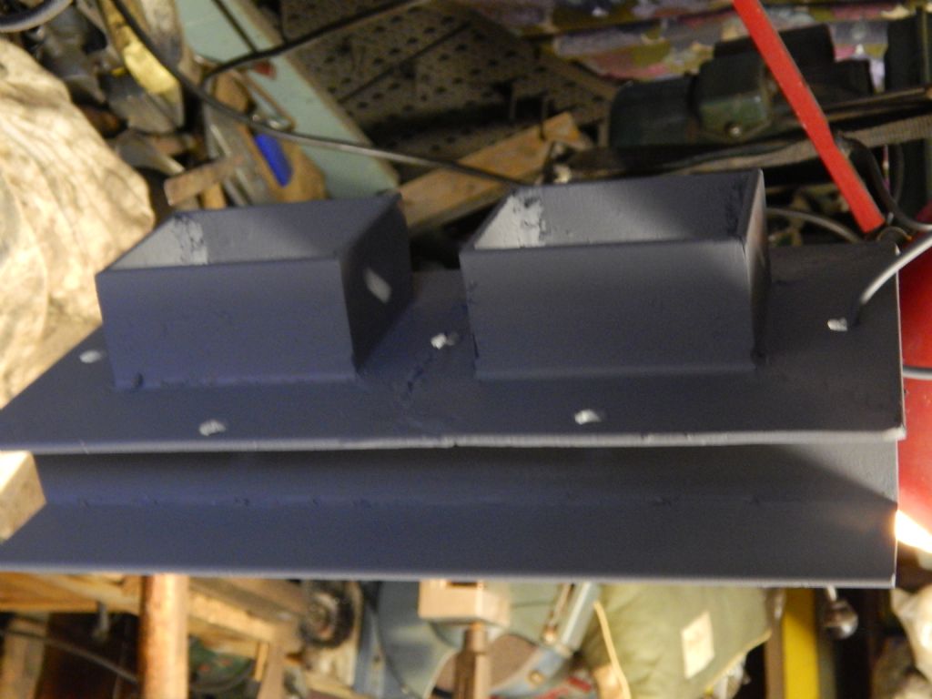

      Have been wondering what to do about the belt hitting the side of the lathe. I bought some 3/4 Plumber blocks and thought i would get a 19mm spindle and pulley . which is overkill, lol well my stuff usually is! . I thought about this but realised it would involve creating a bracket to hold it.
      I spent some time in my mess of a workshop today clearing it up as winter had given me a lot of small metal fillings. I suddenly had an apple fall on my head and thought about the cheap Chinese bearing which I had bought 10 of would bolt under the angle iron from underneath with a small 40mm pulley to pull it away from the lathe . This was by far much simpler, really do not know why i did not think of it before i brought the other 3/4 bearings. So I just need t o find a 40m v- pulley . Have found one which is 6mm bore but am hoping it can be drilled . If not I have a good friend who said he might make me one from billet to go on the 12mm shaft. Wont get this sorted till next week . Will go ABB i think with inverter reliability and working on a domestic supply is important

          i have been trying to make a pulley to clear the body of the lathe I was waiting to see how much space i had underneath

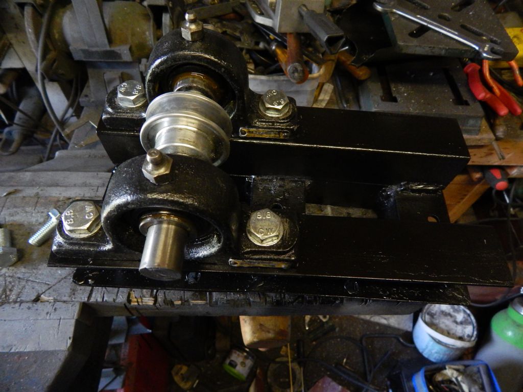

            Well it was sunny for a bit  and well decided to go for my big 3/4 bearings as the Chinese 12mm ones were to small and thought it looks more period with English bearings. Welded up the plate under the top surface to have another layer of angle to support the blocks. The main reason for this was that it covered the holes which it bolts to the Surface with. This new surface will provide room for the blocks to mount free of the mounting to the plate bolts . I could have bought spacers to do this but as I hate buying parts for something I can make I went for more angle iron which i already had spare.  Its a bit rough welding as not welding very well today for some reason . But its solid and that is the main objective..
            Edited By Martin Newbold on 26/03/2016 16:45:13

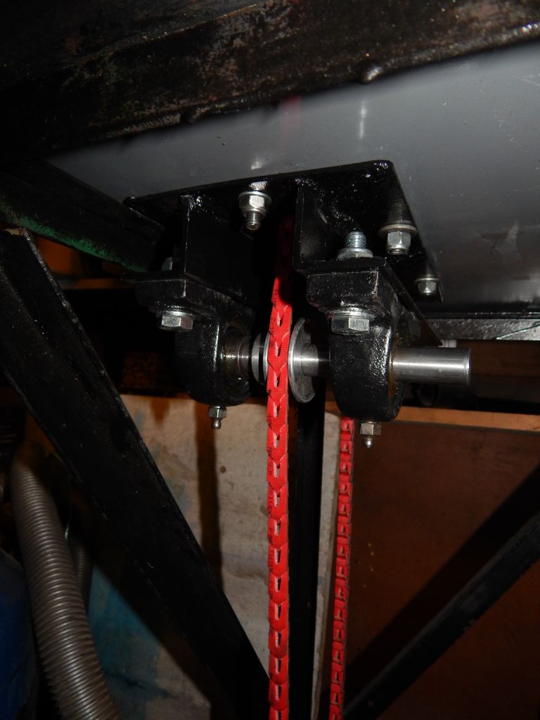

              Well have a got a bit further mocking it all up on the lathe . Still have to obtain a few parts like the pulley The new plate is great as it seems to give me enough location travel for the blocks to take a good size pulley

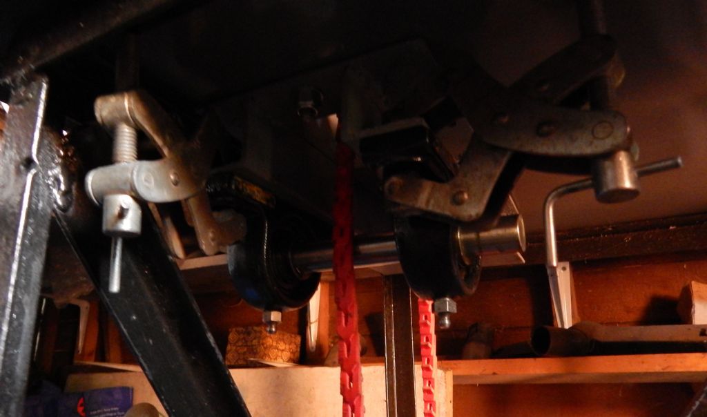

                Hi everyone . Finally received my small pulley today which was supposed to be 19mm 3/4" , hmm had a struggle with this to enlarge this initially to make it the same size as my 3/4 " shaft. Tried everything and eventually wrapped sandpaper around a drill until it was tight and rotated it until it was large enough to just fit. Mounted all of this onto my frame
                .I then mounted this back onto the bottom of the table and put the belt back on.

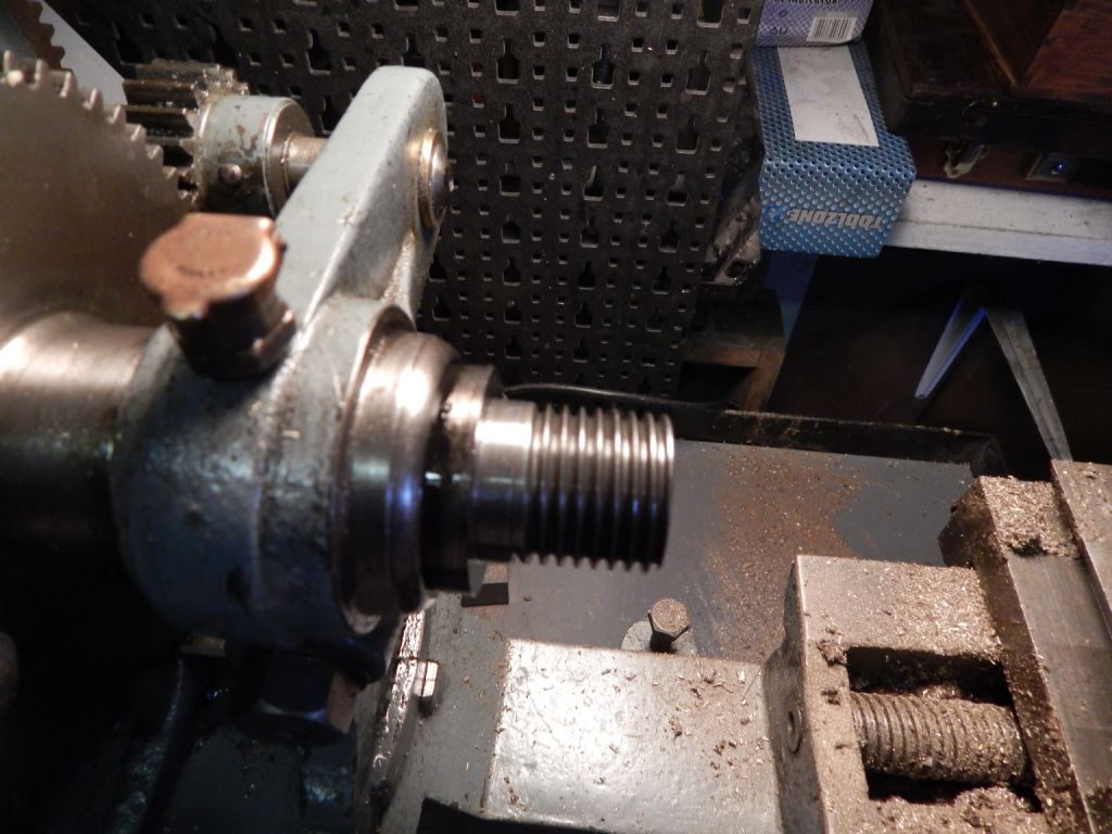

                          Martin,your lathe is a pre 1908 when the B series was introduced,is the nose thread the same as the B and if so I have a converter that I made which fitted over the drummond nose and has a thread above which carries a Myford thread.I used a ER collet chuck with a Myford thread and this made the lathe more useful.I also have a fine feed that attaches to the rear of the spindle and walks the gears over on an eccentic I think I have a a chuck with a B backplate ,The fine feed the adapter and the chuck you can have if you want them .I also have a Drummond taveling steady but I would want the same as I paid for it £70
                          Frank

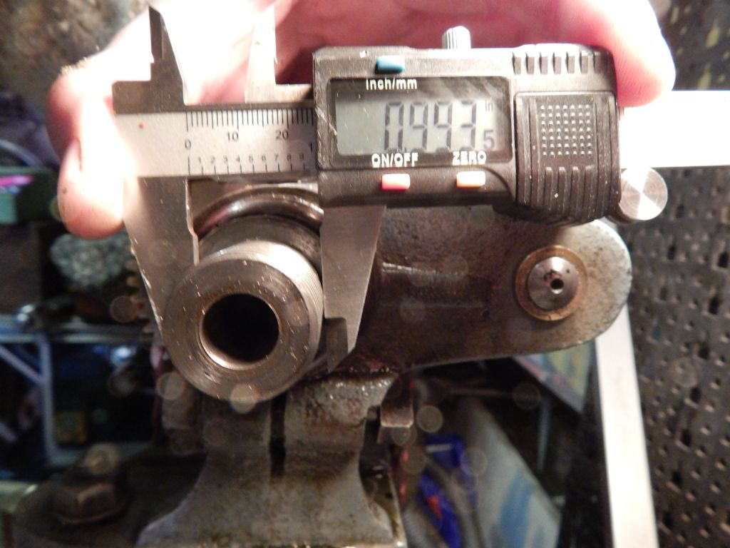

                                          Hi Frank , this is the spindle with the chuck removed. How did you make the adaptor for the myford sounds quite complicated. This is measured on the shaft the chuck slips over the other is .988"
                                          Here is the thread it attaches too
