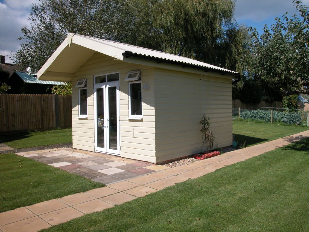

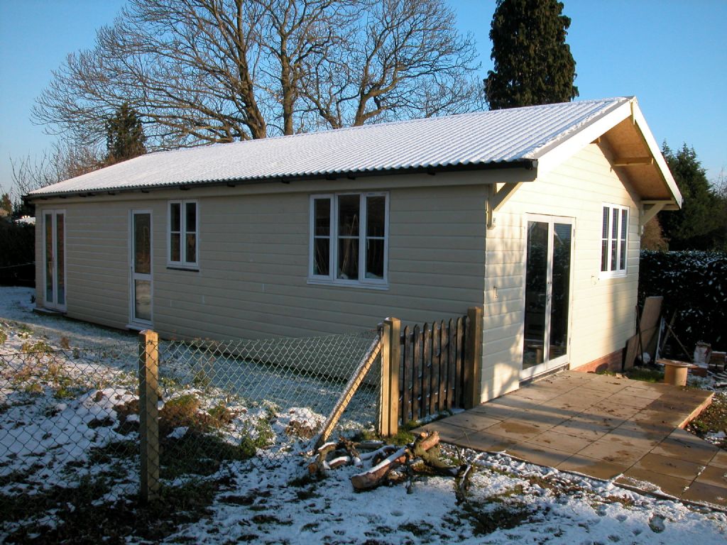

                                  Clive Foster
                                    @clivefoster55965
                                    Went through the good shed / log cabin kit research thing when doing an office / studio for my brother and workshop for me. Eventually decided to go DIY as getting a much better result for same money as a mid range (ish) log cabin kit. By the time you've priced in a decent slab sheds are, well, just sheds needing fair bit extra spend to produce good working environment. By which time you might as well do it better in the first place.
                                    Office / Studio 12 ft (ish) square :-
                                    Workshop 16 x 36 ft (with 8 x 10 garden shed section in back) :-
                                    Helped that a builder type friend was out of work at construction time and needed flexible work on a day rate.
                                    Proper slab with re-enforcement and insulation underneath. Brick edging to 1 brick over slab level before DPC. Wood frame on DPC membrane direct on slab is often unsatisfactory and pretty much unfixable if it does leak. Bin there, dunnit, swore a lot but it still leaked. Waterproof chipboard underfloor makes a nice tough floor. Left overs make excellent shelves, and benches for cold work, being a touch rough so stuff doesn't slide off. But you must edge them. I edged shelves with alloy angle to give a couple of mm lip and used stripwood on benches.
                                    Nail guns are fun. I bought a Paslode, with the amount of work I was doing worked out cheaper than hire. 4 x 2 framing with OSB both sides and insulation in between. Much warmer than shed style and keeps the noise in too. Tongue'n groove is just decoration. Windows and doors are household double glazing units. Found a local deal on over-makes for the windows, selected from half a field full! Complete with glazing at similar price to a wood frame in Wilkes / B&Q et al. Doors came out of the local free ad paper from folks getting new ones. The door-window combo I used on the front of the studio was £20!
                                    Building high enough, used all the 14 ft permitted for the workshop, to get a proper ceiling in gave useful storage space above. Make a big hatch tho'. Insulate between loft and ceiling and under roof. Doing both makes big difference. Proper electrics with dedicated consumer unit and plenty of sockets. Metal distribution boards screwed to the wall are a good way of doing things. Couple of weatherproof out side ones are handy, but provide a separate isolator.
                                    Decent overhang out front, one on workshop is too short, with hard standing underneath gives you somewhere to do dirty jobs in summer. Also if the orientation is right it provides a pleasant sun trap to sit out on nice day.
                                    Making a real nice job should give dispensation to up the budget rather. Easy to forget that if you are going to have anything reasonably satisfactory a fair bit of your spend is pretty much fixed whether you erect an improved shed or go for something rather better. Maybe I went little OTT but for that much work I wanted something good that would stay good for 30 years.
                                    Clive.
                                    PS :-  Looks like Bill and I were working off the same song sheet!.

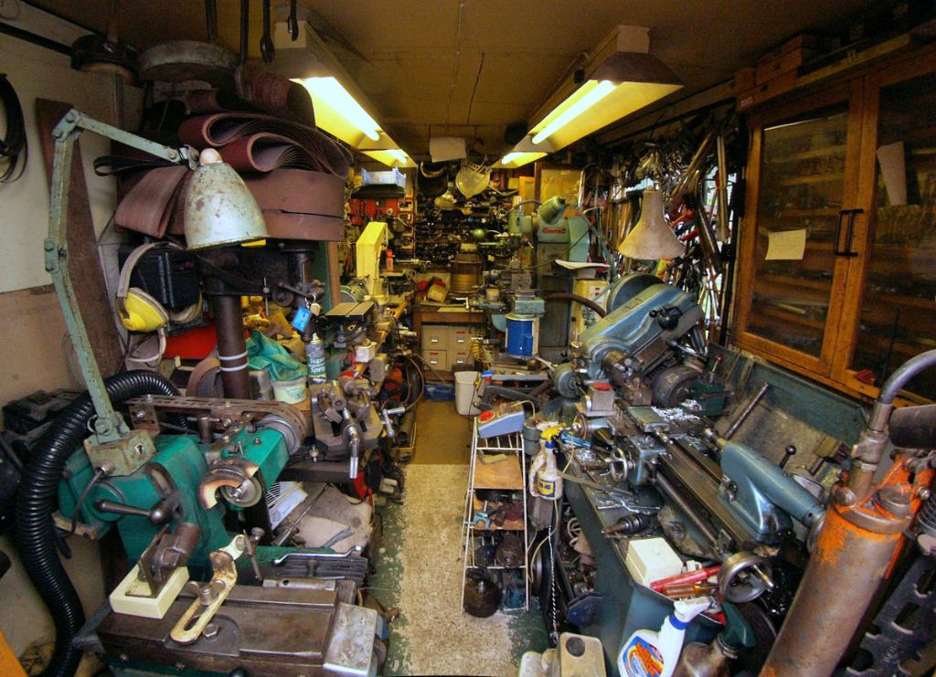

                                      Clive, looks like we has similar ideas, though yours if grander and prettier than my original one.
                                      Rather crowded as you can see, and obviously in need of a tidy and clean-up on that day. Not obvious in the photo, but there's a Dore Westbury mill at the back left and a bench with vice and the welding gear behind the Centec. Good job I have a fisheye lens for the camera, as there's little room to swing a mouse, let alone a cat.
                                      I like the idea of the extended roof, and wish I'd done the same, but my original build had a single pitched roof, sloping towards the front door, so couldn't subsequently incorporate one easily.
                                      A point for Colin though is that turning the extended roof into a verandah isn't included in permitted development, so one to watch there.
