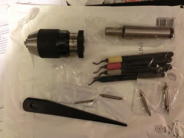

      #580269
      Roger Best
        @rogerbest89007
        smiley
        The arc chuck arrived Saturday, 13mm is a good compromise and they were in stock. I also got some bits and pieces to complement my improved drilling capability. Sunday was my birthday and the cheque from my Mum covered it, so I could say she bought me something specific and wanted even if she doesn't understand the attraction.
        I will have a play when I can get into the workshop, it needs some serious tidying, and the house is worse!
        The arc catalogue is terrific, it seems so much easier and impressive than their website, very helpful.
        #580630
        Roger Best
          @rogerbest89007
          crook mmm I might have got something wrong. The tapers don't fit very well but it took me a while to work that out.
          A quick video:
          How do I get the chuck and arbour apart?

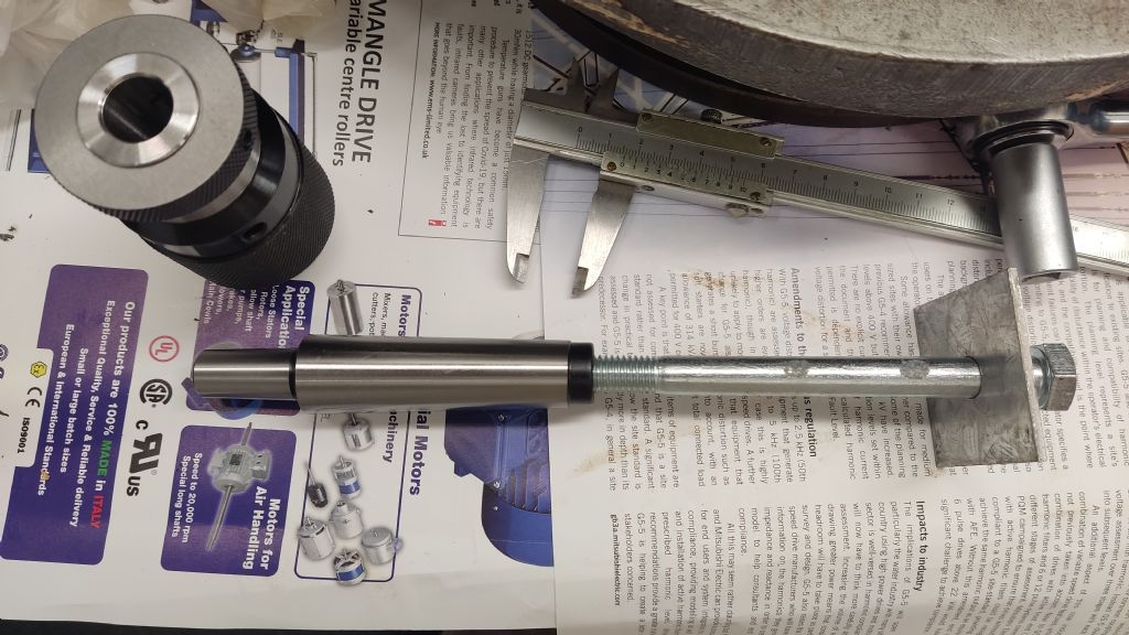

                          DiogenesII
                            @diogenesii
                            ..after talking about drills the other day, I think Rotagrip sells a B16 chuck wedge tool, but about £17 crying
                            If your arbor has a drawbar hole, sometimes a loose weight on a drawbar used it like a slide hammer will jar the arbor out if it hasn't been on for long – drill a hole big enough for the arbor in a block of some solid wood to 'back' the chuck.. ..remember the chuck will fall somewhere once it comes off..

                            Roger Best
                              @rogerbest89007
                              Thanks guys.

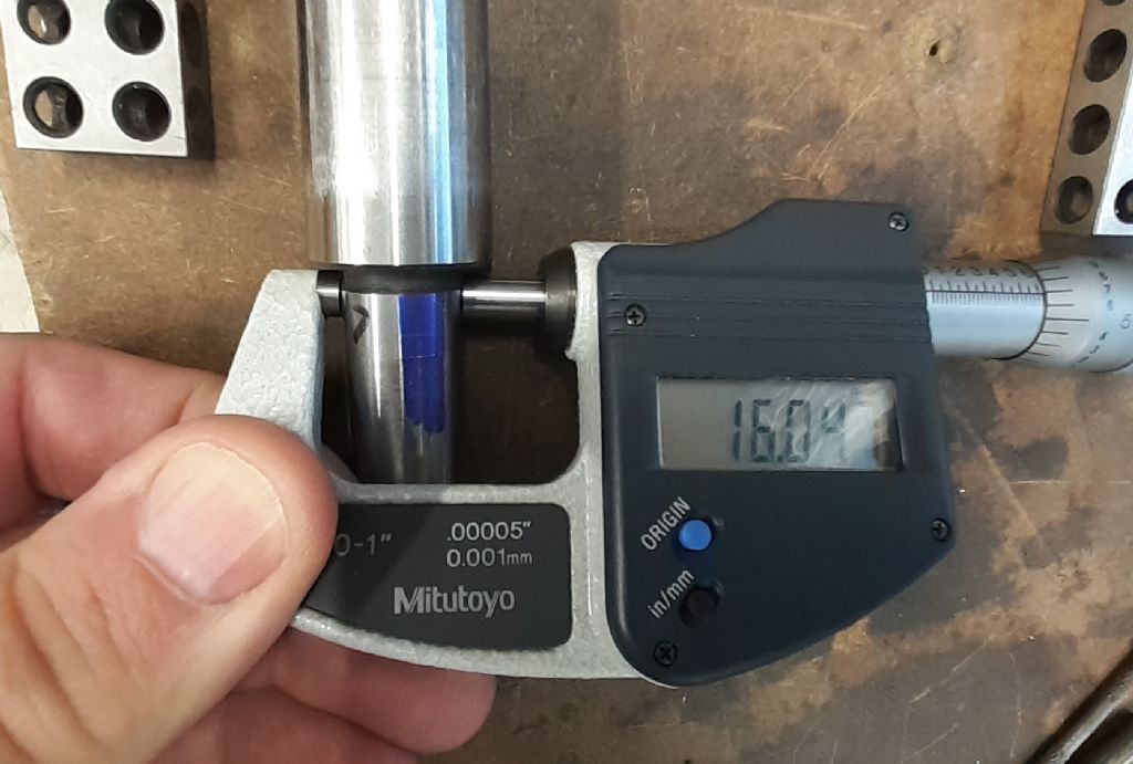

                              I only pushed the chuck on by hand and it hadn't been used so it came off easily with a tiny slide-hammer action. Bragging rights to DiogenesII. laugh
                              I measured the arbour diameter and its oversize, 16.0 v 15.7, chuck seems OK size-wise, so I have sent an e-mail with pictures to the vendor and hopefully we can speak tomorrow and they can say what they want me to do with it.
                              Not being properly seated would account for much of the excess run-out over the fancy chucks, its a matter of leverage and we are talking microns. That's great.
                              Edited By Roger Best on 16/01/2022 20:24:14
                              #580776
                                That sounds rather large, are you measuring it in the right place?
                                I have a couple here and the measure 16mm at the largest part of the taper but that is NOT where you measure. The dimension is at the gauge length which in the case of B16 is 24mm up from the end.
                                What runout are you expecting? I've already linked to the fact the £25 chuck is showing to be within the spec of a £175 Rohm top of their range or only just outside a £250 Albright.

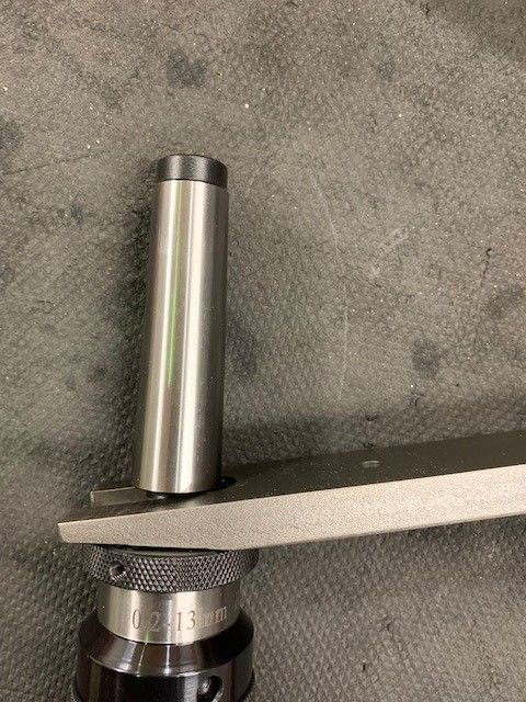

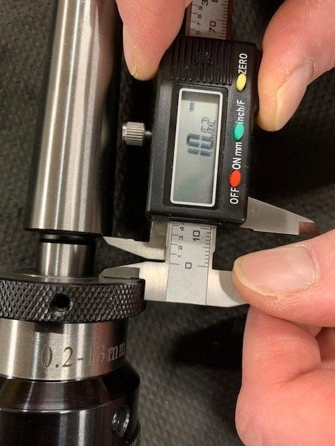

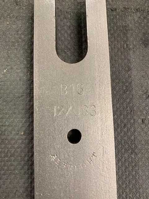

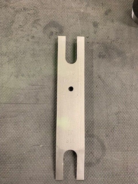

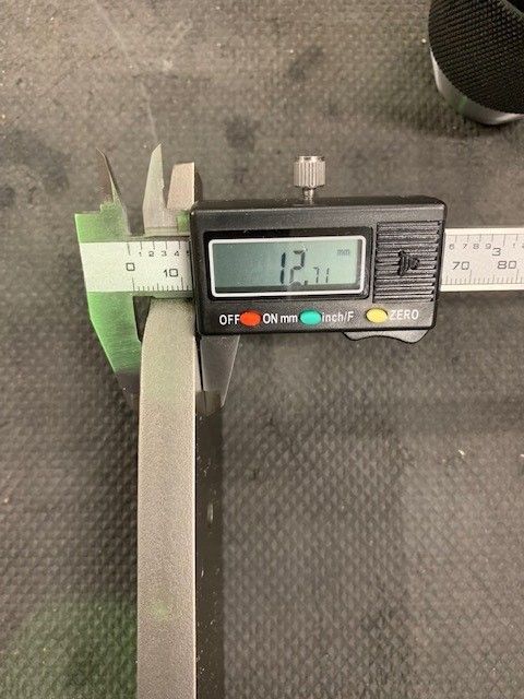

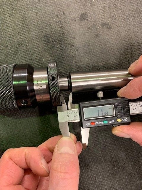

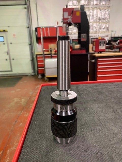

                                    Here are some rough and ready pictures:
                                    This picture is same as the keyless chuck you purchased, hand assembled:
                                    Rough measurement of the gap:
                                    Measurement of the gap after hitting (shocking) the arbor into the chuck with blow hammer… not ideal method, but just done for the purpose of these pictures:
                                    Overall picture of an Albrecht chuck removal wedge:
                                    Close-up:
                                    Albrecht chuck removal wedge in gap. The assemble is usually held in the mill, and a sharp blow with a blow hammer is used to separate the mating tapers. Picture just taken to show it in the gap (not usually used at an angle for removal). Usually held at 90 degrees… but good possibility of marking the arbor or the chuck, depending on how long the assembly has been in place…. more difficult to take off after longer period of time..
                                    Forgot to add… thickness of Albrecht wedge:
                                    Ketan at ARC.

                                      Journeyman
                                        @journeyman
                                        Interesting, I always thought that chuck removal wedges were used as a pair so that they remain parallel to both the arbor shoulder and the back of the chuck and avoid bending forces.
                                        I had a look at my collection of chucks and on many of these the back of the chuck is quite a way from shoulder in the arbor probably not such a large gap as the OP's but wouldn't work with standard (thin) chuck removal wedges without packing but would brobably be OK with the Albrecht ones.
                                        #580809

                                            They are used as pairs, much better engineering.wink
                                            Tony
                                            #580847
                                            Ketan Swali
                                              @ketanswali79440
                                              Posted by Tony Pratt 1 on 17/01/2022 12:36:23:
                                              Posted by Journeyman on 17/01/2022 11:42:38:
                                              Tony
                                              The Jacobs style 'thin wedges' are sold and used in pairs.
                                              I have observed the thick Albrecht ones being used as singles as well as pairs. Although it feels better for the Albrecht ones (or any other) to be used as pairs, sometimes these wedges are too thick at the slimmest part to fit into the gap in between the chuck and the arbor. I guess it depends on the application.
                                              Many moons ago we purchased the Albrecht ones for use in our own workshop (now mothballed) in singles rather than pairs. We also used pairs of the jacobs slim style, and we made a few of our own… all depending on application.
                                              We stopped selling the slim wedges a couple of years ago after the maker closed down.
                                              Ketan at ARC
                                              #580860
                                              Ketan Swali
                                                @ketanswali79440
                                                The reason why we had different wedges in our workshop was for the purpose checking different chucks on arbors.
                                                Question for those who may know: In normal use environment, why would people need these wedge/s?, unless the JT/B taper is a permanent part of the spindle, or the wedge/s are being used in a muti-tool type assembly… such as the one used in a multi-purpose live centre set.
                                                I mean, once the chuck and arbor are assembled correctly, why should there be a need to take the assembly apart?. If the chuck becomes faulty over time, it should be cheap enough nowadays to buy both the chuck and arbor NEW, doing away with any damage when taking the assembly apart.
                                                Ketan at ARC
