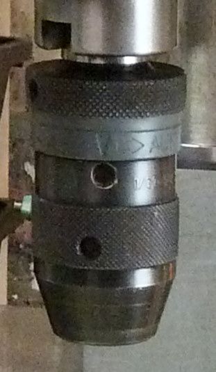

                        Macolm
                          @macolm
                          Note there are "reverse lock" keyless chucks. These have a ratchet that prevents loosening, released by a ring at the arbor end. Though not particularly useful on the lathe, I would not be without one on the mill. It is secure enough to grip milling cutters for spot facing, though of course not stiff enough for actual milling.

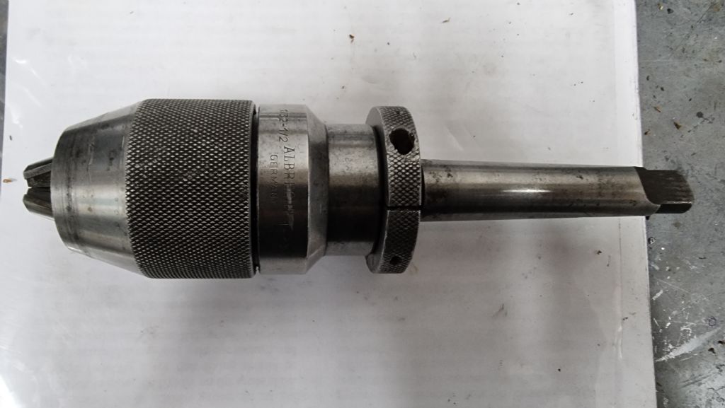

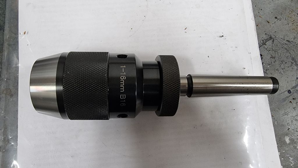

                          Steviegtr
                            @steviegtr
                            I have a Albrecht from a friend at car booty for £10. My go to & great for all jobs. But they do come loose if you try back out a tight tap. I also bought a Chinesium version which is pretty accurate. I can also vouch for the arceuro arbors. Had a few & all have been spot on.
                            Steve.

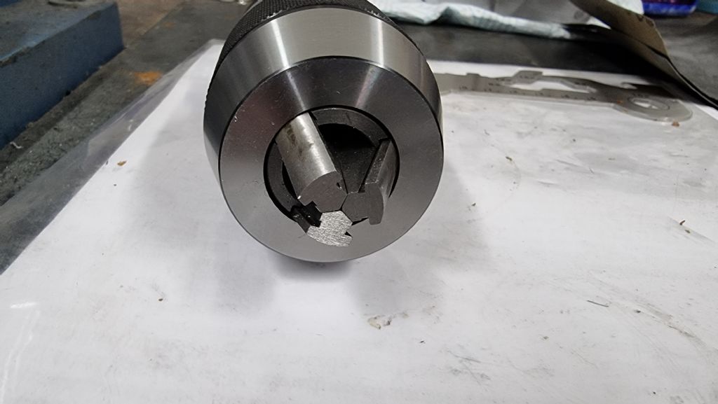

                                #577664
                                Emgee
                                  @emgee
                                  In the picture posted by Steviegtr of the 1-16mm chuck if the arbor is fitted to the chuck then I would be concerned with the amount of clearance between the back of the chuck and the spindle.
                                  Seems to me the diameter of the taper is too large at the big end.
                                  Emgee

                                      #577689
                                      Macolm
                                        @macolm
                                        Most of the annoyances of ordinary keyless chucks can be much reduced by the reverse lock type. Here is what a Rohm model looks like, I think it is 1.5mm to 13mm and is a thread mount. You can see the lock ring with release direction arrow. I made up the arbor to minimise the height, which is little more than a key type.
                                        Operation of the locking ring is very intuitive, scarcely noticed once you are familiar with it. In fact, the chuck is sold primarily for impact use on a portable drill, but is made to a high standard, and concentricity is excellent. It does have holes for C spanner release, but this has never been necessary in ordinary use on the mill.
