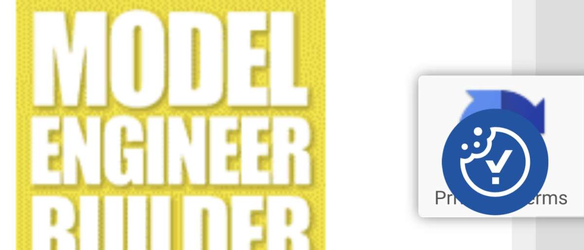

          Alan
          I’m not sure if it displays like this for everyone … but on my iPad the icon at bottom-right is actually two icons overlaid !
          The cookie settings icon  being pasted on top of the reCAPTCHA
          [only on this site could that be considered unsurprising]
          They serve two different purposes.
          IMG_9692

                              MichalG seems to have it correct. Two icons are overlaid.

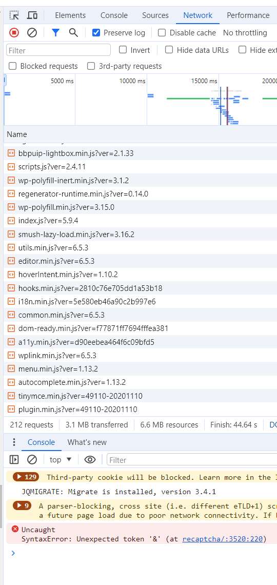

                                        jaCK Hobson
                                          @jackhobson50760
                                          This site is going to be an effort for old browsers on slow hardware and poor internet connections.
                                          Some people might find this interesting… the sort of thing I bet MichalG could lose a day in:
                                          IF in chrome, use developer tools F12 to inspect all sorts of fun info.
                                          If you do a ‘clear cache and hard reload’ then you can see all the stuff that gets loaded in the Network tab:
                                          Screenshot 2024-06-01 115517
                                          212 individual requests for items to draw a single page! 3Mb of transfer which is twice that when uncompressed.
                                          An awful lot of that is javascript. All sorts of javascript needs to be parsed (to see if it needs running) and then maybe some if it needs running. Anyone on IE is going to feel pain… but not sure why anyone would still be using IE!
                                          It is probably pretty greedy on memory as well. If you have lots windows like this open in chrome and you ‘only’ got 4 GB memory then things might start to slow down.
                                          Pretty typical of a marketing site that is maintained by WordPress Content Management System. Incredibly inefficient.
                                          Lots of that static content might be cached… locally at browser, and also on the web somewhere (cloudflare) to help with network speeds. So things should speed up after first page load, but javacript will still need running. Depends on detailed cache preferences/settings.
                                          Unlikely to be server table locking.

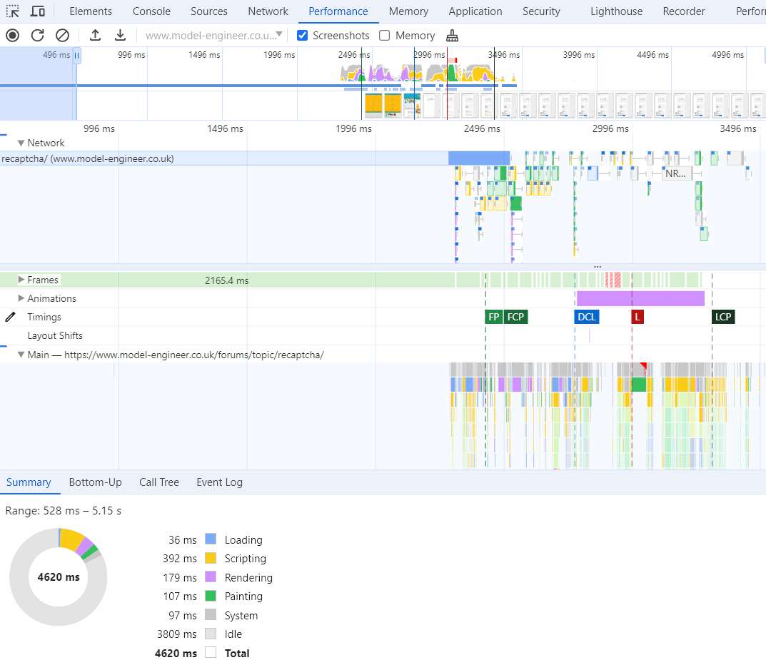

                                          #733645
                                          jaCK Hobson
                                            @jackhobson50760
                                            The first response time is pretty slow – just wating for the first response after the first request. 2 seconds delay.
                                            After that, the page is pretty complicated. So for me, I just get the 2 second delay as my computer can chug through it fairly fast.
                                            That 2 seconds is either beacuse server spec aint great, or just too many plugins.
                                            The ‘performance’ tab gives a good breakdown:
                                            Screenshot 2024-06-01 122732

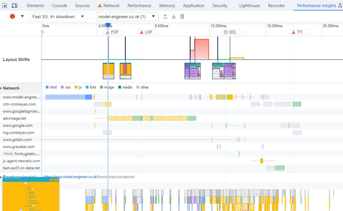

                                            jaCK Hobson
                                              @jackhobson50760
                                              Go to ‘performance insights’ and you can emulate a slower network (e.g. mobile 3G) connection or a slower computer. 4x slower computer than mine makes javascript even more significant that waiting for server:
                                              Screenshot 2024-06-01 123331
