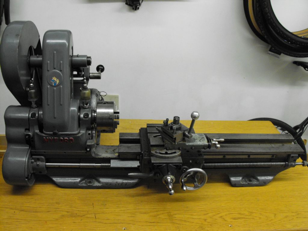

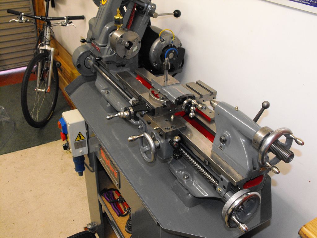

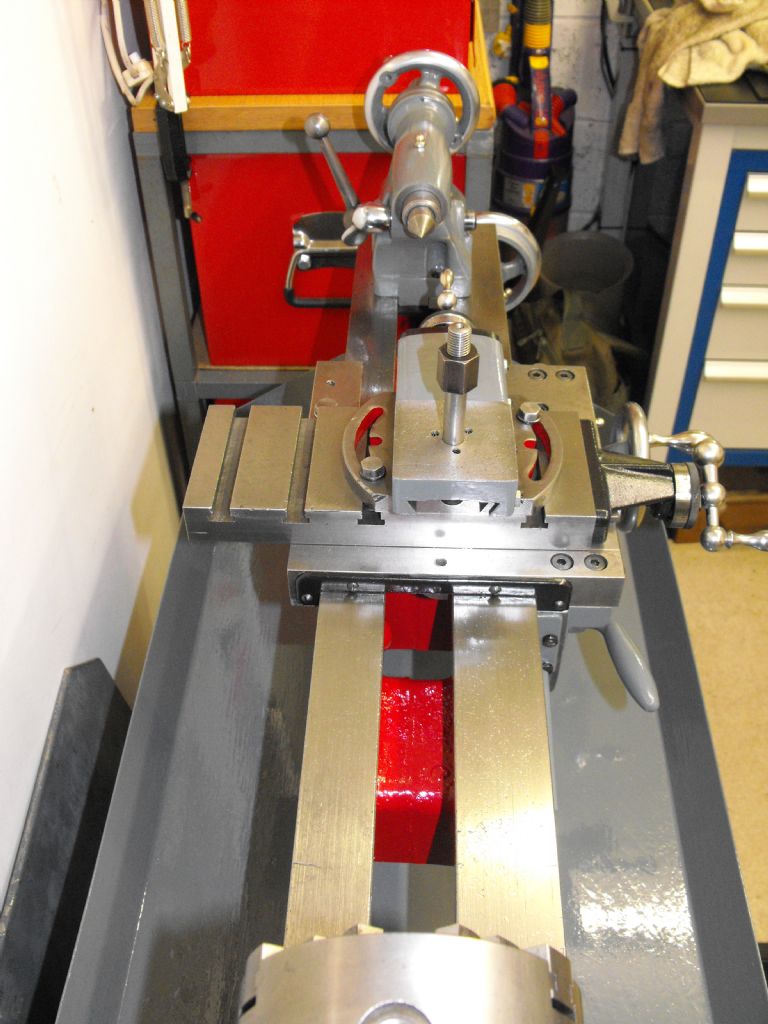

      So I joined the forums a few months ago and said I would post some pics of my first ever resporation project when complete. 1978 vintage, fairly well looked after, if a bit rusty in places. I replaced all the bushes, new shims on slideway parts. The slides were a bit rusty they were not worn, so just cleaned those up. New dials, oilers and reblacked most of the fittings.
      Very enjoyable project and highly recommended if yours is looking a little tatty.
      Still havent used it as waiting to get a quick change tool post. However problem is now I'm so so tempted to sell and buy a Super 7B to overhaul.

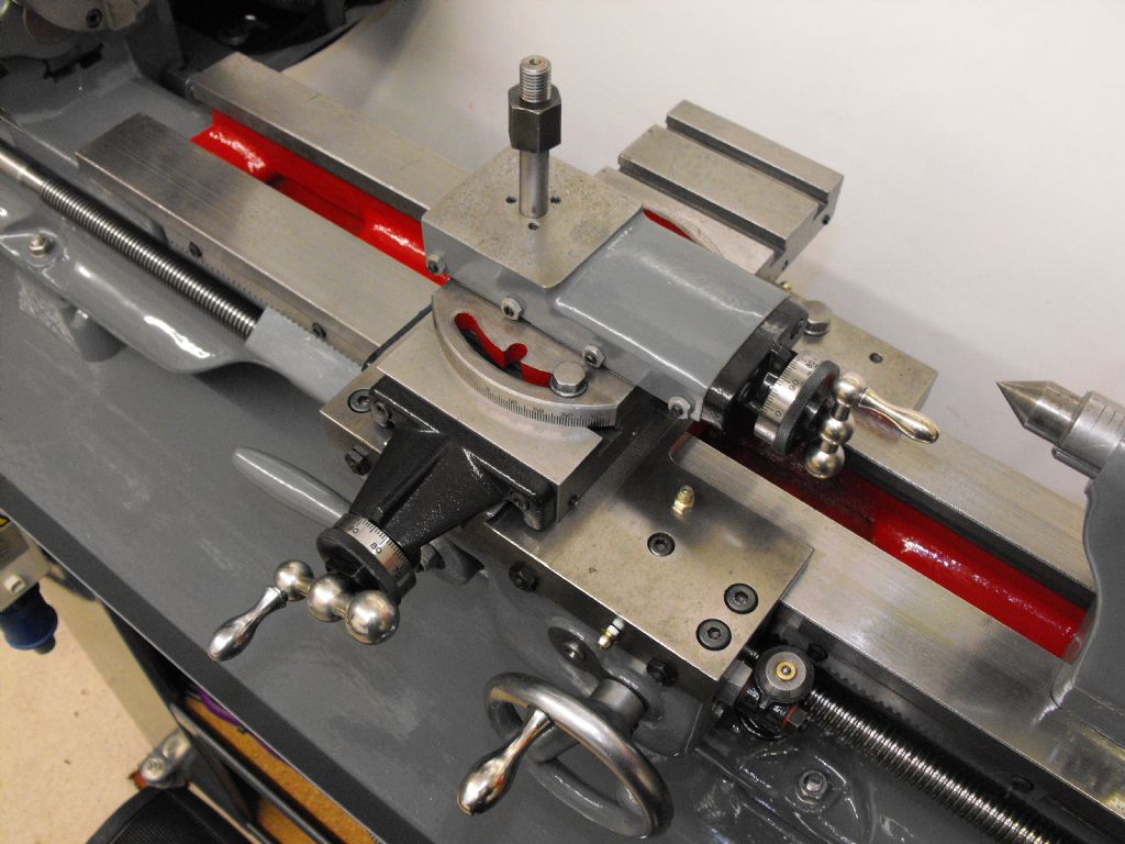

          geoff walker 1
            @geoffwalker1
            Hi Phil,
            Yes a lovely job that mate, totally agree with Nick.
            I like the cross and top slide dials. Did you make them?
            geoff
            #307962
            Phil Boyland
              @philboyland37326
              Thanks chaps. Dials are the current offering from Myford, Resettable zero versions!
