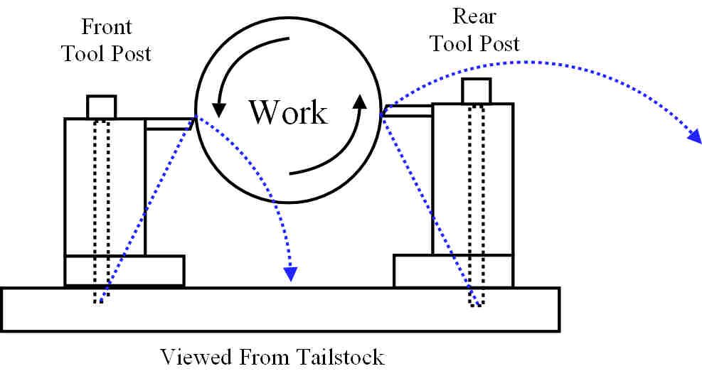

                                                @davidhaythornthwaite90386
                                                Regarding Ian’s comments, yes of course all rear mounted tools are normally mounted upside down. I am using the Q cut upside down on a REAR MOUNTED QCTP hence the need to mount it lower in a QC holder. I agree with you that it is simply a matter of geometry. At the front, any dig in forces the tool downwards, but as the fulcrum for this movement is further away from the work than is the tool tip then the downward movement also forces the tool forwards into the work making the dig in worse.
                                                With a rear mounted tool. a dig in lifts the tool and as the fulcrum is now nearer the back of the machine than is the tool tip, the lifting action is now causing deflection AWAY from the  work, releasing the dig in.
                                                I do not agree with Chris Stephens that at centre height the effect is the same front or rear.
                                                He asks if there is PROOF. I would say a resounding YES The proof is that it simply does work better at the rear. If you have a Colchester or something of similar rigidity, the effect is less noticable, but certainly on lighter type of lathes like Myford. It simply works better.
                                                David H

                                                  #44231
                                                  David Haythornthwaite
                                                    OK Meyrick we shall have to agree to differ on this one. I am still convinced that the effect shown on the attached illustration has a lot to do with it. I rest my case.
                                                    David H
                                                    #44235
                                                    Michael Cox 1
                                                      @michaelcox1
                                                      David, I agree with your analysis why rear toolposts are better for parting. Your drawing is excellent.
                                                      Mike
