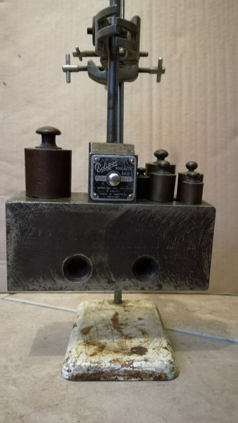

                          Nicholas Farr
                            @nicholasfarr14254
                            Hi Rob, this is my Eclipse magnetic base, I don't know exactly how old it is or how strong it was to start with, but I know it is more than 50 years old and it is hanging on to 7Kg without any sign of letting go. It has never been serviced in that 50 years, so I agree with JohnF and the surface finish it is holding, looks the same as the one in the facing view but not as wide.
                            Regards Nick.
                            #553505
                            Peter G. Shaw
                              @peterg-shaw75338
                              Please may I piggyback on to the original question?
                              I have a push button magnetic base similar to the one on Nick Farr's photo above, even including the sloping part on the top. But, it isn't an Eclipse. In fact it doesn't show a manufacturer. But it does have a label fastened just as Nick's is, and on the same face too.
                              Anyway, to cut the waffle (!), mine can be very stiff to operate, so much so that I have, at various times, removed the front label (and glued it back on!) and sprayed WD40 inside and outside, ie around the push button in an attempt to free it off. This, I must admit was well before I learned about the negative aspects of WD40, so please don't bother telling me off. So, the question is, therefore, how can I ease the button operation such that it doesn't almost involve a thumb dislocation. FWIW, I have two other magnetic bases, both lever operated, and both being much easier to use. Incidently, I don't recall the WD40 having much of an effect, hence I now just put up with it's stiffness to the extent that rather than switch it off, I use brute force to remove it from wherever it has been used, and keep it on a piece of 6mm thich steel plate with a piece of polythene between the magnetic base and the steel plate.

                                  #553666
                                  Nicholas Farr
                                    @nicholasfarr14254
                                    Hi Peter, my Eclipse one has and always has had a stiff kind of operation, but I think there maybe a spring inside as it will not stay in the switched on position unless it is on a surface that will keep a magnetic circuit of a sufficient level, i.e. it will not hold onto a rough surface, slightly uneven or a small area. I've no idea if any oil will help with yours.
                                    Regards Nick.

                                      #553714
                                      Peter G. Shaw
                                        @peterg-shaw75338
                                        Nick & Philip,
                                        Thanks for that confirmation – it is nice to know that I am not alone with this problem.
                                        Nick,
                                        I don't have any sort of problem with it maintaining the "on" position. Nor do I have any problem with it not holding on rough etc surfaces. I do have a slight problem with the power of the magnet as it's not as strong as the two lever magnetic bases I have. But it's usable with care.
                                        Right then, as I mentioned two posts above. An experiment will shortly be forthcoming. Remove the label, perhaps a good clean with paraffin and then a soak in possibly some "68" oil I bought for the lathe slides. If I can get on with it (note the careful avoidance of the "round tuit" there!) I'll see about setting it up this week – provided my poor old clapped out, cream crackered body can be persuaded to withstand a bit of light work. And then I can leave it until mid-August, ie after 2 weeks in the caravan. Yay-hay!
