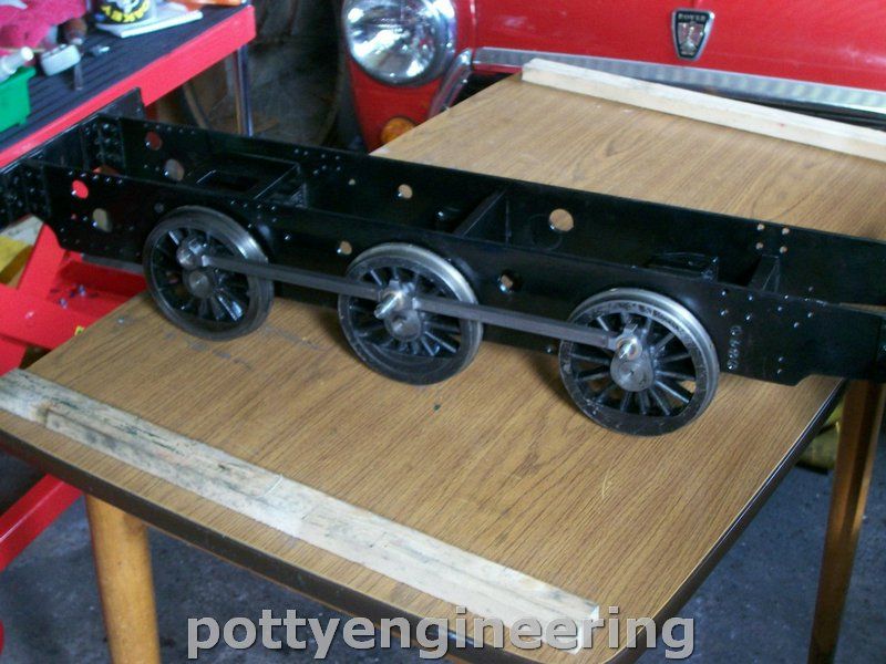

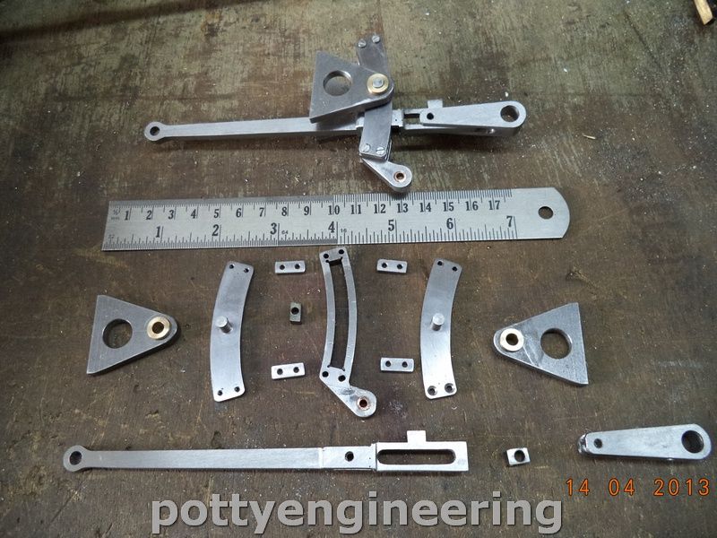

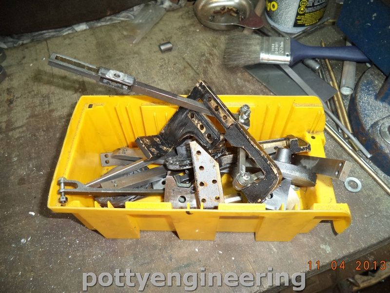

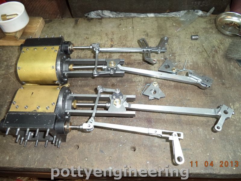

        Last year I Bought a part finished Simplex Loco, it came with a boiler certificate and was more or less complete I could see that the maching was a bit rough but thought that could be tidied up. But when i got it home a started to strip it down a realised that the build standard was very rough, and as i wanted a loco that would be a reliable runner, I would have to extensivly re-work it, to date I've:-
        Recut the horn blocks
        Remade the frame streachers to get things square
        Made to axles, and axle boxes, made new crank pins, and re quartered the wheel.
        Made new cast iron pistons and fitted psiton rings, and more or less remade or the valve linkage.
        Loco as bought
        Re-built frame with new axle boxes axles and re-quarterd wheels, and new coupling rods
        Remade valve gear cylinder and steam chest are one of the few existing bits left.
        Box of rejected parts
        New expansion link assembly
        I'm beging to think it would have been easyer to make complete from new )
        Any way I'm beging to weary of it so I'm going to give it a rest before I start on the home streach, and make a Simple Horizonatl Mill Engine that I've drawn up I've designed it so that it can be made on a lathe and a drill there is no milling required.
        Cheers
        Stew

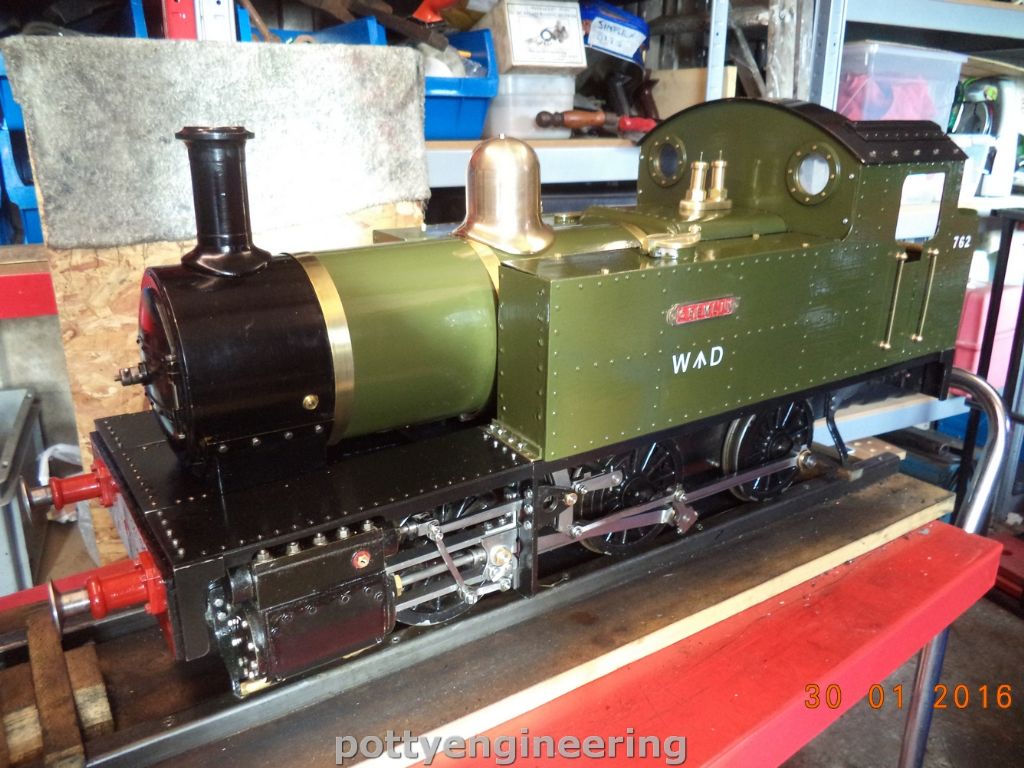

                                      Well after many trials and tribulations I've eventually got the Simplex in steam.
                                      It won't win any Beauty contests but its seems to run well.
                                      Stew

                                              G'day John
                                              I use a Siege X4 mill
                                              As for the Simplex I kind of rushed it into steam last year so I could run it through the summer which I did very successfully, I got enough driving hours in to take the clubs driving test and passed out as a driver so I can now give rides to the public and use it at children's birthday parties which I did towards the end of the running season.
                                              I've just spent a couple of months tidying it up, the water valve for the injector got in the way of the pole reverser so that was swapped over to the other side, I added some hinged lids to the water tanks, and I discovered that the rivets for the tank were steel so I was getting rust on the inside of the tanks so they were treated to two coats of paint, and the paint work was generally tidied up and I added a couple of transfers. So I'm know itching to get her on the track again as sson as the weather improves (will it ever stop raining).
                                              And I gave her a name:-  GREMLIN
