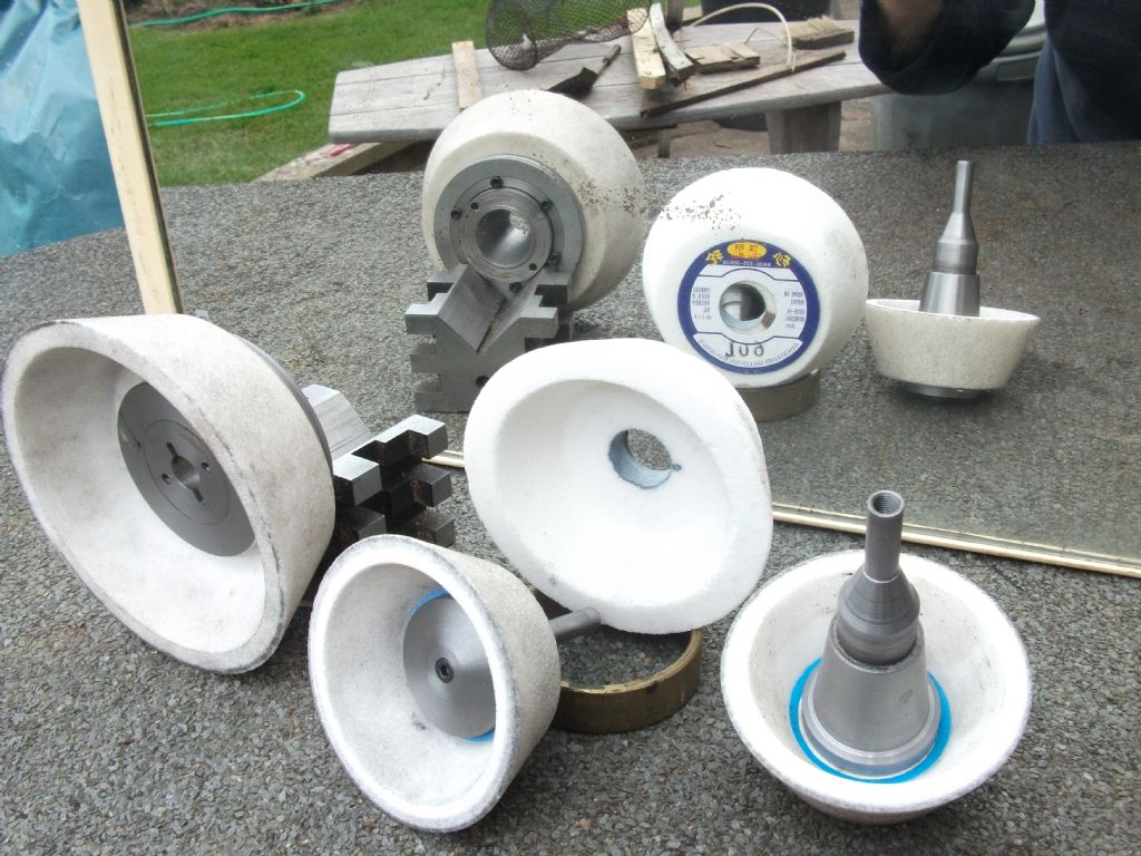

                                    #598126
                                    John P
                                      @johnp77052
                                      Buying a reputable make or from professional suppliers is no guarantee of getting a good
                                      wheel these days.
                                      The wheel seen here on the left is a Norton wheel from RS not cheap ,the mounting area
                                      was like a rollercoaster track ,the balance was poor but easily corrected when mounted
                                      on this heavy hub ,the centre of gravity is moved to the back of the wheel where there are
                                      two balance rings to even things up .
                                      The other three wheels here all from China all cheap and very well made without the
                                      problems the Norton wheel has , the 2 Quorn wheels are perfectly balanced as is.
