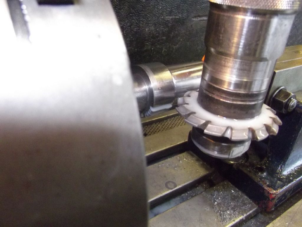

                            Bernard Wright
                              @bernardwright25932
                              This is an Involute Gear Cutter from RDG, I'm using it on a shopmade arbour and didn't notice any eccentricity, maybe that was the reason..blush
                              The material being machined was En24T with coolant, worked extremely well, the wormbox gear is for my Son's Bantam.
                              Bernard

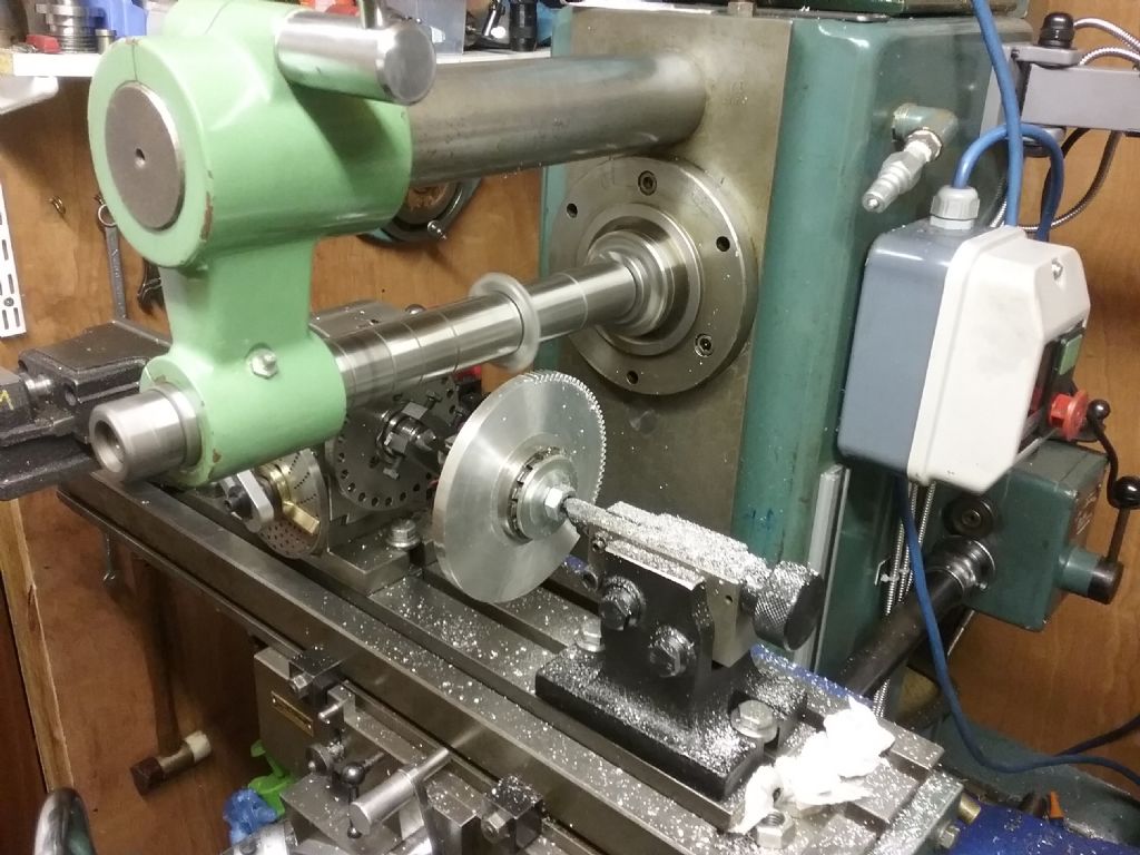

                                        Anonymous
                                          Posted by Emgee on 27/01/2017 19:26:47:
                                          Have you got power on Z axis, if not that's a lot of handle turning !!!!
                                          Dunno about Richard, but a serious amount of handle w**king in my case; six gears times 72 teeth per gear, and 24 turns of the handle per tooth:
                                          Andrew
