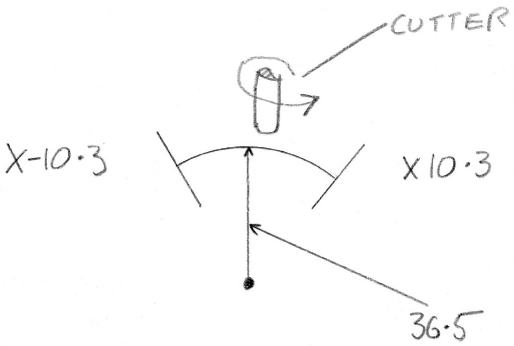

        Being an old school G code programer I've never embraced CAD/CAM but wouldn't be without the conversational programing my control offers. I now need to machine an upstanding arc, with its centre at Z-36.5 the arc starts at X10.3 and finishes at X-10.3 (there is no Y motion involved) Having had a look at the manual G18 would appear to be prefix before G02/3 with the arc values signed by I & K. I've tried different combinations on the graphics but nothing runs. Can anybody supply a template for a ramping arc, (that runs) where I can fill in the values.

          Unless I'm missing something I'm having trouble seeing how you would machine an arc that steep ?

            I not making myself clear. the arc centre is at Z-36.5 the arc itself would start some where around the Z-3/4 mark at X10.3 then a gentle sweep to X0 then on to X-10.3

                OK got it, my bad, sorry.
                Only way I can help is to show you a bit of code that I did back in June 2006 according to the code.
                This was similar to the rocking boat type toolholders but was massive, about 100mm square and 224m long, again according to the code.
                I'm presuming the K862.76 was the radius as it was only a shallow curve and from memory this was opposite to yours. i.e. concave instead of convex.
                Hope this helps.

                  Thanks John, I'll try altering the values and see how I get on.

                    Took out the G44 & G49 and it seems to work on the graphic screen, I'll try a dry run on the machine when I reach a suitable stage in a couple of days, its a starting point anyway. Thanks.

                      OK the G44 is specific to my machine . It's the tool length offset which on most is G43. G49 just cancels this.
