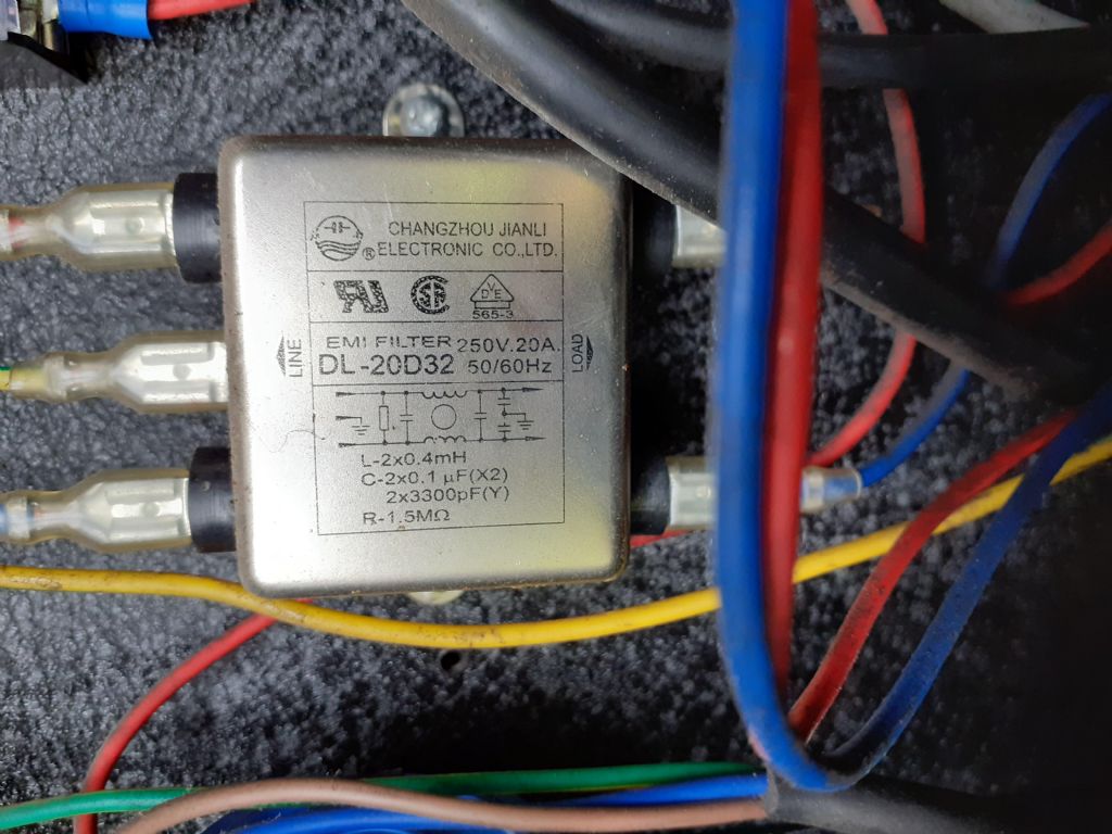

                        Matt Harrington
                          @mattharrington87221
                          Well, I thought I would have shufty inside the dark corners of the Syil control box. Low and behold was an in-line EMI filter,EMI filter in Syil control box
                          Can I assume that this is faulty considering the above problems? I'll order another unit (cheap) and see if it has any effect.
                          Matt

                                      Dave Halford
                                        @davehalford22513
                                        Matt, I was wondering about continuity of earths, power supplies have a degree of earth leakage. For instance you filter diagram shows two earths, one from the mains the other must be from the filter case otherwise the load side has no earth connection.

                                            Posted by Dave Halford on 15/02/2021 16:44:53:
                                            It's just a diagram thing. Usually both sides are earthed inside to the metal case. As its purpose is removing muck from Live & Neutral, it's not unusual for filters to only have one earth tag. The safety earth might be provided by bolting a filter to the metalwork, but more likely it's done somewhere else as well.
                                            The problem may be at the receiver too. I have at least 3 FM/DAB radios where the input filtering is pathetic! It might be necessary to put a filter close to the radio's mains input, which is often easiest to do by looping the cable several times through one of Duncan's toroids.
                                            There are filters and filters! The one shown in Matt's picture is reasonably good but not exceptional. It may not be effective at the frequencies zapping the radio. Rather than replace it, I'd put another one in.
                                            Matt's evidence suggests his radio's mains lead is playing a part. It could be feeding muck fed from the CNC along the wires, or the mains cable could be acting as an antenna and receiving transmitted waves. Either way, a mains filter close to the radio should stop unwanted signals penetrating it's sensitive innards through the power cable.
