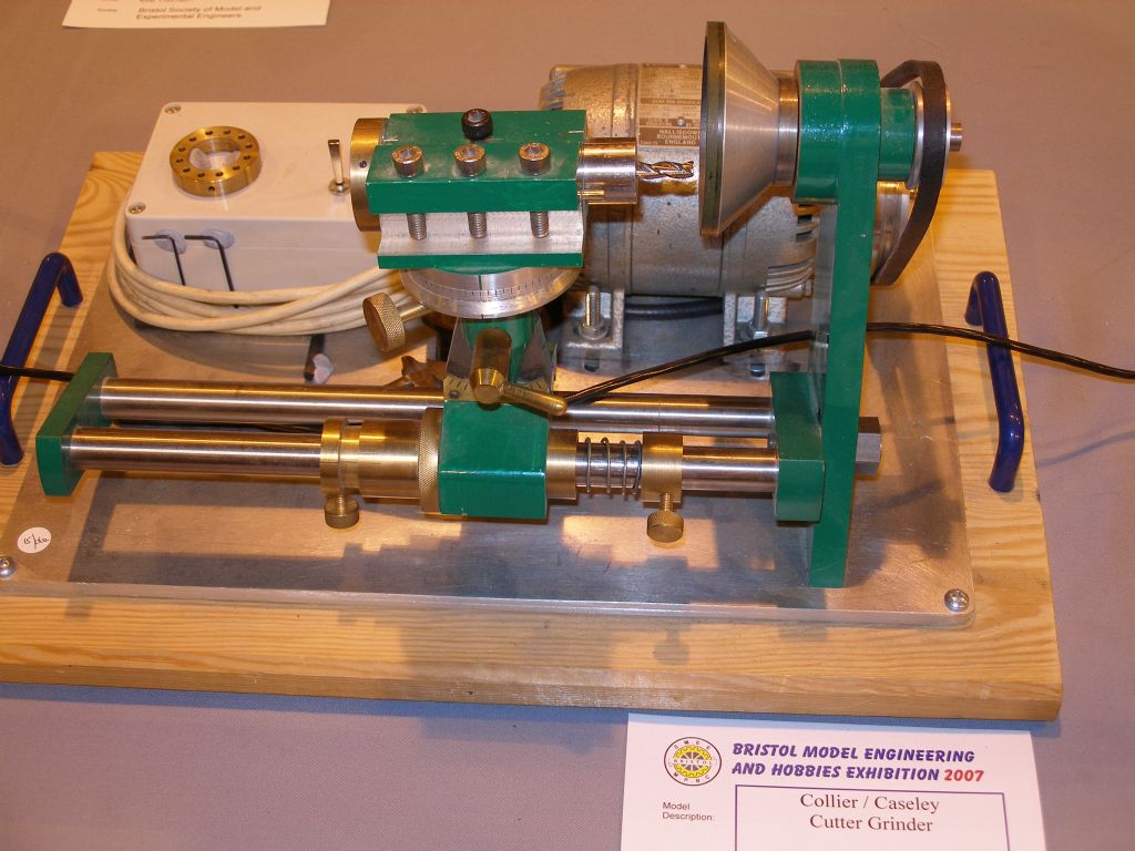

              Hi There
              The next MEW has an article on a superb little cutter grinder.
              Looks easy to make.
              Designed by a couple of people in the Bristol Society.
              I will be making one.
              Drawings will be available from the Bristol Society for £12.50.
              No castings are needed.
              regards David

                      Posted by David Clark 1 on 10/06/2011 15:44:55:
                      Hi There
                      Looks easy to make.
                      regards David
                      Edited By David Clark 1 on 10/06/2011 15:45:45
                      David, I noticed a couple of potential issues abut the pictured grinder, based on my tool design experience.
                      1. the spindle bearing support is VERY short. This could lead to excessive wheel runout very quickly, and inaccurate grinding. longer spindles with a good distance between bearings (usually 4 x shaft dia min is a common rule of thumb in NA) are better
                      2. I hope way rod covers are planned or there will be very rapid wear of the rods, especially with bronze bushings riding on them.
                      3. belt looks undersize.
                      4. guard for belt is missing. machine is unsafe without a guard over the belt.
                      5. machine looks “wrong handed” unless it’s for a lefty operator. If I’m looking at the back side in the photo somehow, the motor will be in the way of normal operation.
                      6. control box is right in the dust (not good for electronics) and behind the spindle. (dangerous to get to in an emergency)
                      JD
                      Edited By Jeff Dayman on 10/06/2011 22:27:43
                      #70107
                      David Clark 13
                        @davidclark13
                        Hi There
                        You can make it which ever hand you wish.
                        I would reverse the hand I expect.
                        You can lengthen the bearings and fit way covers.
                        Buy whichever belt you want.
                        The box looks sealed and is well clear of the motor.
                        Feel free to fit guards.
                        Finally paint it
                        Green
                        regards david
                        Edited By David Clark 1 on 10/06/2011 23:22:27

                            GoCreate
                              @gocreate
                              David
                              I think that looks a great project, a much faster and easier build than the Quorn. It’s ideal for the begiinner as there is plenty scope to easily add your own variation and “improvements”.
                              It’s easier to use ones own expeience to modify a design, it’s much more difficult to orgininate a design (and keep everyone happy).
                              JD. part of the satisfaction is to add your own stamp onto a project, this design is an ideal starting point for developing your own inventive skills and ideas. I don’t think ME needs to be concerned to much about intimate detail, leave it to the hobby to develop the initial idea as each individual sees fit, beginners will learn from that discussion and experience.
                              I think it looks fine as it is and will do the job intended.
                              My variation would be to raise the bed and have the motor underneath and perhaps use a poly vee belt and yes, make it right hand. May be I will make an epoxy-concrete base just for the experience and joy thanks to another thread on this forum.
                              I am sure there are plenty ideas to share.
                              Cheers
                              Nigel
