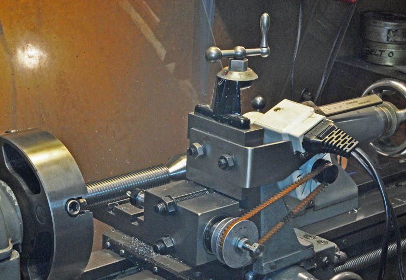

                                  I think the great advantage of the Quickstep is that it is quick to mount and dismount which makes it attractive for doing small jobs in the lathe that would require some setting up on the milling machine. My system is not quite so neat but, nevertheless, I use it pretty often. The red mark on the (non-adjustable) dial shows the reading for true centre height and I use it at this setting for 90% of the time. Power is a 120W sewing machine motor and the spindle is an Arrand unit. I have drilled an additional pair of holes in the base of the vertical slide so that it can be set parallel or perpendicular to the lathe axis. An ER11 chuck lives in the 1MT of the spindle and I use this for milling cutters and drills up to 1/4" or 6mm.
