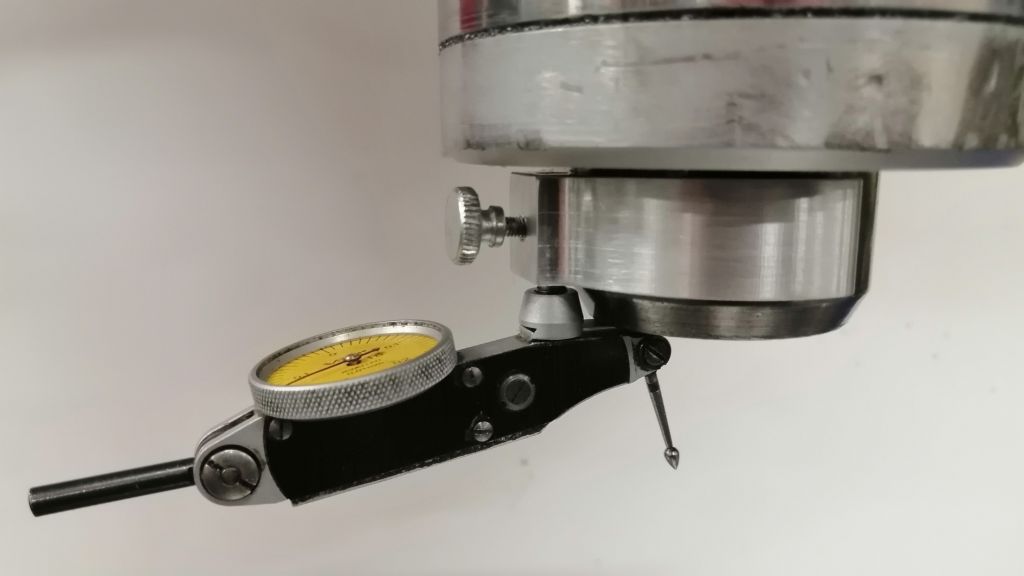

        A quick release dti holder for use with a milling spindle.

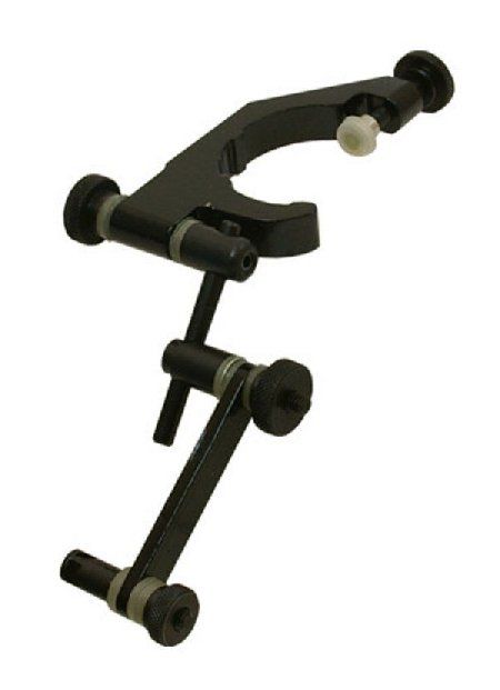

                      Seems quite a nifty idea. Without fully knowing how this particular unit works – but I assume it's magnetic by the way it locks on – wouldn't you get issues with those tiny shards that milling produces sometimes getting stuck to it whenever you put it down on the workbench? I find the buggers get everywhere no matter what!
                      I use a commercial 'Universal' holder that only cost about a tenner and works fine. Just fitting and tightening with the screw only takes a few seconds.

                      #662289
                      Pete Rimmer
                        @peterimmer30576
                        A very handy tool, so long as it doesn't magnetise the spindle. If it does you'll have to be very careful when changing tools not to trap swarf that's stuck to the taper.
                        #662292
                        roy entwistle
                          @royentwistle24699
                          Hope it doesn't magnetise the indicator
                          Roy
                          #662296
                          Greg Webb 1
                            @gregwebb1
                            It is magnetic but quite eqasy to wipe over the magnets. I keep it well above the spindle on the guarding and have no issues with swarf so far. Perhaps because I don't machine too many ferrous jobs on the machine.
                            On the Bridgeport I use a similar type which clicks onto the spindle nose without magnets, this can be done as there are no drive dogs in the way.
                            Both are extremely rigid with no needle flutter when rotating the bezel with the bonus of a low working height.
                            The feature that encouraged me to design the system is that I wanted to keep the dti stylus movement directly towards the spindle centreline and also perpendicular to the bed. This allows the stylus to enter small bores easily without having to set the dti square which can be a pain on other holders. This was achieved by replacing the round dti spigot with a hexagon to keep it aligned at all times.
                            #662297
                            Greg Webb 1
                              @gregwebb1
                              Posted by roy entwistle on 01/10/2023 11:42:47:
                              Roy
                              No it is too far away from the magnets and the holder is Aluminium, although I have always regularly demagnetisd my indicators and edgefinders.

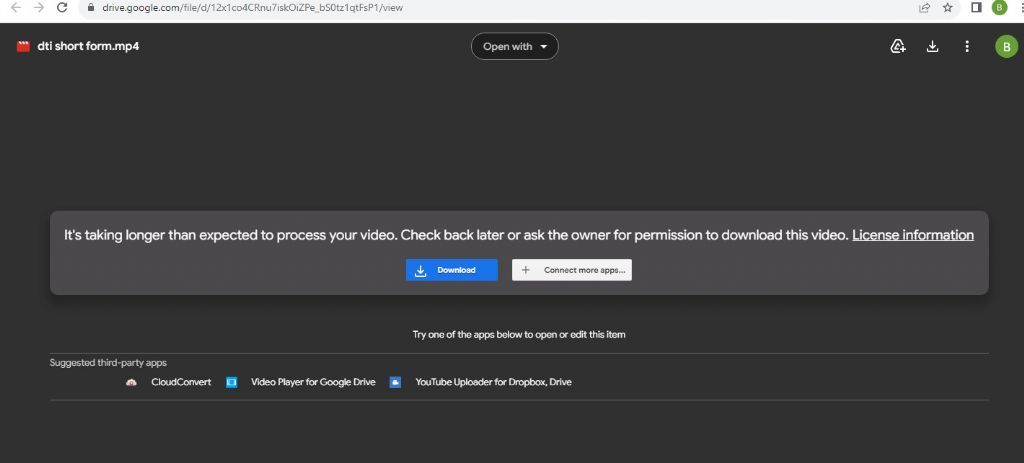

                                  #662647
                                  Benedict White
                                    @benedictwhite51126
                                    Greg, it says the video is unavailable as it is private.

                                        #662660
                                        Benedict White
                                          @benedictwhite51126
                                          Greg, it is asking me to ask you permission to view that file.
                                          Go to YouTube and publish it as a video, that way everyone will be able to see it.
                                          #662662
                                          Greg Webb 1
                                            @gregwebb1
                                            Please try this link, I'm using the embed button. It looks like it is still processing so be patient.
                                            Edited By Greg Webb 1 on 03/10/2023 16:32:22
                                            #662671
                                            Benedict White
                                              @benedictwhite51126
                                              You get this:
                                              Where you uploaded to Drive, open a new tab, go to YouTube and publish there. It will be easier. Also people without Google accounts will be able to see it.
