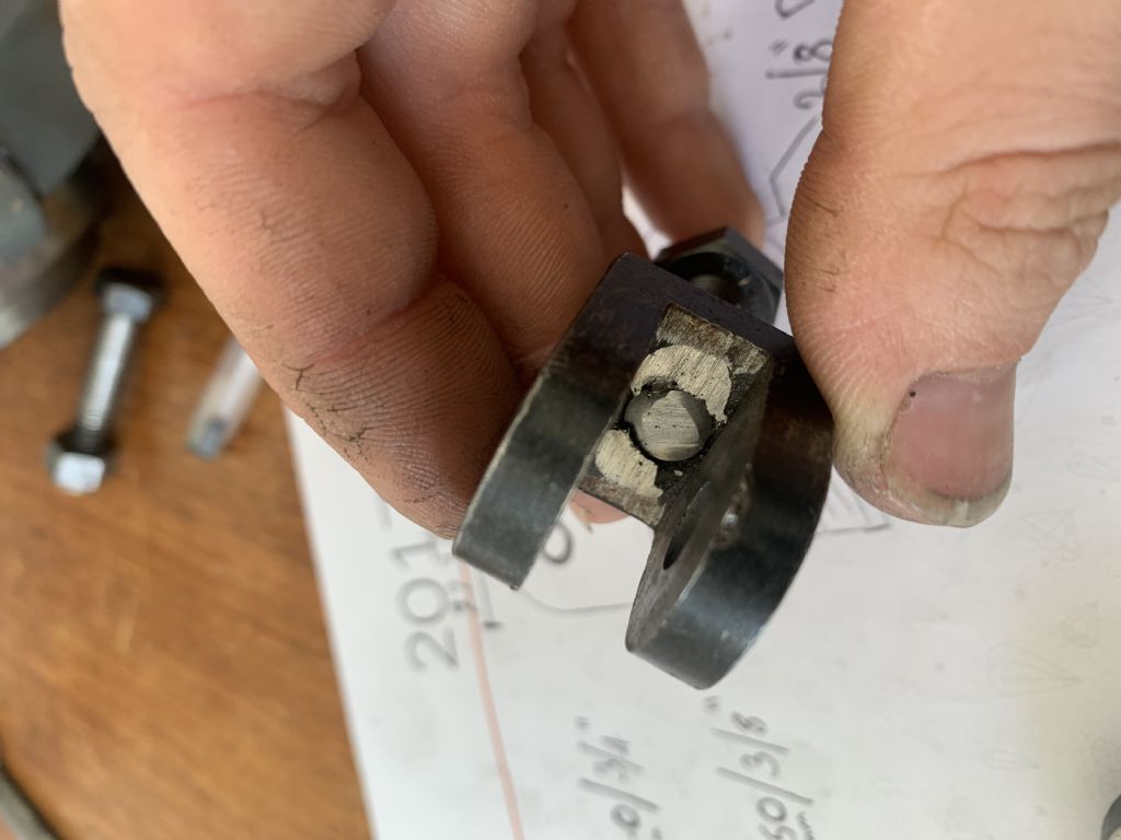

      Hi,
      I recently bought a myford quick release collet chuck for my barely used (complete novice) Myford Super 7. It came with an earlier ML7 attachment which does not fit. Does anyone know where I can by the clevis and bolt, or a similar alternative, which goes through the headstock housing?
      Many thanks in advance.
      Tim

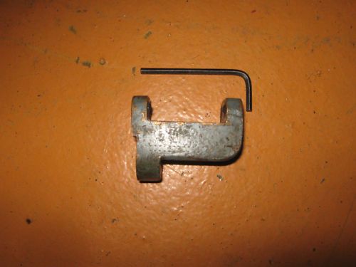

                      When I got a Myford quick release collet chuck for my S7 Mk1 it also came missing the clevis, it's a simple thing to make assuming you have access to a milling machine, if not you could even hacksaw the clevis cutout, no particular accuracy is required, it only works for a few seconds to open or close the collet, the rest of the time it just sits there, for the clevis pin itself I just drop a m6 bolt through the hole.
                      I've got to go out now but if you want I'll try and put up a photo of it later and list some sizes, but I've no idea what you have exactly with the ML7 attachment so no guarantees that what I have would fit yours.

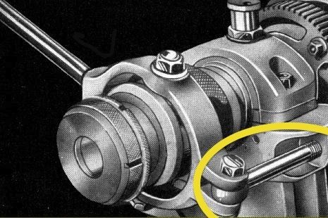

                        Hi there,
                        Are we discussing this?:
                        Item #19 goes through the lugs on item #8 and through the eye on item #18. On early ML7s, the clevis bolt, item #18, screwed into the tapped hole in the clamp bracket, item #22,:
                        There's another picture of this clamp bracket in one of my albums.
                        The clamp bracket attached to the head-stock casting as shown here:
                        The clamp bracket attachment to the head-stock was a bit naff but I guess with care it could be made to work. Later on, Myford modified the head-stock casting to include a tapped hole to take the clevis bolt. (I'm afraid I can't find a picture of that. ) I believe the same tapped hole was/is used to support the chuck guard but it's either/or, not both.
                        Somewhere, I have a dimensioned drawing of the clevis bolt but I can't find it just now – I'll keep looking.
                        My apologies if I haven't used the same names for the parts as thos given in the items list!
                        Best regards,
                        Swarf, Mostly!
                        Edited By Swarf, Mostly! on 05/05/2021 13:42:45

                          The one I made for my S7 is very much like this one in the link, 3rd photo down with it screwed in the headstock.
                          https://www.model-engineer.co.uk/forums/postings.asp?th=129074

                            Hi there, again, all,
                            Both the 'pictorial view' and the air-brush drawing in my earlier post contain errors! The end of the operating lever must be allowed to move relative to the mandrel axis as the lever is operated. There should be a link between item #8 and the clevis bolt. It was/is a short length of flat-bar with a hole in each end.
                            Best regards,
                            Swarf, Mostly!

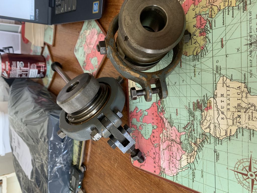

                              Okay, firstly thank you to everyone who replied. I'll take on board all the suggestions. I appreciate it's probably a very easy part to engineer in principle. I don't have access to a milling machine, however I do have a vertical slide. So, correct me if I'm wrong, I should be able to hold a bar of silver steel in the vertical slide, using a milling attachment in the lathe chuck, and mill a recess to form a u-shape or clevis. Then I can drill a hole for the bolt. Apologies, I was suffering from a lack of confidence mainly due to inexperience. I realise this is prohibitive to learning.
                              Sandgrounder, thank you for posting the link to the pictures of the attachment. It's very helpful to see how it was installed. I was concerned about the tension and the leverage required for the chuck to operate effectively.
                              Swarf, mostly, thanks for posting the schematic and other images. Incidentally, mine came with the attaching bracket visible in the second picture (brown background with allen key). I'll have a close look to see if I could engineer it to fit somehow.
                              In summary, I will hit the drawing board and post the results and conclusions. Once again thank you for everyone's input. I'm slightly overwhelmed by the number of people willing to contribute . Legends!!

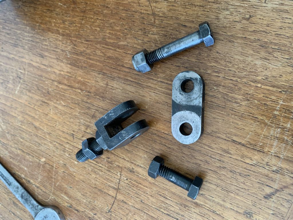

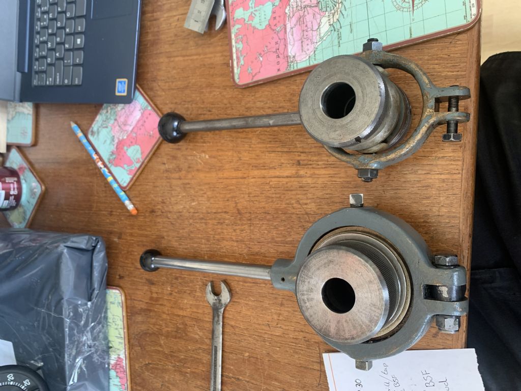

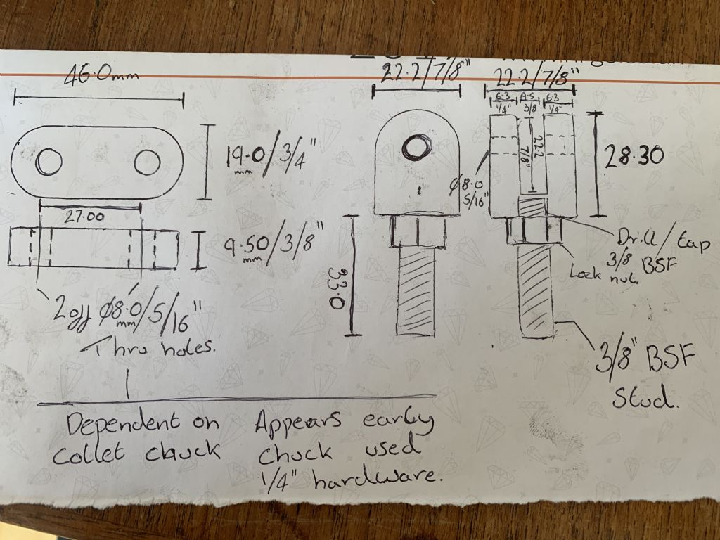

                                      #543682
                                      William S
                                        @williams
                                        Hello
                                        I hope this is of some use: e1b424fe-dd58-4ad5-a170-ee5c8caba503.jpeg
                                        Sorry for the crude sketch, its got all the info I think you should need! Like I said on the drawing the holes may be smaller depending on your generation of chuck as shown bellow there appears to have been at least 2 iterations of it!
                                        Mine appears to have been welded at some point, although I think its just threaded now as I detailed above
                                        Shows the 2 different versions
                                        William

                                            #543985
                                            Lathe-argic
                                              @lathe-argic
                                              Thank you to everyone who is contributing. I feel well eqiuiped now. Will, the drawing you posted is a great form of reference.
