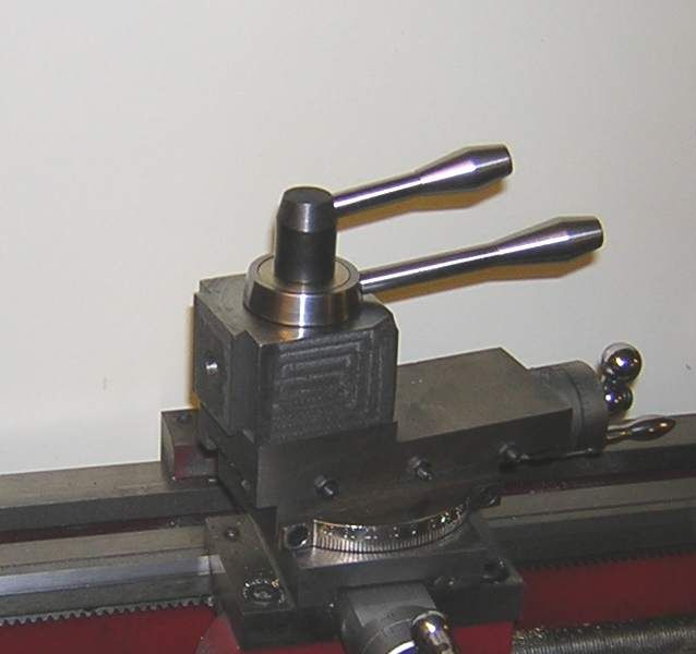

      I've finally got some 2" and 1" square stock to make a QCTP and a stock of toolholders. I want to make good use of my expensive dovetail cutter, so I'll copy the popular design that uses 'pistons' to push the toolholders out away from the block and against the dovetails.
      But.. I have no idea how the pistons are made to work given there is a blooming great stud in the middle of the block.
      Can anyone who has one of these explain/photograph how they work for me?
      Thanks

              Peter E
                @petere
                Hi Neil,
                I am slowly building a QCTP according to the Nakamura design which is of the type you are looking as it sounds. Drawings are here:
                **LINK**
                BR
                /Peter

                Sub Mandrel
                  @submandrel
                  Thyanks Peter,
                  that's exactly what I was looking for, although Chris's comment has got me looking at Dikinson toolposts tyope designs that pull instead of push. But that design wopuldn't let me use my dovetail cutter !

                          Peter E
                            @petere
                            Hi Neil,
                            I have come as far as making the base block for the QCTP, if you want I can take some measurements on mine tomorrow. It is adapted and made for a SIEG C3 mini lathe. This is how it looked before getting som color.
                            QC Tool Post
                            BR
                            /Peter

                                      Peter E
                                        @petere
                                        Adding Model Engineers Workshop no 140 to the list of info and drawings for a QCTP of the sought after style. Jim W made one for a mini lathe-ish size as well as for a Unimat sized machine. Good descriptions and drawings. I used those as base for my work.
                                        I have understood it so that it is important to be quite accurate when doing the dove tailing to get the desired precision and repeatability while at the same time get the easy fit required for easy use.
                                        For my Unimat clone I made a slimmed down version of the Norman Patent type as can be seen in the following two pictures. They also work very well, and I am very pleased with their perfomance. The only draw-back I think is that the setting screw poking out below makes it a little cumbersome to efficiently store many toolholders.
                                        BR
                                        /Peter
