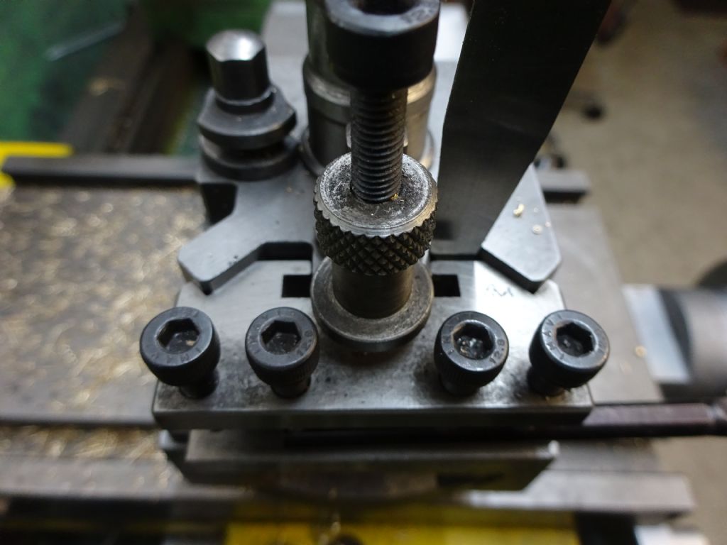

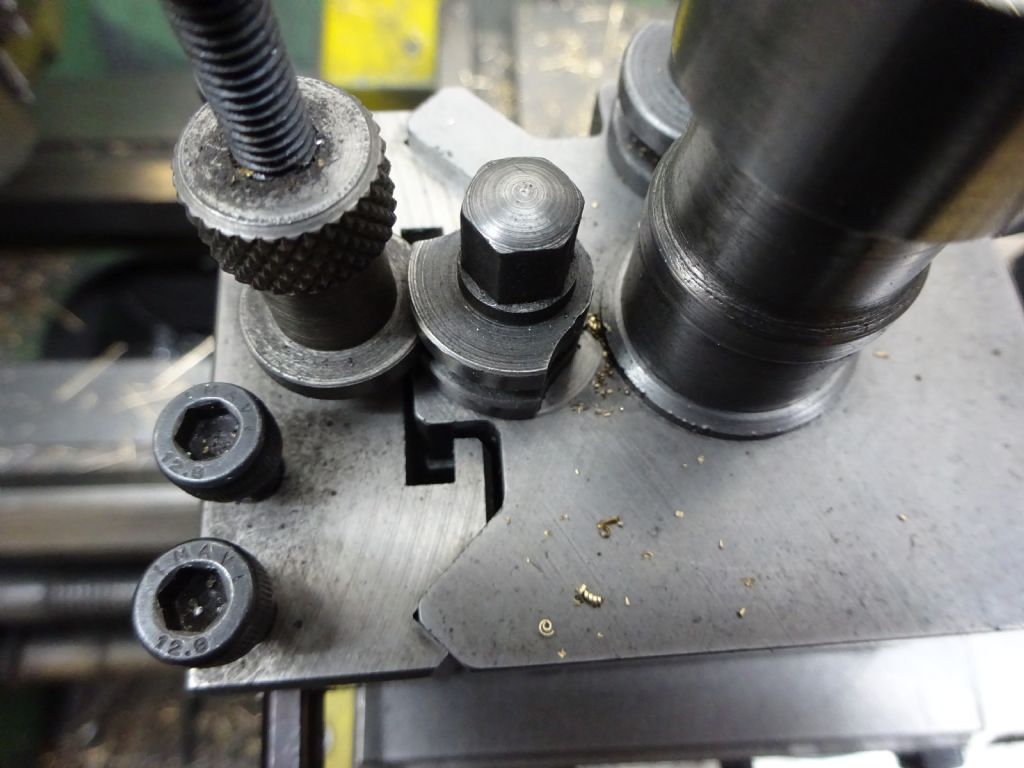

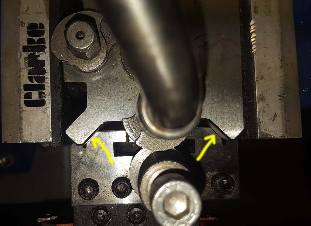

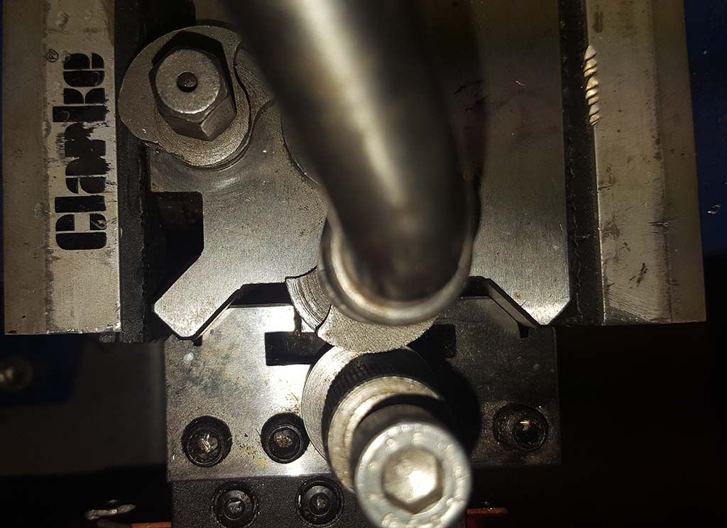

      I have found two issues when trying to fit some of the imported holders to my original post and both stop theholder locking firmly to the post.
      The first is the easiest to cure. The holder should only be making contact with the two "V" sections at the end of the holder and there should be a gap where the "tee slot" is drawn in towards the post, in the photo you can see a 0.015" feeler gauge in there.
      On some holders the holder makes contact where the feeler gauge is before the ends do so the holder will wobble about. Easy remedy is to hold these surfaces against a linisher or belt sander to thin them enough that they no longer make contact first.
      The other problem is that the inside edge of teh "tee slot" is too far from the post which prevents the cam actuated clamp from rotating far enough to get it into the sweet spot where it holds firm. This photo shows how far the clamp rotates on an original holder
      And this how far on a thick one, probably 50-60 degrees less
      This shows where the problem is, original holder 0.127" and import 0.142"
      Not such an easy fix and it will depend on how hard your particular holders are, ideally a carbide ciutter but at a pinch a sacrificial HSS one can be used to get under the tee to thin it down.
      Edited By JasonB on 13/10/2018 20:20:54

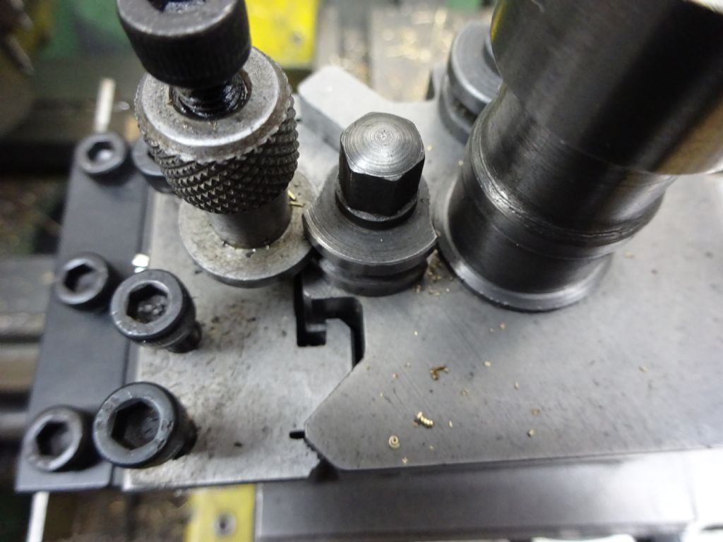

      #375820
      blowlamp
        @blowlamp
        The tool holder in the video looks like it's set in its very lowest position, causing the 'piston' to bear on the upper end of the tee slot. Is this causing the problem?
        Maybe a shorter body block would bring things into line better.
        #375821
        petro1head
          @petro1head

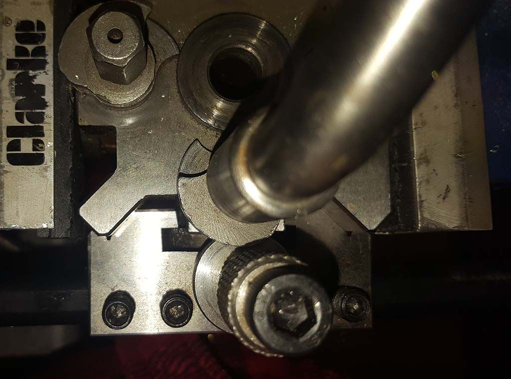

          Interesting, while you doing that I had a check and compared two holder and found this
          The top photo is the parting off tool holder, the second is the boring bar holder.
          So it looks very similar to what your saying and would explain why I have been having parting problems as the parting holder is not being properly clamped.
          So i need to study you photos and do some measuring and machining
          Thanks Jason
          #375830
          petro1head
            @petro1head
            I believe the problem is where I have arrowed in yellow is wider. I have 6 tool holder and two are wrong. I remember buying an extra two after getting the initial tool post
            #375836

              #375853
                The yellow marked problem won't be an easy fix.
                I think for now use the good holders, new parting blade and insert to get your mate's job done then decide which way to go eg complete new post set or a couple of holders to replace the dodgy ones rather than rush into buying another toolpost.
                #375862
                petro1head
                  @petro1head

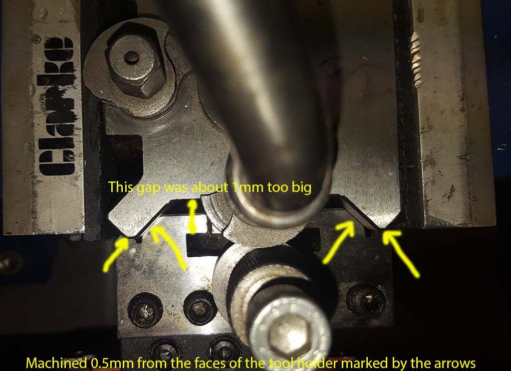

                  Fixed, machined 0.5mm off the edges where the arrows are the the some on the other edges 90 Deg to the marks, if that makes sense

                      Posted by petro1head on 14/10/2018 08:38:26:
                      Edited By petro1head on 14/10/2018 08:40:08
                      Hi petro1head,
                      I make my own toolholders. The critical dimensions when making this style of holder are the distance between the vees, depth of the 90 degree vee and its relationship to the underside of the tee slot. It is this relationship that controls how far the locking cam rotates.
                      Looking at your picture of the parting toolholder the cam hasn't been locking.
                      So your fix makes perfect sense.

                                    Can you show us what you've done to the toolpost, as I'm not at all sure what the problem was and what was done to fix it?

                                    #376035
                                    petro1head
                                      @petro1head
                                      The problem was the tool holder was not tightening properly and this was due the tool holder not sitting close enough to the tool post piston
                                      To clarify the tool holder was machined NOT the tool post
                                      Edited By petro1head on 15/10/2018 12:07:41

                                          So how did you machine the faulty toolholder? With an endmill, or do you have access to a surface grinder?
                                          Have been following the thread with interest as my parting tool holder suffers from the same problem, so I'll be looking to do the same (obviously once I've checked measurements, etc.).
                                          Regards Tom
                                          #376056
                                          petro1head
                                            @petro1head
                                            Just used an end mill
