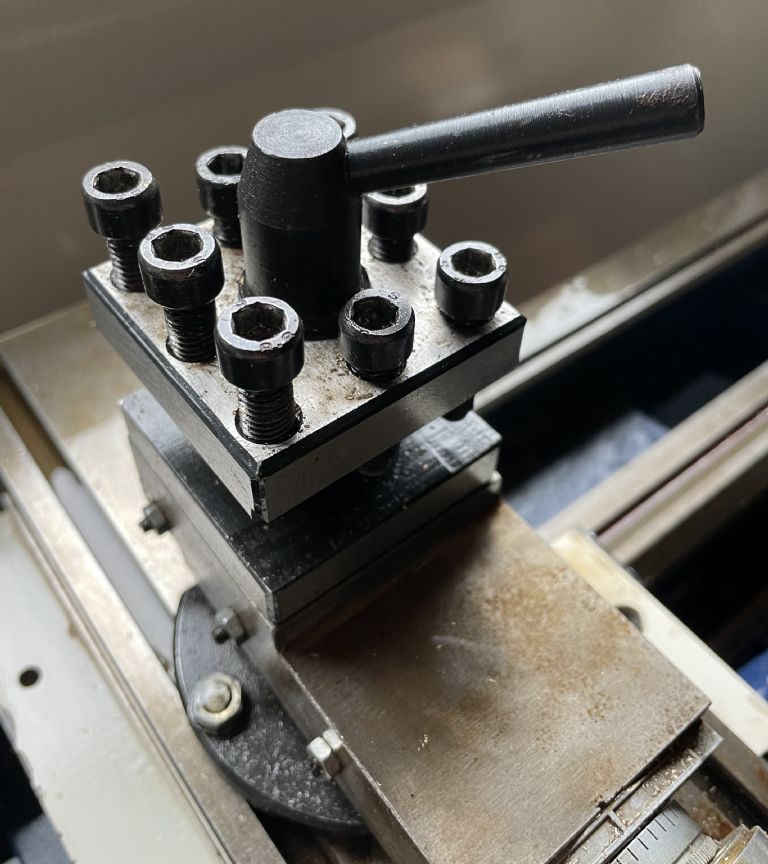

      Hello gentlemen,
      I am considering converting my lathe tool post to one of the quick-change types. There are plenty on ebay of the cheap Chinese type – I wonder, has anyone had any experience with them? Are they any good? Do they last longer than a lettuce? 😊 I’d love a Myford or similar but can’t afford such luxuries at the moment.
      Ball cutting: I’d like to make a simple ball cutter and wondered if anyone had done this using a boring head? Mr Ade Swash made a lovely example (on YouTube) but I don’t have his range of skills or milling machine – so mine would need to be fairly simply made.
      Any suggestions or advice most welcome.
      Thank you

                Hello gents,
                Thanks for the replies. Ches, you are welcome, Mr Swash has some great content – I have learned a lot from watching his channel.
                The lathe is a Chinese type from Amadeal (Dad bought it about 12 years ago). It hasn't had a great deal of use.
                This is the tool post currently fitted (see pic). I'd like to upgrade because setting up the tool each time and turning down the allen keys gets very tiring and time consuming.
                Is a piston-type or wedge-type a better option?
                Thanks all
                Margaret

                  Rigidity is always a potential problem with QCTP on a small lathe – extra points and overhang to contend with.
                  Arceuro is my go-to supplier of all things for lathe/mill. They get most of my trade.
                  Another option is to make an identical 4-way toolpost and swap as necessary. OK, I never had more than three cutters installed, but a home-made copy could be cheap and reasonably effective as an alternative.

                    QC toolposts may seem a great idea, but like most things they can have a few drawbacks.
                    In reality – how often do you change tools in a session and is it really so time consuming – I assume you're not in a manufacturing environment on piece work? One issue you will find is that the QC toolpost gives more overhang from the mounting on the cross slide / compound – this results in less rigidity which can lead to a poorer surface finish on work. Depending on the type that you get you may find an issue with the tool centre height not being as consistent as you might believe due to the way these holders seat. I regularly find myself re checking the CH of mine.
                    Should you try parting-off using one you may find a disaster in the offing (again due to the lack of rigidity)
                    Its all down to personal choice of course, but with a pretty light lathe like yours you may find the rigidity issue one to think about.

                      I use a QCTP on both of my lathes but have also used four-way tool-posts like that.
                      I don't find the four-way tool-post significantly less convenient for setting than the QC type. A bit slower as you still need set each tool to height but now using shims. You still have lots of screws to tighten.
                      Most turning operations don't need more than 4 tools anyway: although using a QCTP means you can build up a set of more than four ready-installed tools. One of mine holds the knurling tool, another a screw-cutting tool.
                      If set appropriately an indexing 4-way post is marginally quicker to operate than a QCTP, especially for repetition work, but there is not much in it. (A capstan lathe is one with souped-up, 6-way versions of indexing toolposts.)
                      Some users of 4-WTPs and plain top-slides, keep a set of appropriate shims with each tool, especially if using insert tools whose own geometry is constant.
                      Their drawbacks are the tools not in immediate use are sharp pointy things happy to bite your hand, and occasionally, the projecting tools are in the way of the tailstock or chuck.
                      The other main disadvantage of a plain 4-way toolpost without indexing, compared to a drop-in type QCTP, is that you need use a straight-edge or square to align each turn to the slide for repeatability. It should not be too difficult to make some form of indexer for it, though.
                      Otherwise really, there is not much to choose between the two systems.
                      I am not familiar with Amadeal lathes but the photograph suggests yours will take a rear tool-post usually dedicated to holding the parting-tool; and you may find that more useful than changing the tool-post.

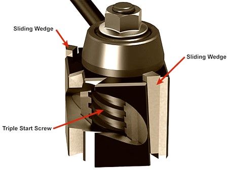

                                There are 2 types of the budget tool posts.
                                One uses a button which is pushed out by a cam and the other uses a screw to raise and lower a wedge.

                                      I fitted a wedge type QCTP to my WM250 and find it a useful addition. Can still use the 4-way original post as well so have both options covered. Don't find any particular rigidity problems and if necessary can also do away with the top-slide and just fit the toolpost directly to the cross-slide.
                                      You can see what I did here – Cross-slide toolpost and here top-slide toolpost for the WM250.
