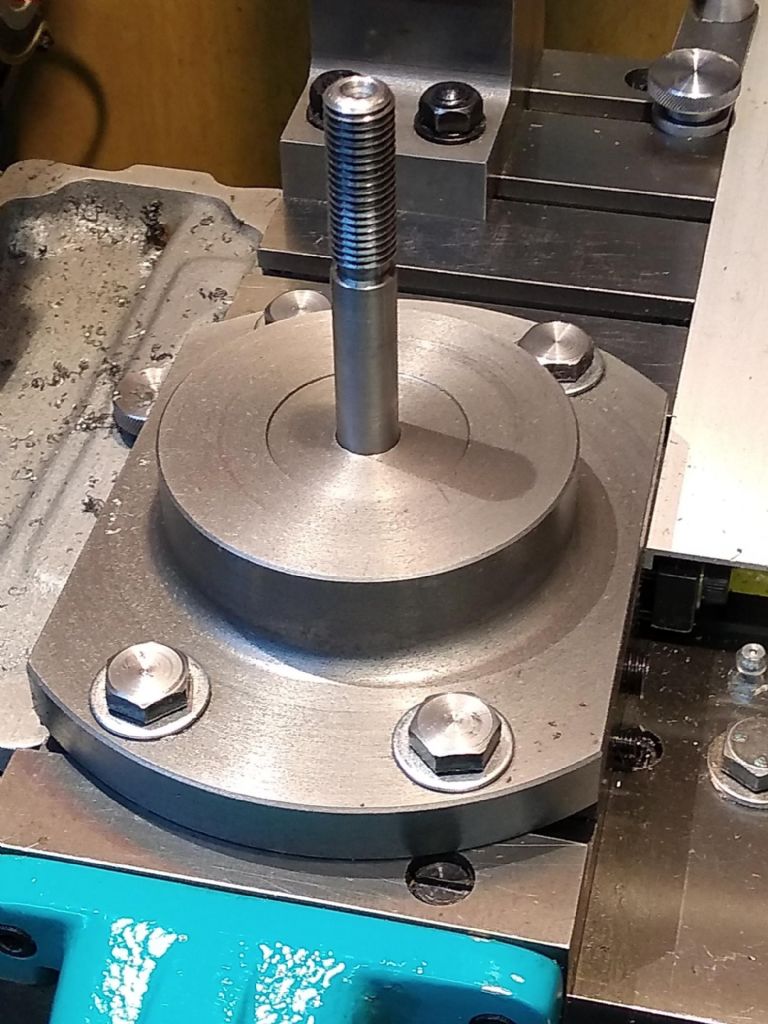

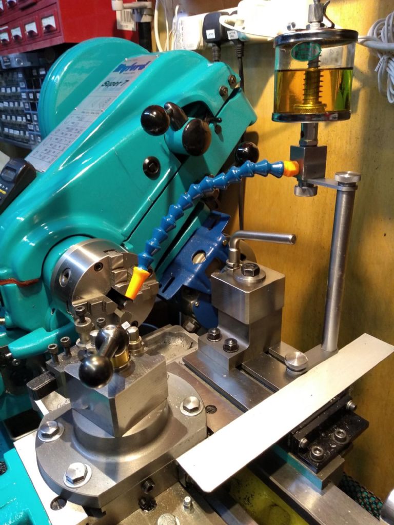

                      This is my version of an alternative QCTP base. The excellent idea of using a 5” chuck backplate casting was one I first saw on this forum; I don’t claim any originality for it. It was an easy turning job.
                      Since it is only ever intended to be used with the QCTP, I turned a shallow recess of 35mm diameter to avoid the tendency for the toolpost to shift. It needs much less force on the ball handle now to lock the toolpost firmly in position. I made the base 1/8” lower than the compound so I can use ½” tools if I want.
                      The improvement in rigidity is marked. That, plus the coolant drip feeder, mean I can now part off confidently using the power cross feed. It achieves the full potential of the big-bore headstock which I felt it lacked before.

                        Andrew – Like the idea of your coolant drip feeder. How controllable is the flow?

                            The 200ml drip feeder was cheap on ebay but I had to true up the needle point before it would completely cut off the supply. After that, I found the flow easily controllable by observing the drip rate through the little window. I tried cheap Chinese coolant hose but it leaked at the joints so I replaced it with good-quality Loc-line hose made in the USA. The hose holds quite a bit of the oil in its joints so the response to the drip rate can be delayed which is a slight nuisance. At some point, I might replace it by plain clear aquarium hose with a bendy wire down the middle. Apart from those hiccups, I’m well pleased. I can position the drip feeder anywhere within a 100mm radius circle, swing it in towards the tool or out of the way when not needed.
