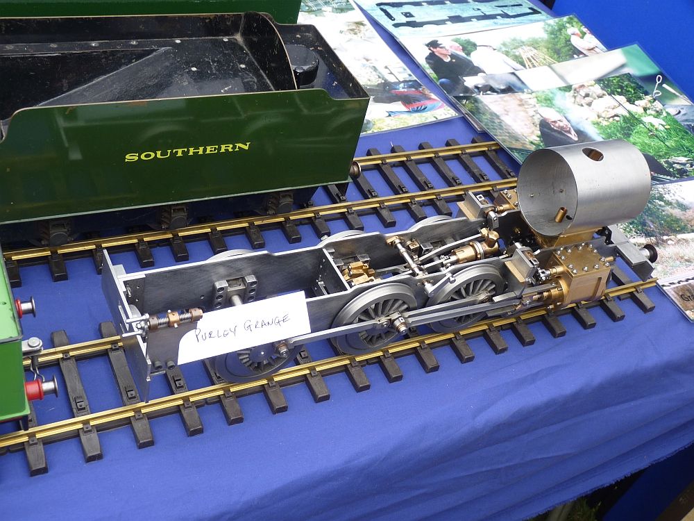

              Hi Ray,
              Ok will pm you.
              Just to wet your appetite, here's a photo of a very nice chassis being built by David Williams taken last Sunday at our 40th Anniversary Rally at Cheltenham.

                  Since starting this thread i have progressed somewhat, the main frames incl. axle guides, as in pinture from John, Bogie complete, axle punp, regulator and a few other small bits and pieces.
                  I would still be interested in hearing from anyone who has built the PG from LBSC or in any parts for sale, incl. built or part built PG's.
