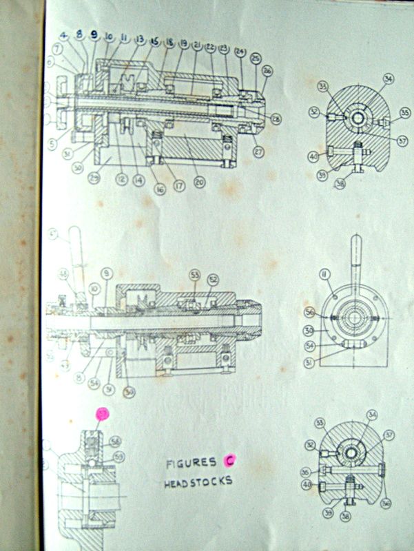

      I didn't know that the internals on these varied. I am wondering if anyone has the words to go with the numbered parts of the top headstock arrangement show in this. The manuals I have seen only show the lower one that uses a thrust race rather than the sleeve round the spindle.
      I have a photocopy of this page and it refers to the top one as the plain headstock and the lower one as the lever headstock. While I can manage it would be nice to have the words that should be in the manual referring to all of those numbers. The manuals I have seen do refer to all of the numbers on the lever headstock and include dismantling and setting instructions. One thing I find odd about the sleeved one is that the sleeve which forms the thrust bearing doesn't want to move which would make removal of the spindle rather difficult. Some trick may be needed to free it.

          Hi, while I do not have the words to go with your image, I do have dismantled headstock in front of me. The sleeve only comes off the shaft in one direction – towards the rear.It is a snug fit, and has a key. To remove shaft, take off the drive pulley and key,then undo rear nut of the front bearing (it will clear the thrust collar) and slide out the shaft complete with collar and front bearing (slacken rear bearing first) The collar can then slide off rearwards. Hope this helps. Dave

            Thanks Dave. It's more reassuring really that it should come off in that direction.
            I had slackened off the rear nut, pushed the spindle forwards to create clearance between the sleeve and the rear bearing and expected to be able to push the sleeve back along the spindle. It's stuck and wont move at all with finger pressure so I wondered if something else had to be done. Sounds like it just needs a bit of forces to free it.

              I bought some braided oil lamp wick material on ebay when I did mine, I warn you its a right pain of a job to get it installed correctly.
              I have some better drawings if you want a copy let me have a PM with your e-mail address.
