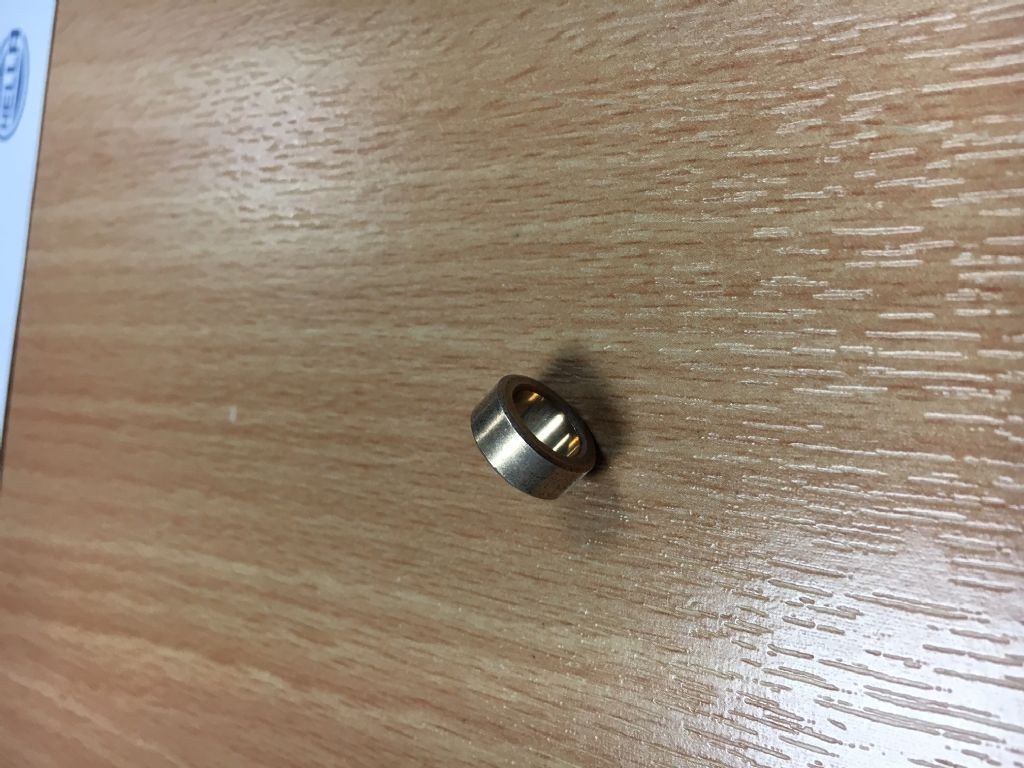

              I don't think the bushes are olite, they appear to be simple plain bearings of what looks like brass or bronze, certainly not got the honey comb appearance of an olite bush. Anyway, too late, I have drilled through them! A good job I had it apart and cleared out the grease in the bearings! Otherwise I would never have spotted the cock up!
              Thanks for the link Keith. I did try Googling, but nowhere could I find the definition of size for a pulley! I must have waded through a lot of sites which simply repeated the fact it wasn't OD or base diameter. Very frustrating!
                              Not sure about the honeycomb bit. Porous bushes are generally quite shiny with a very slightly mottled colour. They are formed by sintering under enormous pressure, resulting in them taking up the polished finish of the die they are formed in.
                              I wouldn't be surprised if you have drilled a hole in a sintered bush but probably no real harm done in this case. Having said that, if I'm correct, you may find the oil now dribbles out of the bearing rather than permeating the bush itself.

                                    Muzzer that is quite a shock. All the olite bushes I have ever seen have been quite obviously porous, when you examine the ends of the bush. You don't need a magnifying glass to see that! If what you say is correct (no doubt you are right!), then what on earth have I been looking at all these years thinking they were olite bushes?
                                    A puzzled,
                                    Andrew.
