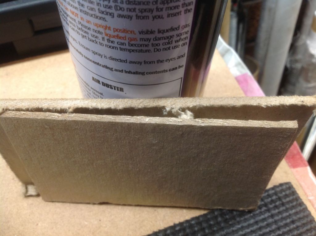

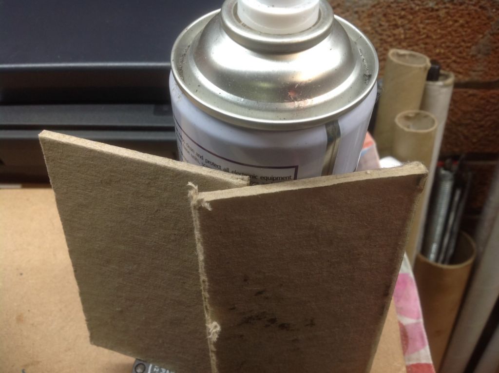

              #573933
              Bill Phinn
                @billphinn90025
                Of the two pieces of 3mm board in the images below one was cut with a (fine-toothed) mitre saw and the other with a cast iron board chopper.
                The pieces in the image showing short edges were cut with the grain, and the right hand piece was the one cut with the mitre saw. The image with long edges shows against-the-grain cuts, and the furry-edged board in contact with the aerosol is the one cut with the mitre saw. The same furry edge can be seen from a different angle in the with-the-grain image.
                The best cutting tool for binding boards in my experience is a powered guillotine, though a cast iron board chopper comes a reasonably close second.
