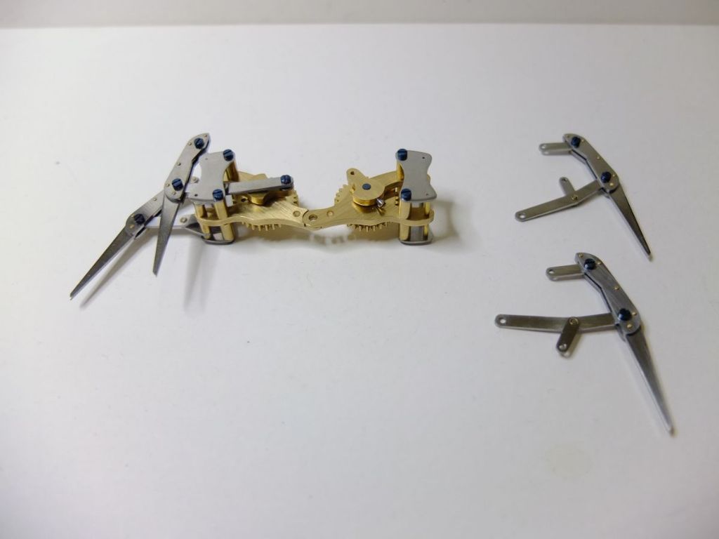

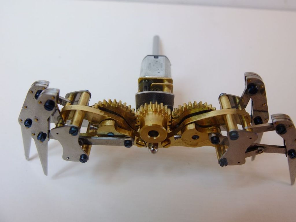

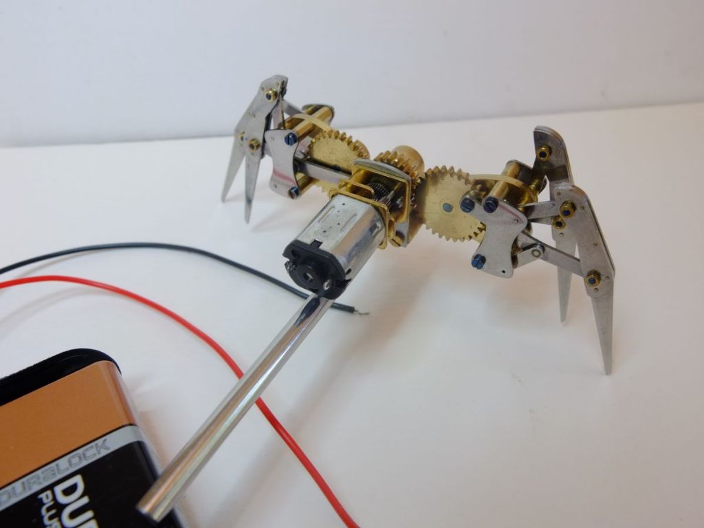

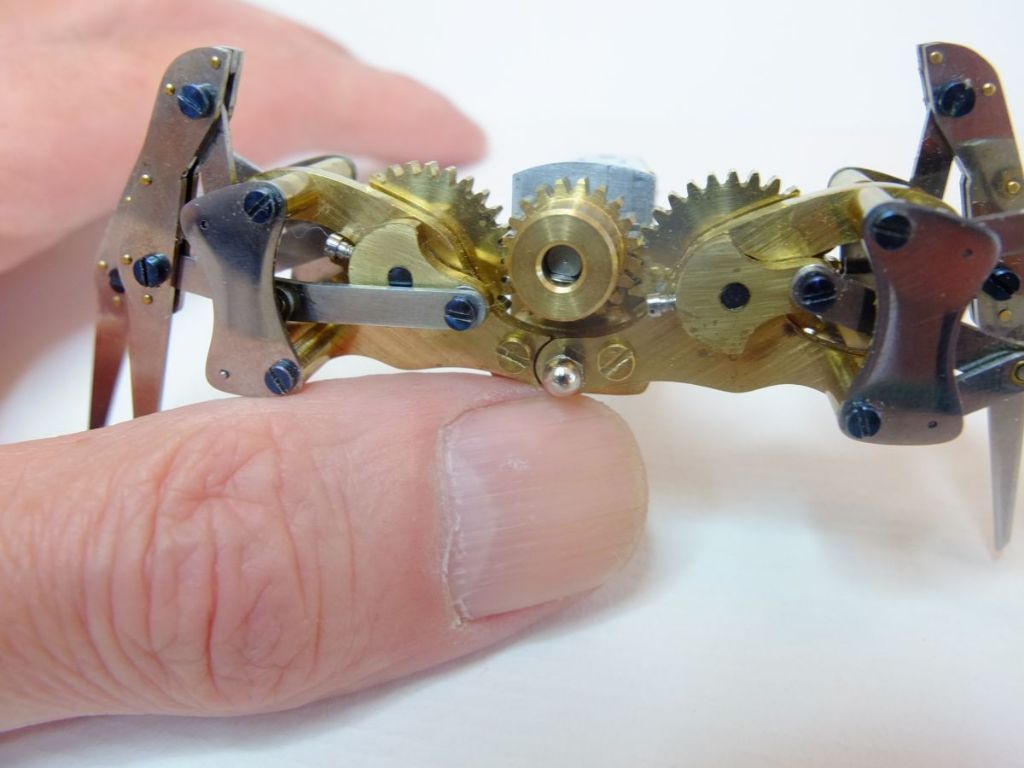

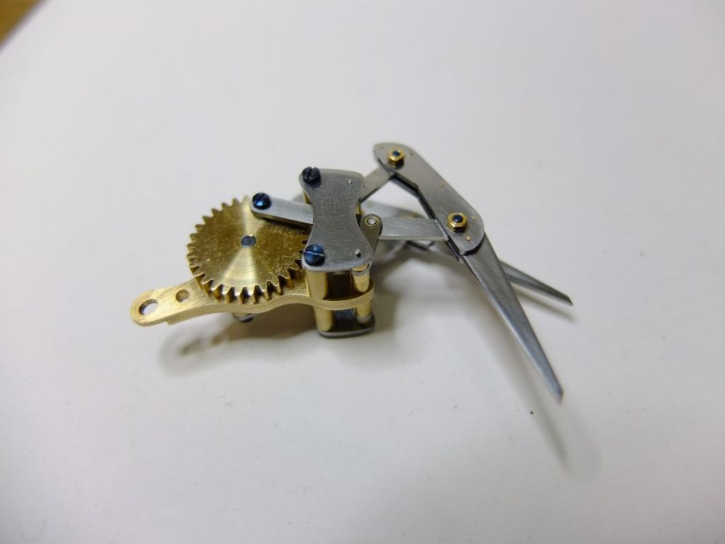

      Hi all,
      I've made a prototype walking mechanism. This is half a mechanical crab – an identical assembly and motor needs to go on the other end of its steel "spine".
      It's based on the "Klann Linkage" (google it). You can find a few made examples on the net, mostly a lot larger than this.
      I originally made this to quite a high finish – months of testing and handling has left its mark.
      It works a treat. It was designed to cover its own length (100mm) in one second but with a 300rpm motor, it happily scuttles along at 150mm per second all day.
      The main plates and the crank are made form 2mm engravers brass and the legs and linkages from 1/32" gauge plate hardened and tempered. The bridge plates are made from annealed 0.4mm Stanley blade then hardened, tempered and polished.
      The crankshaft is 2mm silver steel running in miniature ball race bearings and there are brass bushes in all linkages.
      I can't cut my own gears (yet) so they are bought in 0.5 mod brass gears.
      All in all, there are 185 parts in this assembly and obviously the same again for the other side.
      I've finished testing and I'm going to start on 2 complete crabs with a few modifications to improve on the prototype.

          Excellent project, Steve yes
          Nice to see it done small.

            Beautifully made Steve . Can we see it in action please.

                Beautiful Steve….!
                Its Art…better than any Picasso.

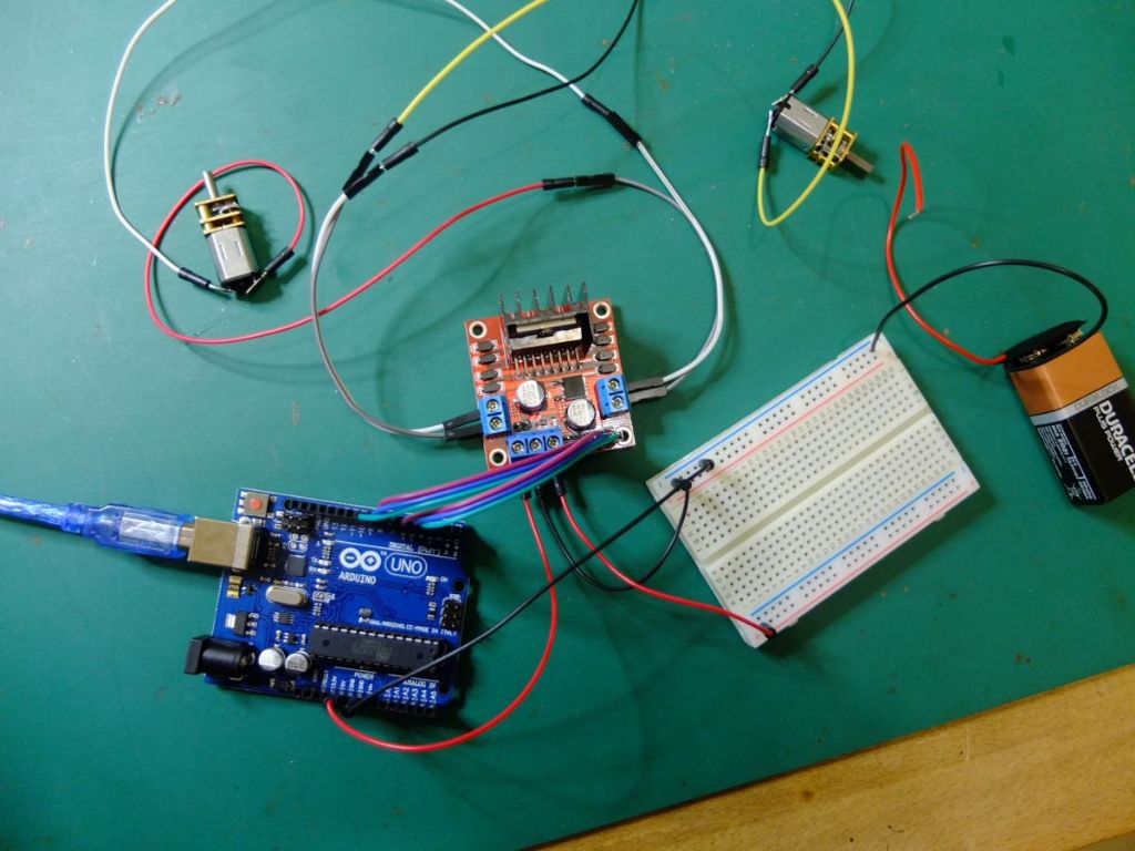

                  I did most of the testing using this Arduino and bridge setup.
                  I suppose I'll use something smaller on the finished item (which will be self contained).
                  I originally wanted to make this clockwork and only got the motors to test the mechanism!
                  I would love to post a video but my phone is an ancient Nokia with no camera.

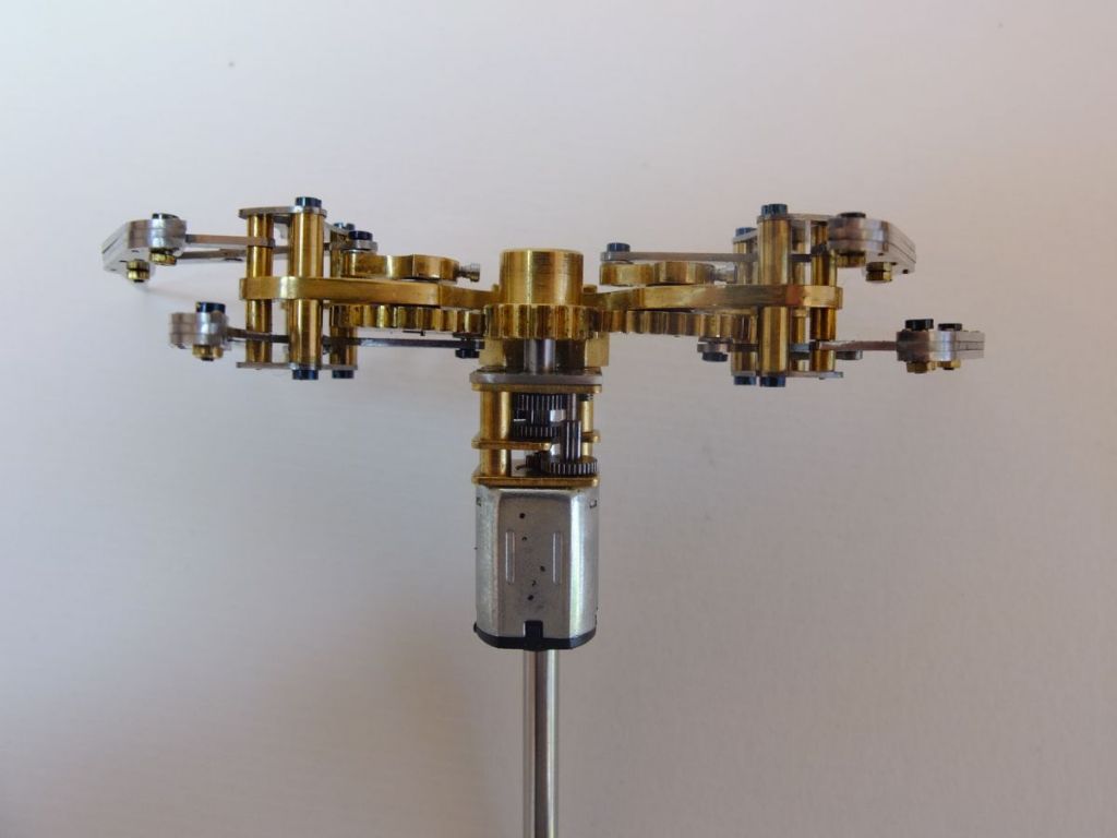

                      Here's a couple more pictures of it under construction.
