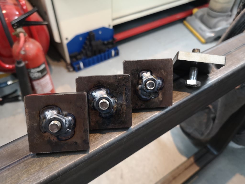

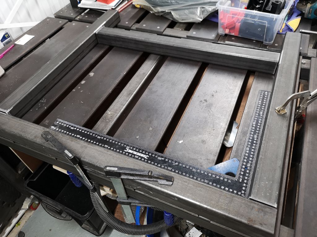

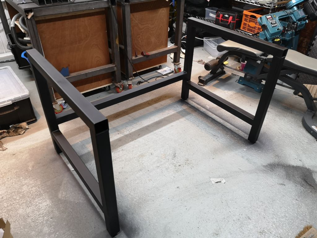

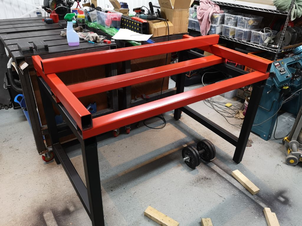

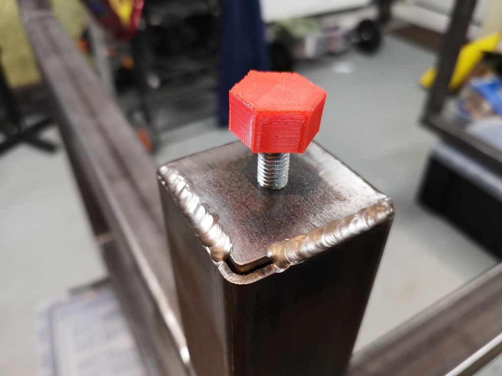

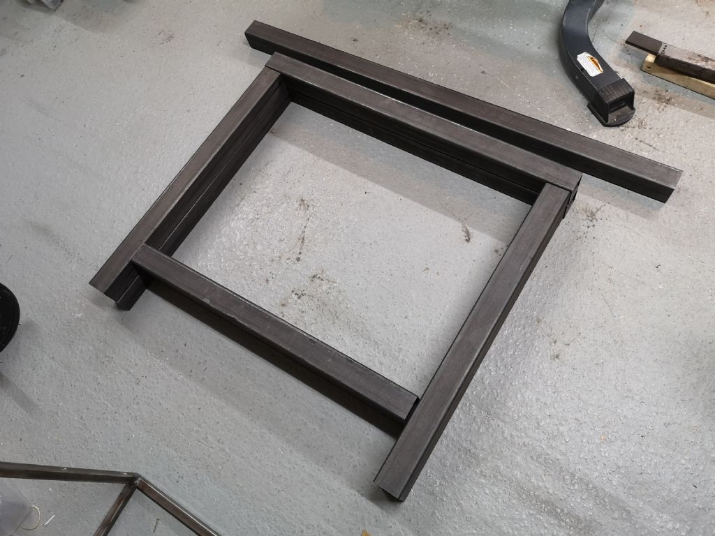

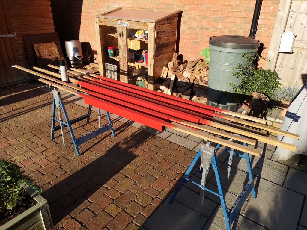

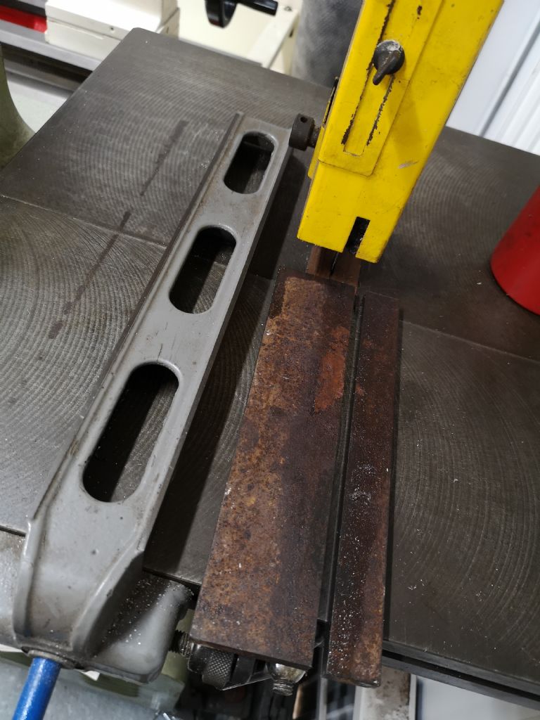

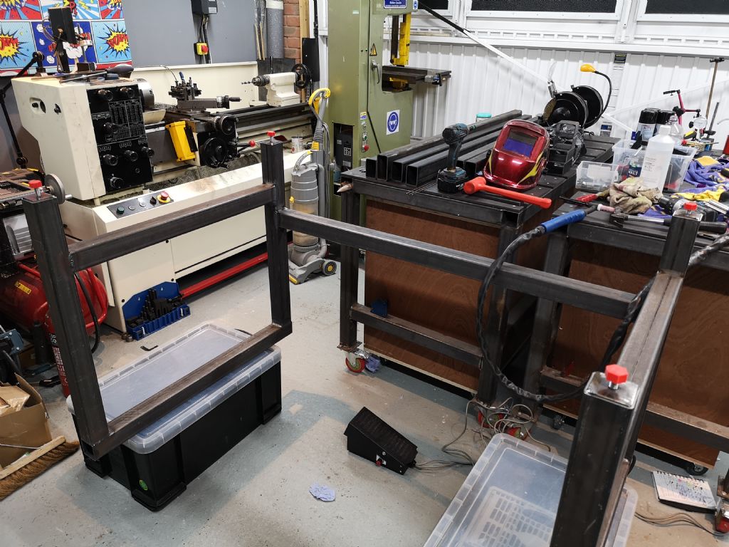

          Building the table
          Cutting box section:
          Tigging up:
          Adjustable feet:
          3D printed pads, to save the floor:
          Fini:
          Cutting steel for the router frame next.

          #503487
          Steviegtr
            @steviegtr
            What would we do without box section. Nice to see you are using the Tig set.
            Steve.

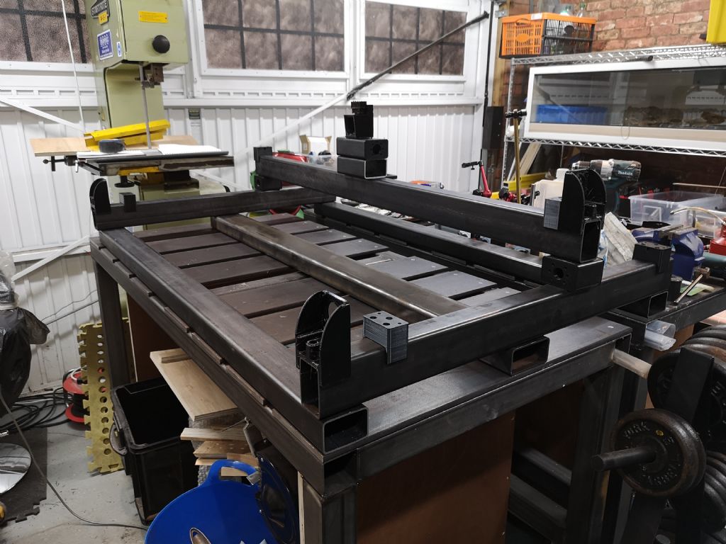

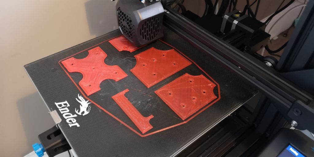

              3D printing the hole marking templates:
              Mocking up the moving parts complete with 3D printed accoutrements (motor/ball-screw mounts, faceplates):
              Pretty …
              Can't wait to see this thing in action – it's going to be a beast:

              #508943
              John_R
                @john_r
                Looking good so far. I’m on the same path, the parts for the “standard” size are in transit from China. I chose the full package with spindle etc.
                A friend has a large quantity of box section so I am waiting to get that, to double check dimensions before I start printing anything.
                I haven’t totally decided on the frame or surface upon which the finished machine will reside, so I will admit to the feeling of a lack of progress.
